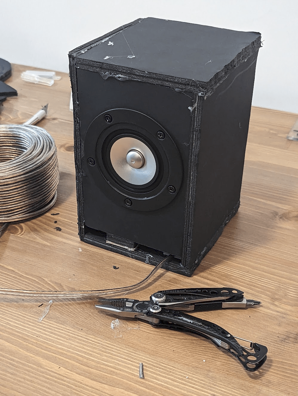

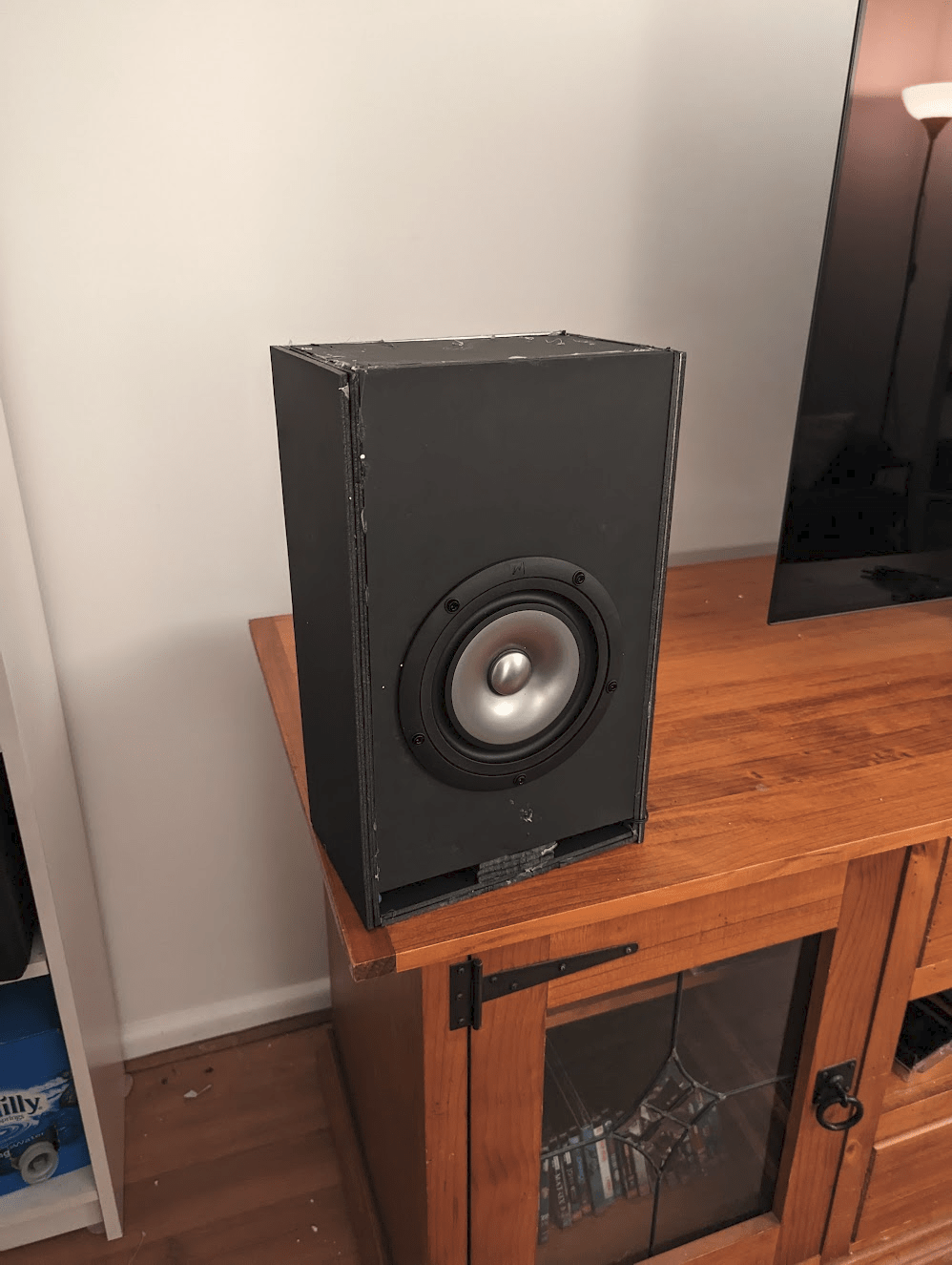

It looks better without the painter's tape 🙂 That was just there initially to hold the panels together while I hot-glued everything.Nice work! That looks sweet. Does it get loud but stays clean? I would cross closer to 700Hz.
It definitely 'sounds' loud. I was playing them in our basement, and I thought I'd cranked them up quite a bit, but when I went back upstairs and apologised to my wife she said she didn't hear anything! It might take a little while to get used to the accuracy of the planar drivers, but I didn't notice any artefacts from them at all (though I could certainly pick out more in the recordings I was listening to than I have before!).

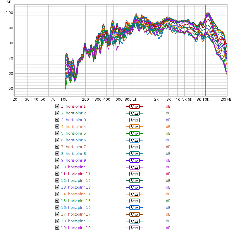

Hmm, 700Hz - what kind of enclosure would you recommend for reaching that? I noticed that on Joseph's thread where he analyses the frequency response of the planar driver that 300Hz appears to be usable - I assume because of how the panel moves. Is a higher crossover required more because of the horn?

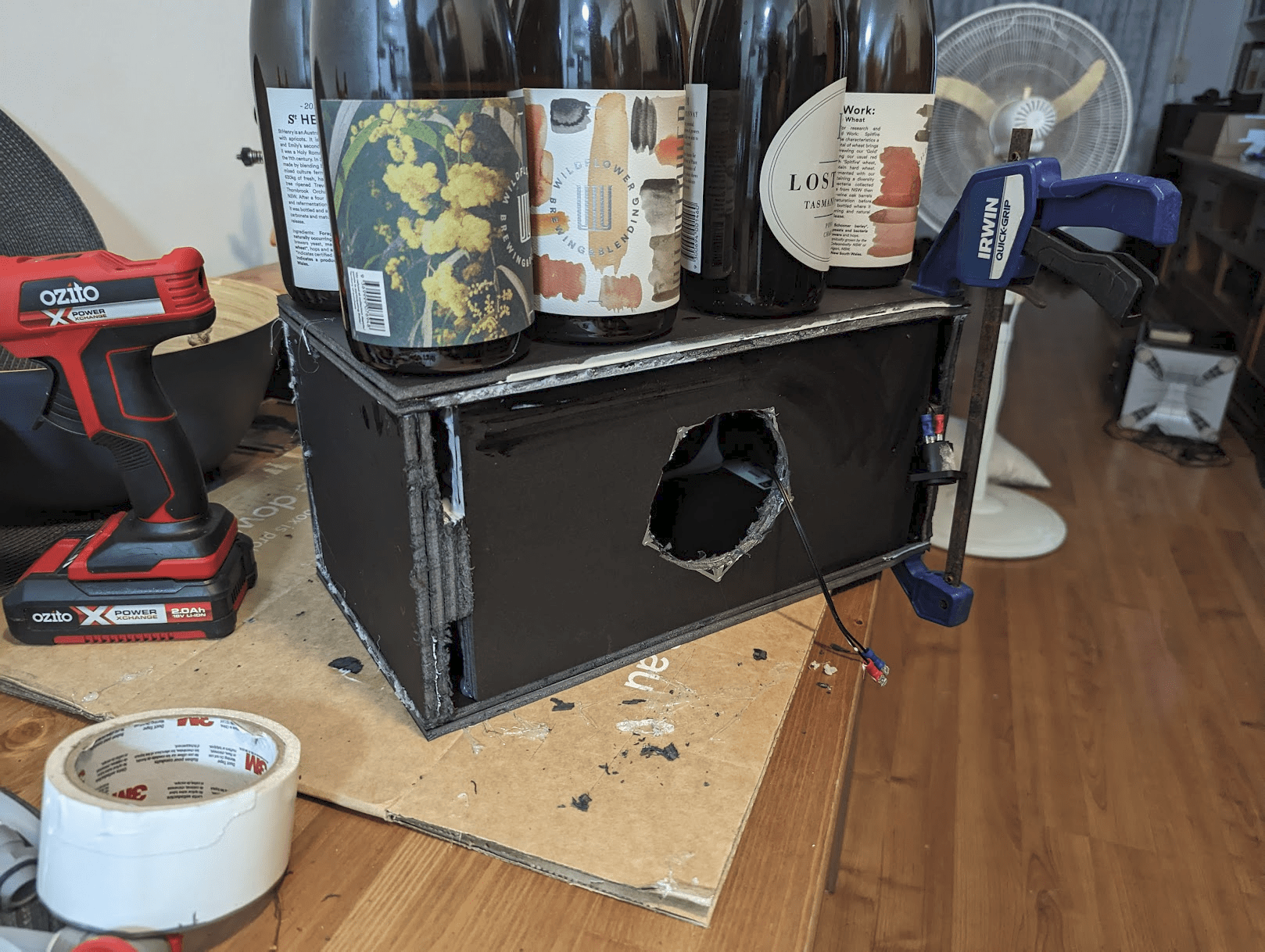

I started building a midbass box for the Eminence Alpha 8as I have out of XPS foam, but the adhesive didn't work so well (I chose the wrong glue), so I'll build those out of wood - which I've been meaning to do for years anyway 🙂 I'll report back!Just put these above a 12in front facing PA woofer to get 700Hz XO.

I'm waiting on a measurement mic to arrive, so when it does I'll post the response graph of the horns I've made 🙂
