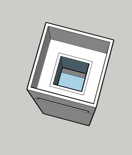

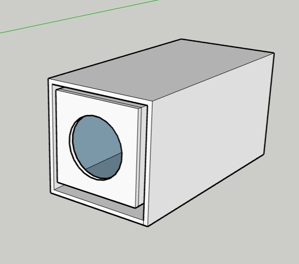

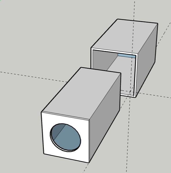

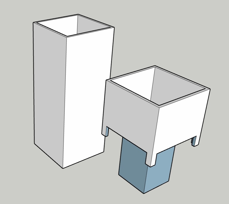

Would you care to look at these drawings? Being playing with left over cardboard. Maybe would work well with foam core. It is one box inside another, one that goes in smaller than the other, held in such a way, so there would be a surround reflex vent around the smaller box. The drawings are sketches, not to scale, just the idea.
The rear of the outer box appears to be open. Is this intended? How about the inner box, open or closed rear?
The rear of the outer box is closed, the rear of the inner box is open. There should be some ribs between them to keep the vent intact. Not shown in the drawings. The boxes doesn't have to be long, can be fat and short. 🙂

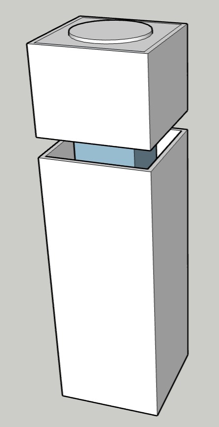

Yes, that can work and it has the advantage of using the narrow cross section wall flow friction vs regular port constriction cross section alone to effect pressure drop. This will be different than equivalent cross section of a tube alone as port. Similar to an Onken type reflex box but those have two walls with slot ports. Yours is a 4 wall Onken. A square baffle will result in more diffraction anomalies (dips and peaks due to constructive and destructive interference). A rectangular box is better.

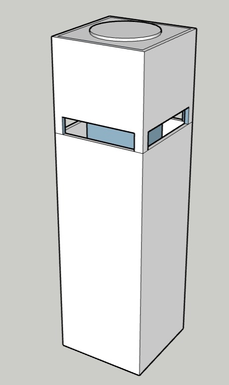

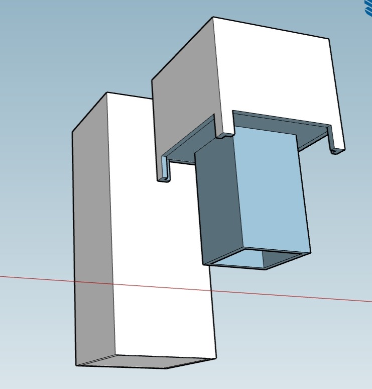

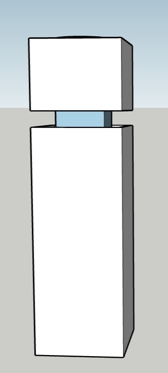

This is more or less the idea, for the vents to come up most of the way, and go out from all 4 sides, that is, if we build a square, tall speaker box. The driver will be up firing.
You actually have something closer to a back loaded horn than a reflex box. Totally different simulation. If going horn route, the low frequency depends on length. For 60Hz reach thats 112in long or 56in of folded in half. You could do 4 concentric squares and get 28in long speaker.
Whatever the name we give to this, the sound from the back of the audio driver would hit the back wall/bottom of the longer box, and reflect back and hit the back of the top box, and deflect out. The smaller mouth of the top box doesn't have to go all the way to the bottom of the longer box. The bottom of that box would be stuffed with loose sound absorbing material. Maybe with an old goose feather pillow, or from its contents. The inner sides of the box can be lined, if needed. The top one too. It'd be interesting, if the top box can be held by the bottom box, without the 4 little columns at the corners, so that the top would look like floating.
The gap between the top box and the bottom doesn't have to be that large as shown in the drawings. The same with the gap inside the longer box. It would look nicer with a thinner gap.

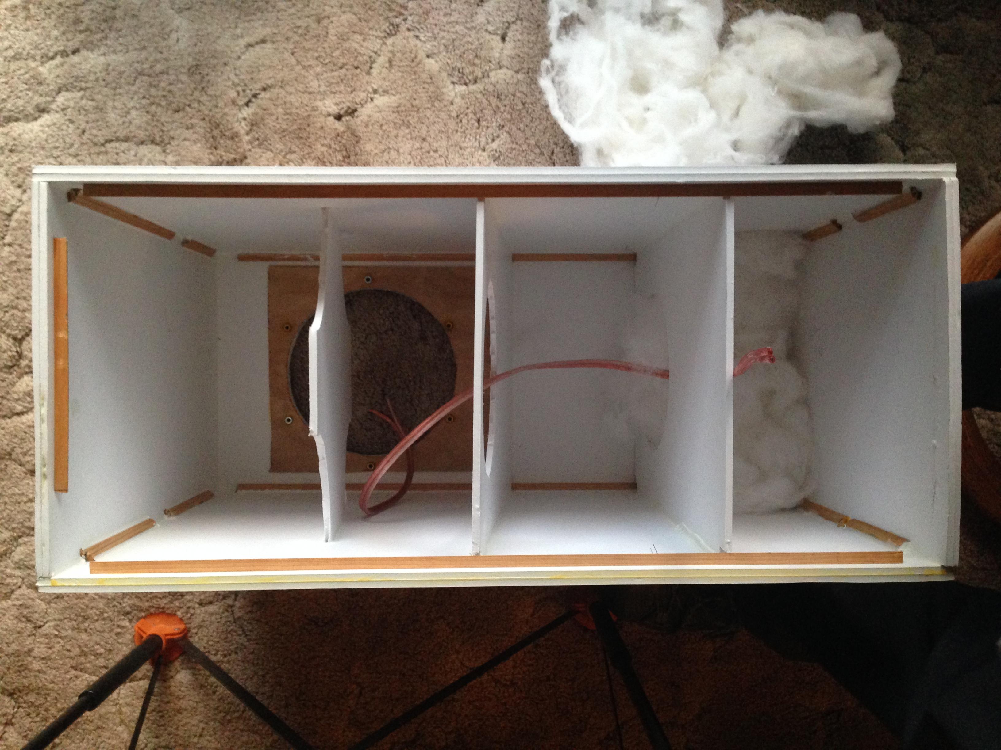

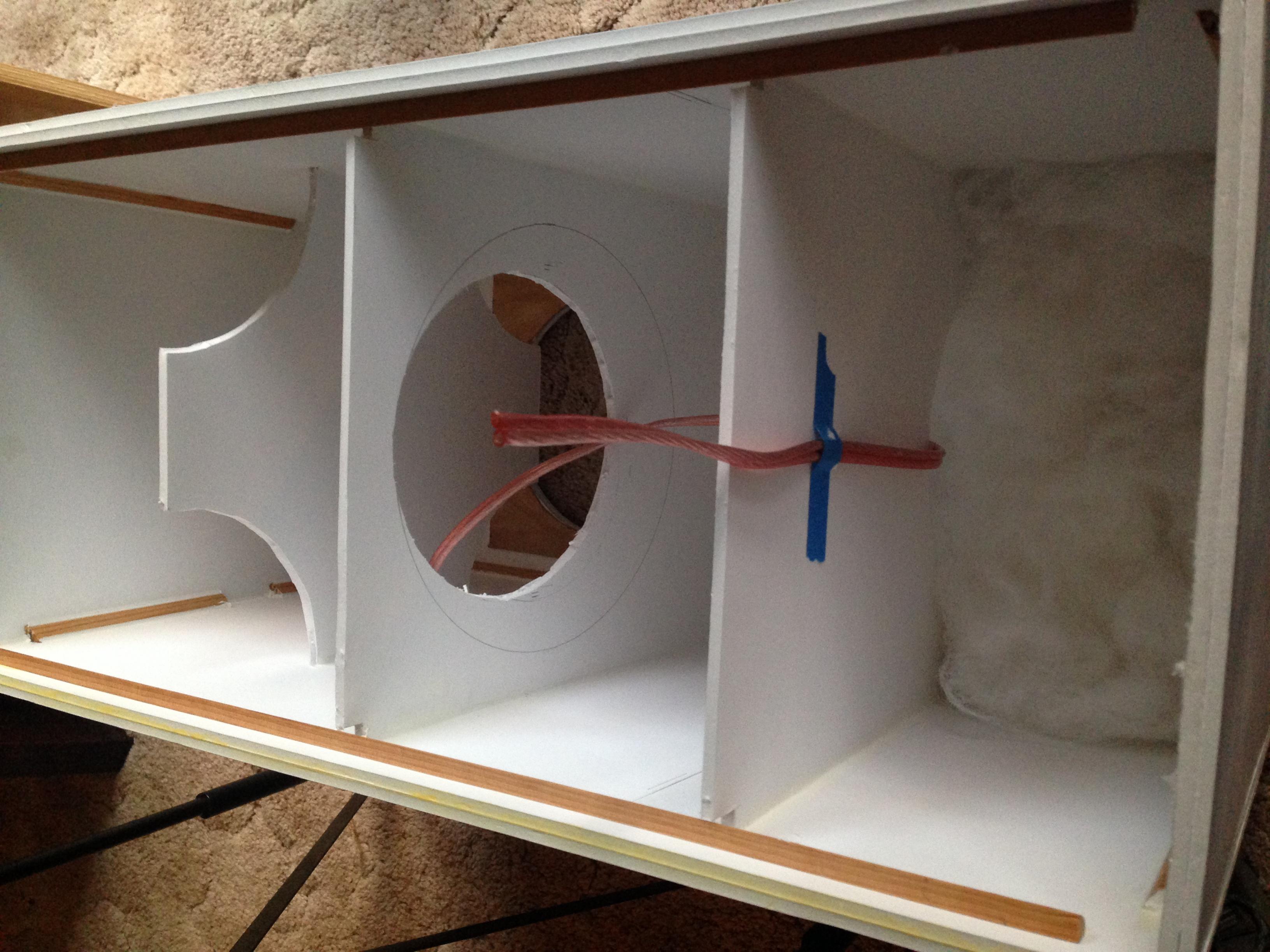

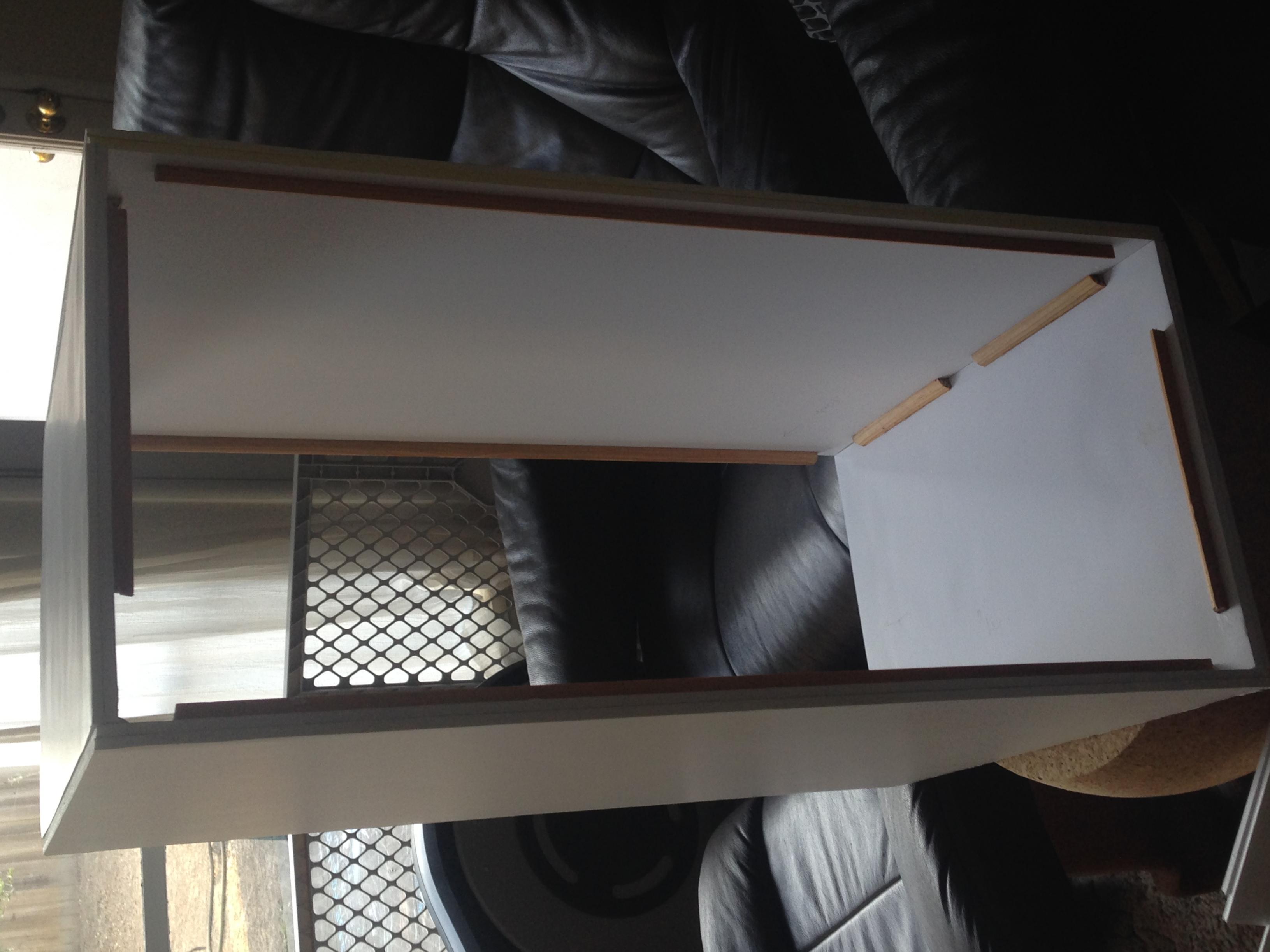

I finally completed my first foam core build as a prototype to see how my Seas H1597-08 - FA22RCZ full rangers sound before building a permanent box. They are built to the specs recommended by Seas in their Application Note.
These sound way better than I expected! So good in fact, that I'm in no hurry to build a wood box.
I beefed up construction by doubling the sides, top, bottom and back. The front baffle is 3 ply with a plywood ring inside for added strength at the mounting points and the driver recessed into the front ply. I also placed 3 additional horizontal supports with holes offset to inhibit standing waves. Finally, I stuffed with nylon Acousta Stuff before installing the drivers.
Because of my tendency to overbuild, this project took way longer than I expected and assembly evolved along the way. I'm currently driving them with my SIT 2 and very happy with the result. 🙂
