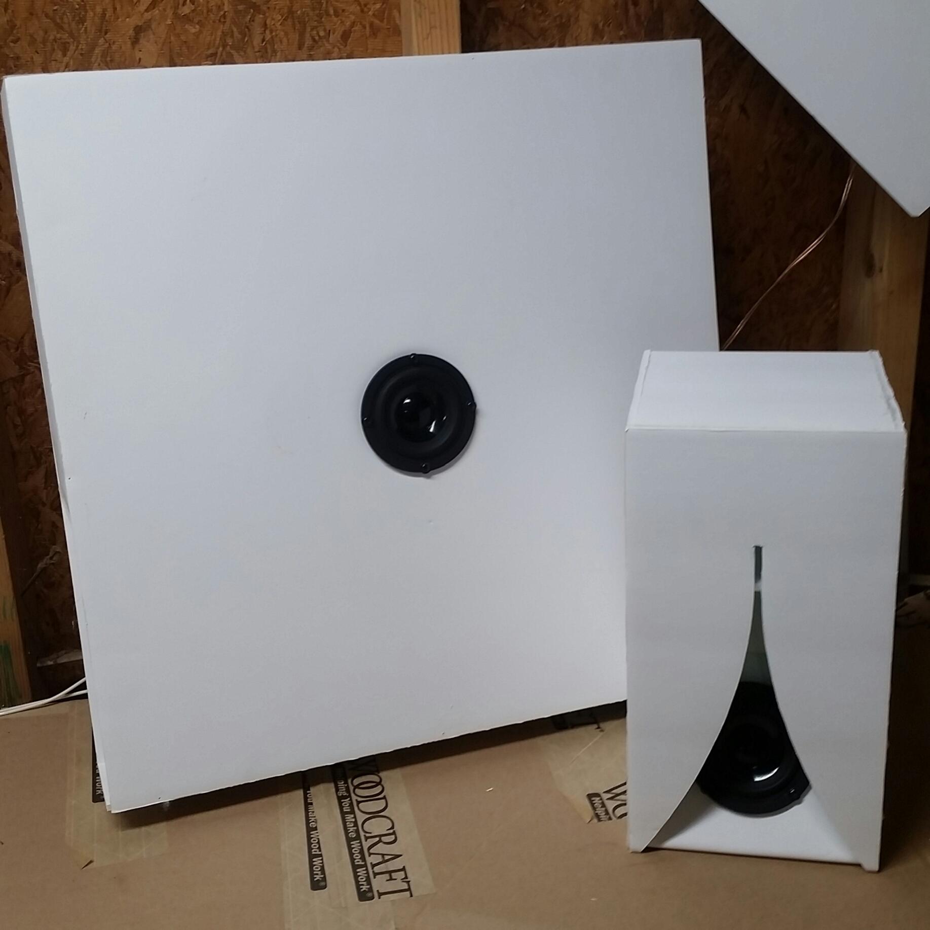

I thought I'd do a comparison so I built two different enclosures for the pair of Fountek FR89EX drivers I had. I built one 20" x 3.5" Cornu and one 0.4 Karlsonator.
The Karlsonator sounds really good. I was surprised at how much bass was coming out of that small speaker. The cabinet seemed to have a little flexing and it felt really lively.
But Cornu sounded much better to my ear and with my music. The bass was better, the volume louder, and it seemed to have much more sparkle.
It makes me wonder if I overstuffed the Karlsonator?
When my daughter saw the Karlsonator she said I built a butt-crack speaker. 😀
I'll be building another Cornu to make a matched pair.
