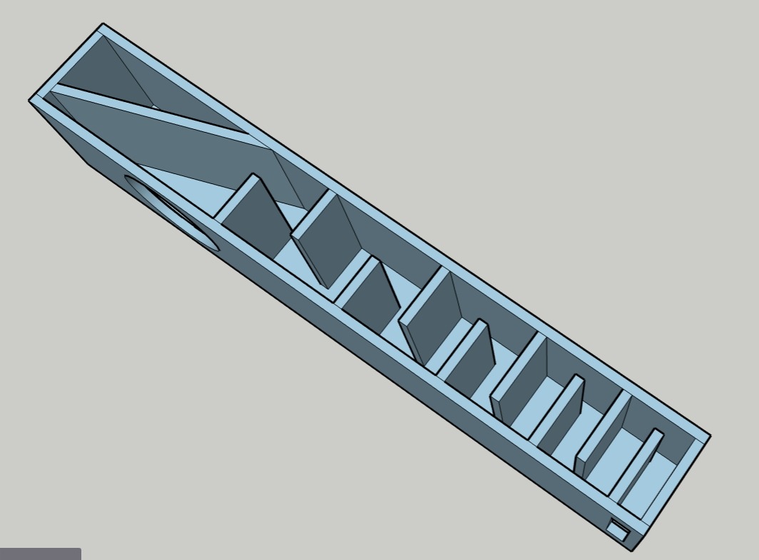

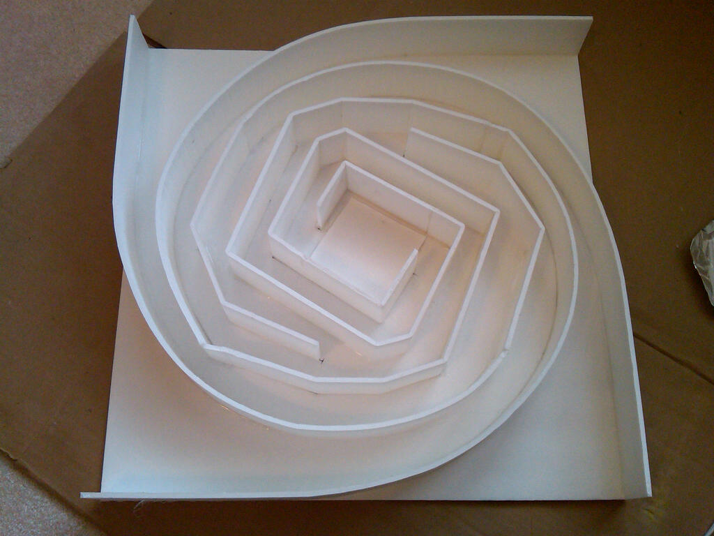

The volume is not important. Bigger the better - like at least 4 cu feet. Maybe 40in tall. You could do this with curved foam core sufficiently braced. Use same technique I used for curvy wall Tabaq.
TABAQ TL for Tang Band
*** but I see where you have been leading to based on your posts... ****
You are curious about back loaded horns or transmission lines. You are looking for an aero acoustic project.
Get a driver that was designed for vented alignments and has actual TS parameters published. Look for something with Qts under 0.50. A good driver to play with is the W5-2143. Super full range suitable for all sorts BLH, TL, BR, MLTL, etc.

In a TL or back loaded horn or something like that, the idea is to make use of the sound emitted by the back surface of the cone and slow it down and emit it from a hole(s) to get much lower sound. If I use the same car audio driver/speaker in such an enclosure with obstructions, won't it give even better bass? You've been doing lots of experiments, hence the question(s). :) Thanks!
Founder of XSA-Labs
Joined 2012

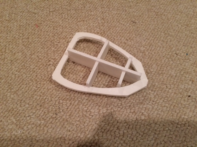

You are still stuck on the “round tube” being special. It’s not - only if you happen to want to use ready made piping or paper tubes used for concrete molds (called “sonotube” brand name). Because it’s a total waste of resources and time to make tube and cover with another enclosure. If you are concerned about vibrations, bracing usually solves or even using slightly thicker material. But the shape of the foam teardrop cross section above is actually very stiff. Having curvature in the side wall makes it stronger. But I have had luck with flat wall boxes with bracing. Look at the Nautaloss - flat walls with bracing. Or look at Cornu also lots of inherent bracing.
Those braces also break the sound waves, reflect/deflect them as they move to find an opening. The flat side of the speaker also vibrates/resonates and send sound out from its surface. Am I correct?

The braces are invisible to the bass sound waves that they are directing. Let’s say you want output below 100Hz to come from the channel. 100Hz is 3.4m wavelength and it requires something larger than about 1/3rd the wavelength to interact and cause constructive/destructive interference. Or anything smaller than 1m is of no consequence. You should read up on acoustics and waveguides and transmission lines. A good place is:
Quarter Wavelength Loudspeaker Design
