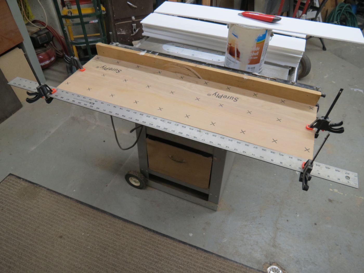

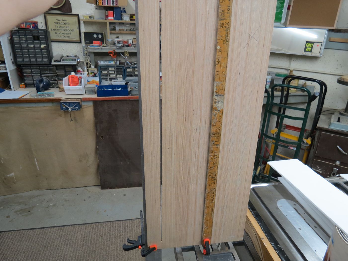

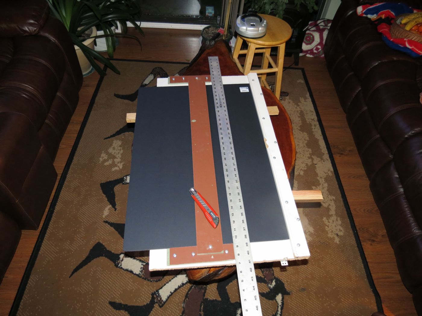

The first jig was for the 36" and the second for the 48"
First: The top. The metal straight edge guide unfortunately hides the slot from that angle. The fence you see is for the table saw, not related to the jig.
Second: Underside where you can see the slot, a bit of the guide and the wood ruler used as a fence that you butt the foam board to. The foam goes under the jig.
Last: Partway through a cut. The paint can is just to stop the jig from sliding around as I was cutting on the table saw. You can see the foam board slid under the jig.
The disadvantage is that you have to lift the jig to get your cut piece out.
The second jig was a little better as a 48"er includes a lot of cutting and I wanted it to go a little faster. Not much in the way of pics but I think you can get an idea of the workings. The metal straight edge plays no part here. The fence is on the right and the brown guide is elevated on the ends to allow the black foam board to slide under. This way I didn't have to lift the jig up each time. The guide was again just clamped in place.

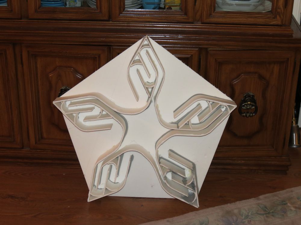

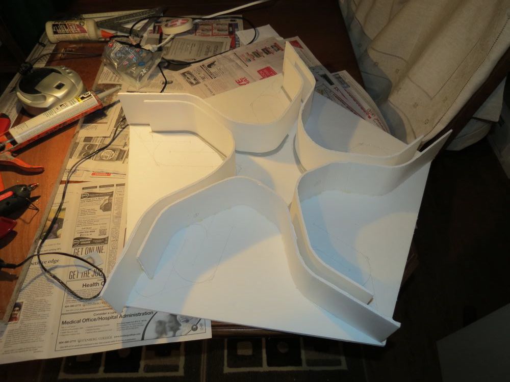

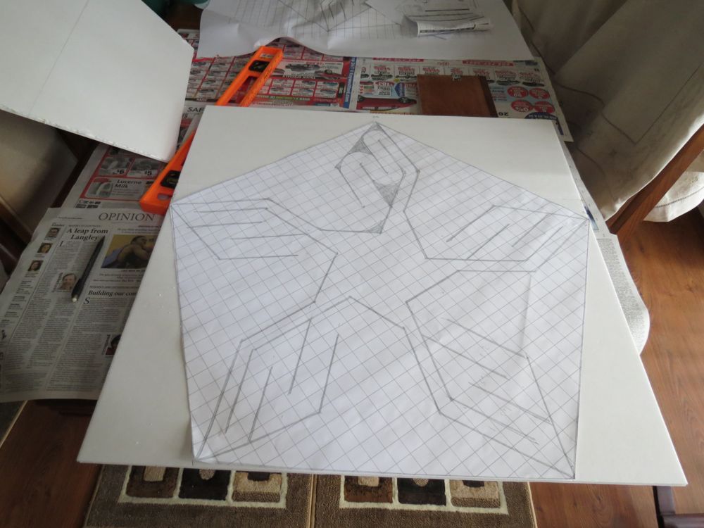

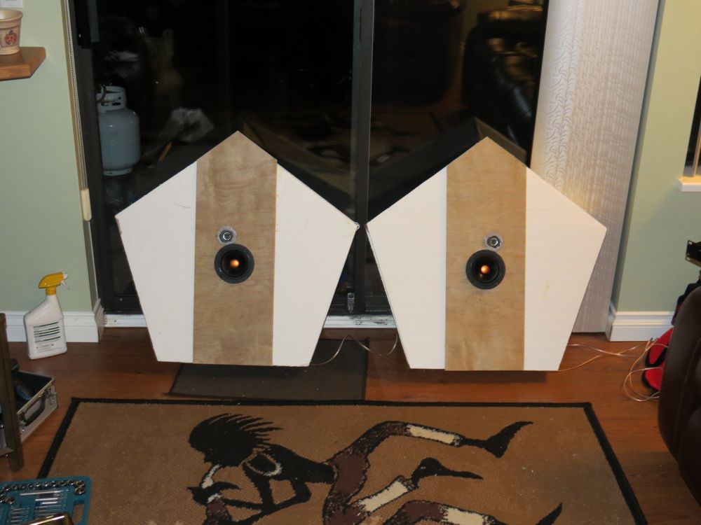

I think the funnest one so far was the Penthorn. Not the end all with the sound but most fun to design and build. Yes I made them but without X's inspiration and encouragement to begin with, like all the foam cores, they would still be a dream.
