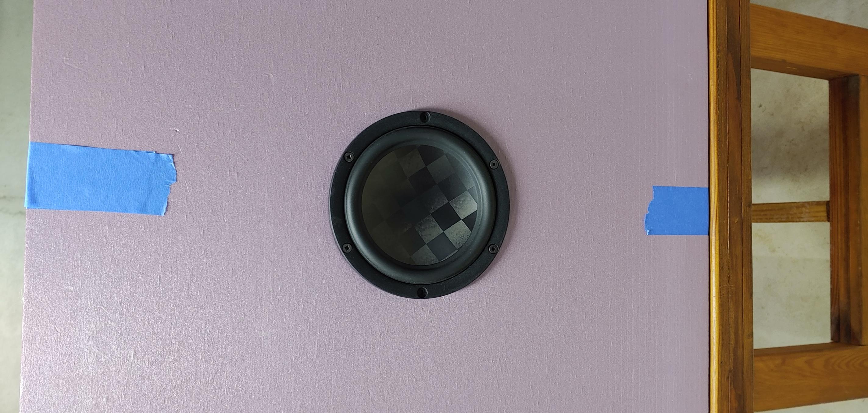

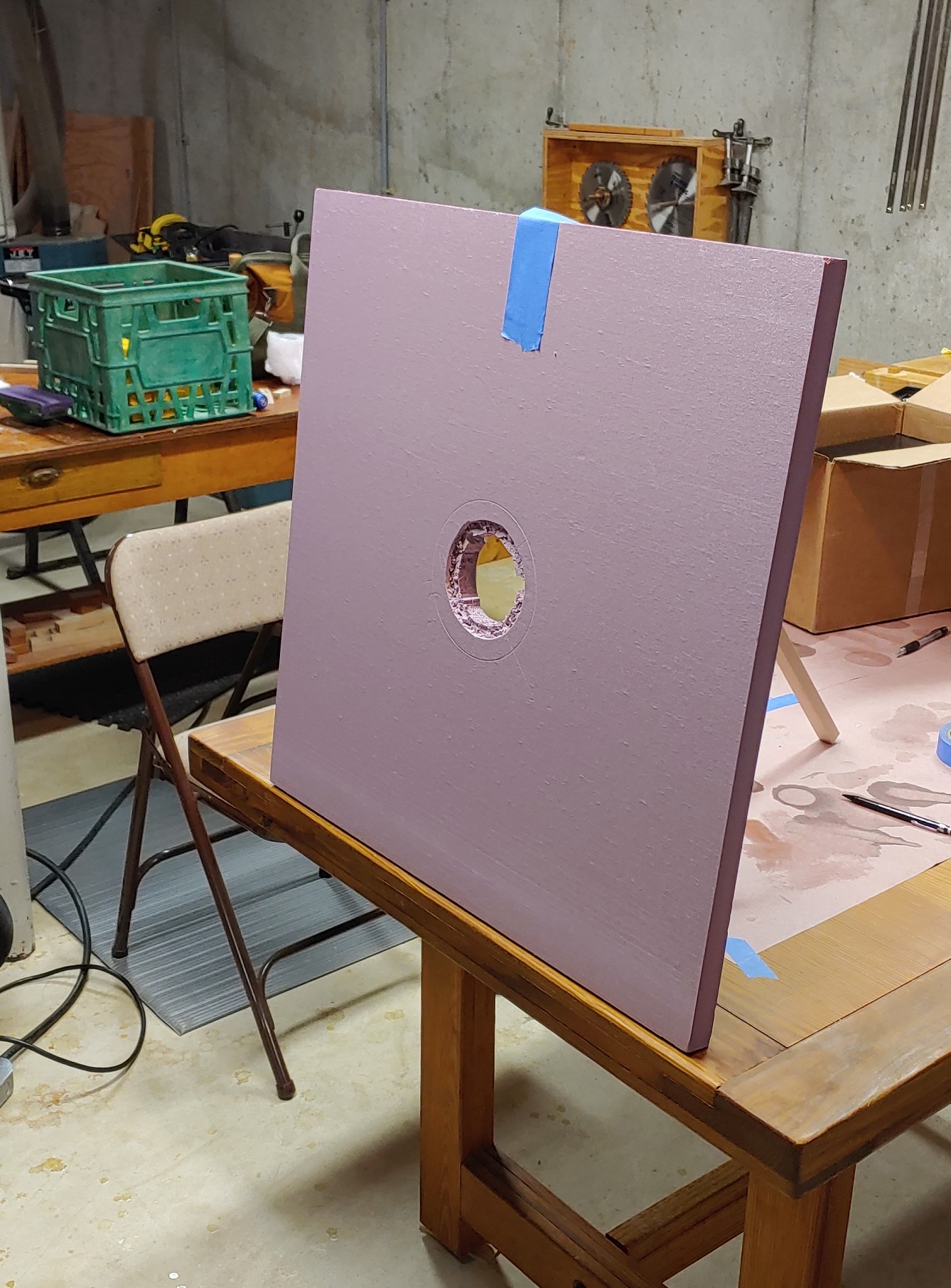

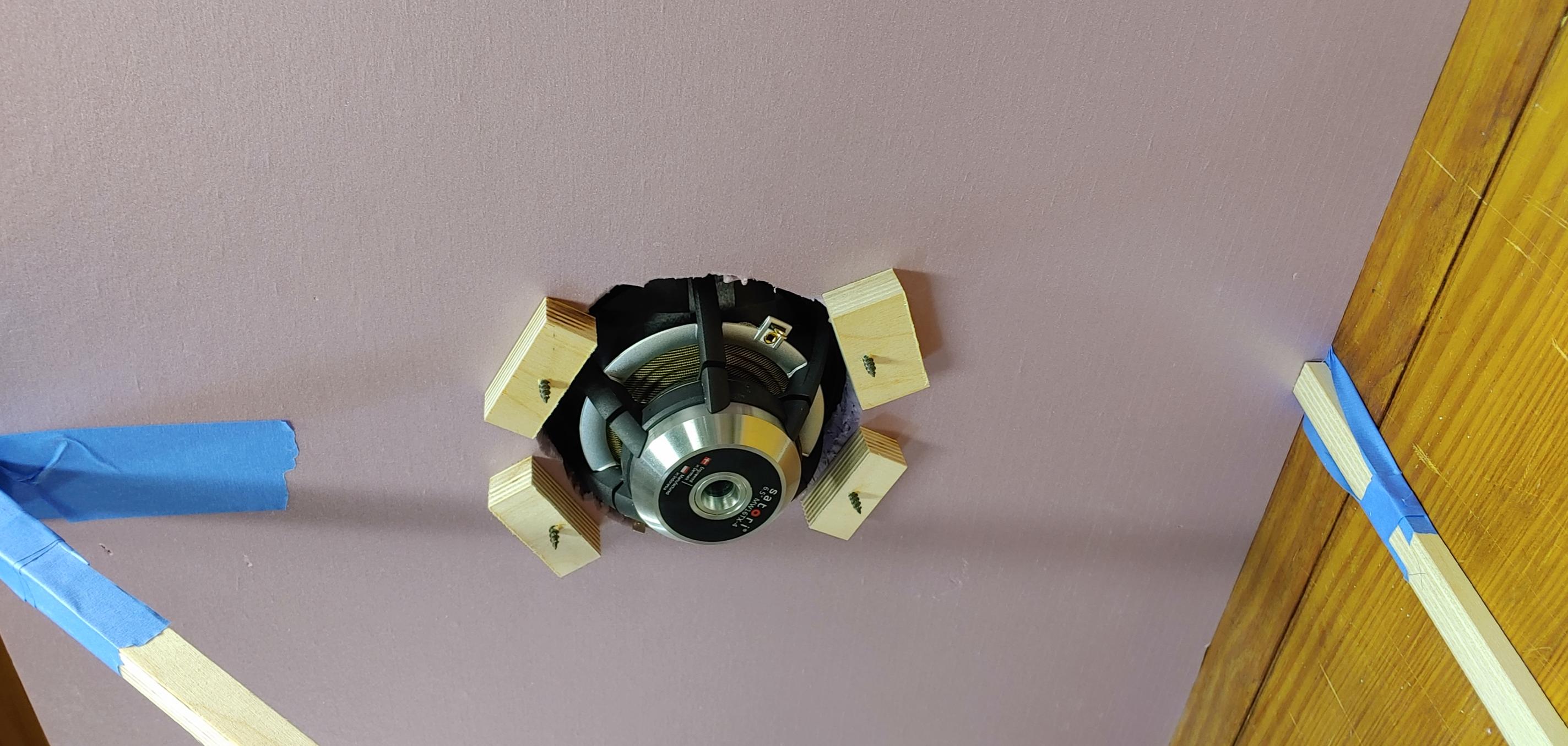

I am using foam board for a test baffle for impedance and frequency response measurements. It is 1" Owens Corning "foamular" board, Menards sells it in 2x2 panels and full size sheets.
https://www.diyaudio.com/forums/multi-way/343831-sb-acoustics-textreme-54.html#post6393377
If it works well for this application, I will update this thread...

The foam board worked out really well for a test baffle. Even with the 6 inch driver I did not need any additional stiffening.

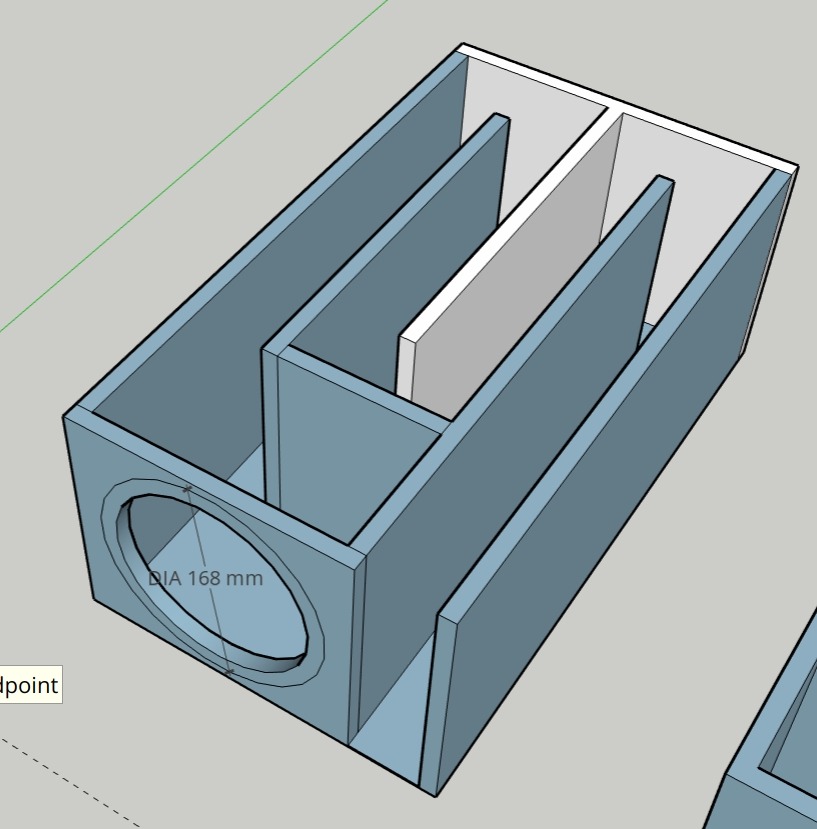

I am thinking of something like this for a 168mm (6.5") full range driver, only not yet sure of the box dimensions, yet. The hole is 144mm diameter. It could be placed with the vent on top, or bottom, or upward firing with a half a sphere over the driver.
Maybe, someone had done this here before.

^Looks like a subwoofer box to me. 🙂
I like the design. Of course, I know nothing about evaluating acoustic properties by sight, but it looks plausible. Mock it up in foamcore and see how it sounds!
It reminds me a lot of this design, which worked quite well. Of course, that was a highly-modeled design, and a much smaller driver, but still.... 😀

To really take advantage of the TL design it would be important to see what the TS parameters of the driver it was designed for and what kind of predicted response this gives. Just putting a random 6.5in driver in there may or may not work well. Ideally it should be simulated before building. Hornresp or similar programs can be very beneficial here.

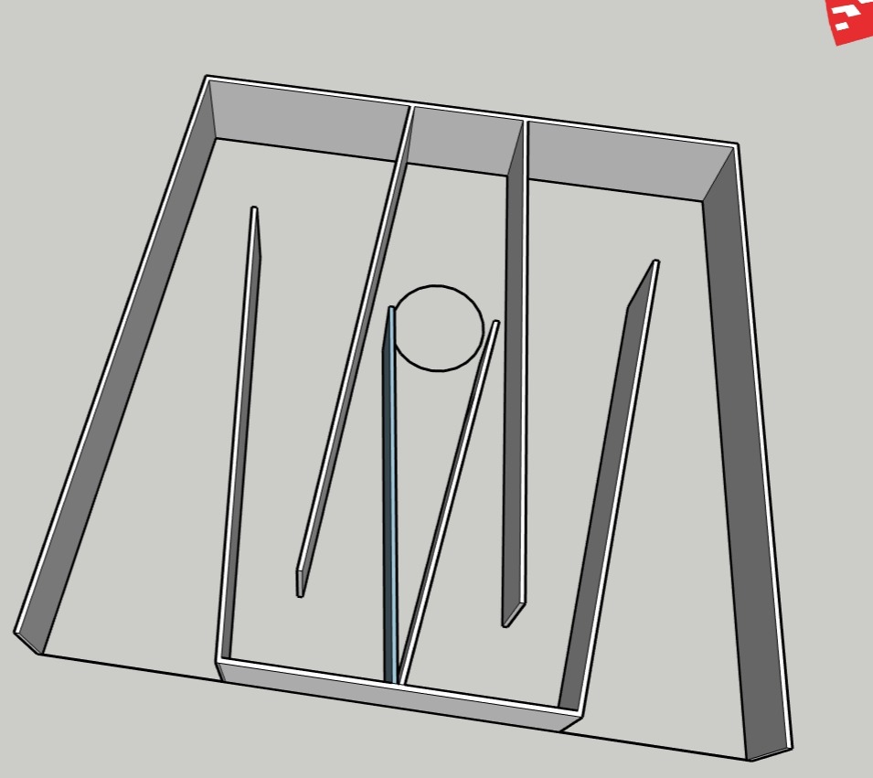

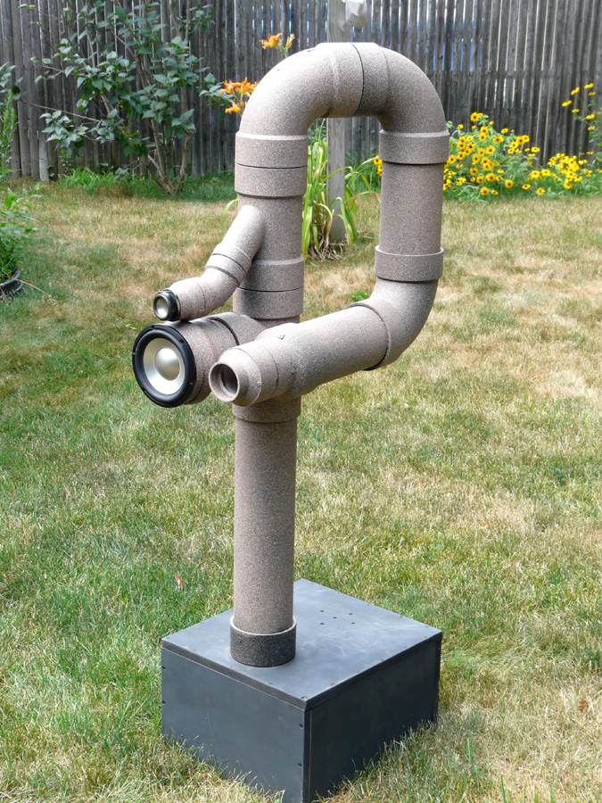

I am thinking of using foam pipe length(s) to find out the optimal length of the TL. These tubes can be made from 2mm foam mats left after floor repairs. 2mm foam mats are too flimsy for walls, but as tubes they are stiff enough. Can't get thicker mats, as there's some sort of a lock down. 🙂
I am also thinking of this dual side back loaded horns for flat wall box, thickness about 10cm. There's another idea about using triple or quadruple Fibonacci spiral. What do you think?
This doesn't have to be this wide, but can be thin and tall.
Why make tubes out of the foam core and encase in a rectangular box when rectangular cross section channels are just as good. There is no advantage to round cross section other than if you start with tubes like PVC piping.
