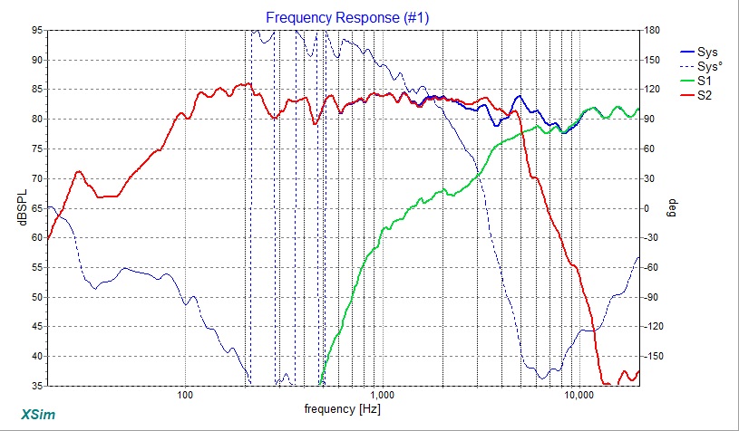

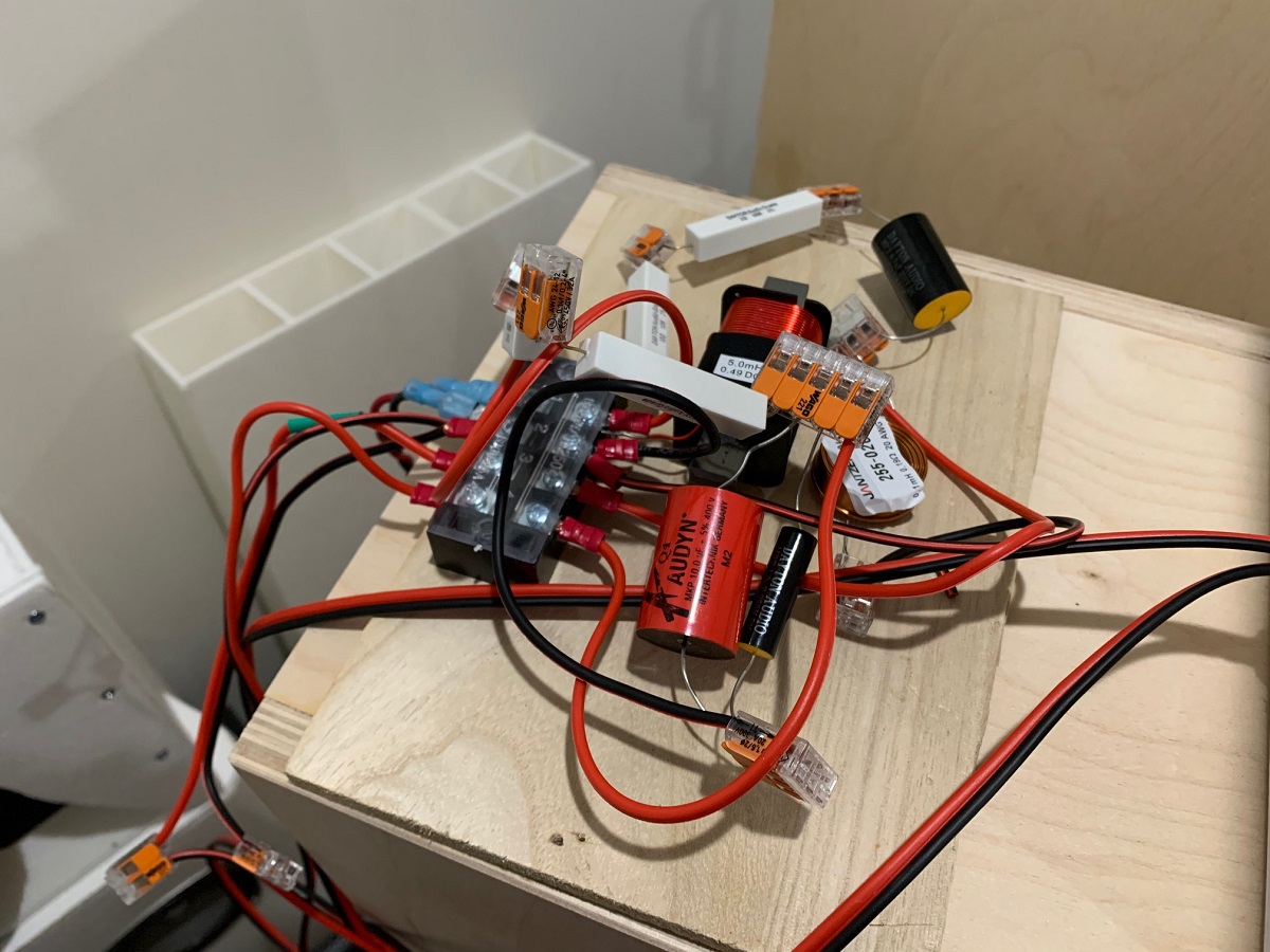

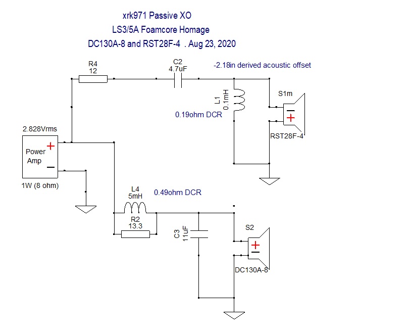

The foamcore LS3/5A homage is finally in stereo and with permanent crossover:
RST28F and DC130A Foamcore Homage to LS3/5A

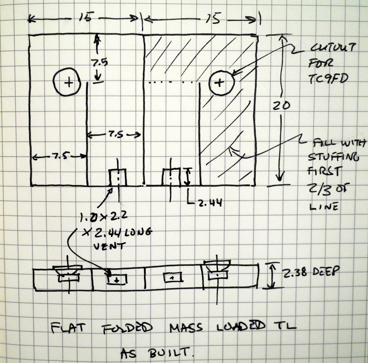

Hello XRK,
Getting into this amazing world of building foam board speakers and learning a lot from your & others here.
I have received my Vifa TC9FDs last week and hoping to build a couple of designs from your photos and drawings.
Reading the forum but it is like drinking from a fire hose at the moment. So just a few questions -
1. What thickness of foam board I should buy from dollar stores?
2. Are the TC9FDs mounted with its flange outside or over the baffle? I thought they come with a padding to create a seal when mounted to the back side of the baffle?
3. Do you have the driver location or position details for this design? Also what does fill up to 2/3 of the line means? Is it 2/3 of the height ? - Foam Core Board Speaker Enclosures?
4. Do you have a drawing for the 20" X 20" Cornu spiral design for the Vifa TC9FDs?
Sorry for the trouble but too excited to build something with my son and still trying to go through this long thread to find pertinent information.
Thanks a bunch and hoping to learn a lot,
NG

Welcome NG!
Dollar store foamcore only comes in 3/16in thick and 30in x 20in Sheets. The heavier stuff made by Elmer’s at art craft stores like Michaels or Hobby Lobby is also 3/16 bit stronger.
Most of my stuff is mounted from front. I have actually never rear mounted them to use the foam gasket. I think that was for some OEM TV speaker application? Or for something g like a line array cabinet?
Drawing for 20in cornu is in Cornu thread - just scale the pdf plan (27in) down to 20in using the print scale function when printing. Use a ruler to measure print and adjust accordingly.
Stuffing is usually from closed end to where driver is on a MLTL. So that’s the first 1/3rd.
My stuffing plan for this one went a little father than usual and went past the driver down to first 2/3rd from closed end. I am not convinced that this is best now. Adjust it by ear. It may be too much. The first 1/3rd rule is much more universal.

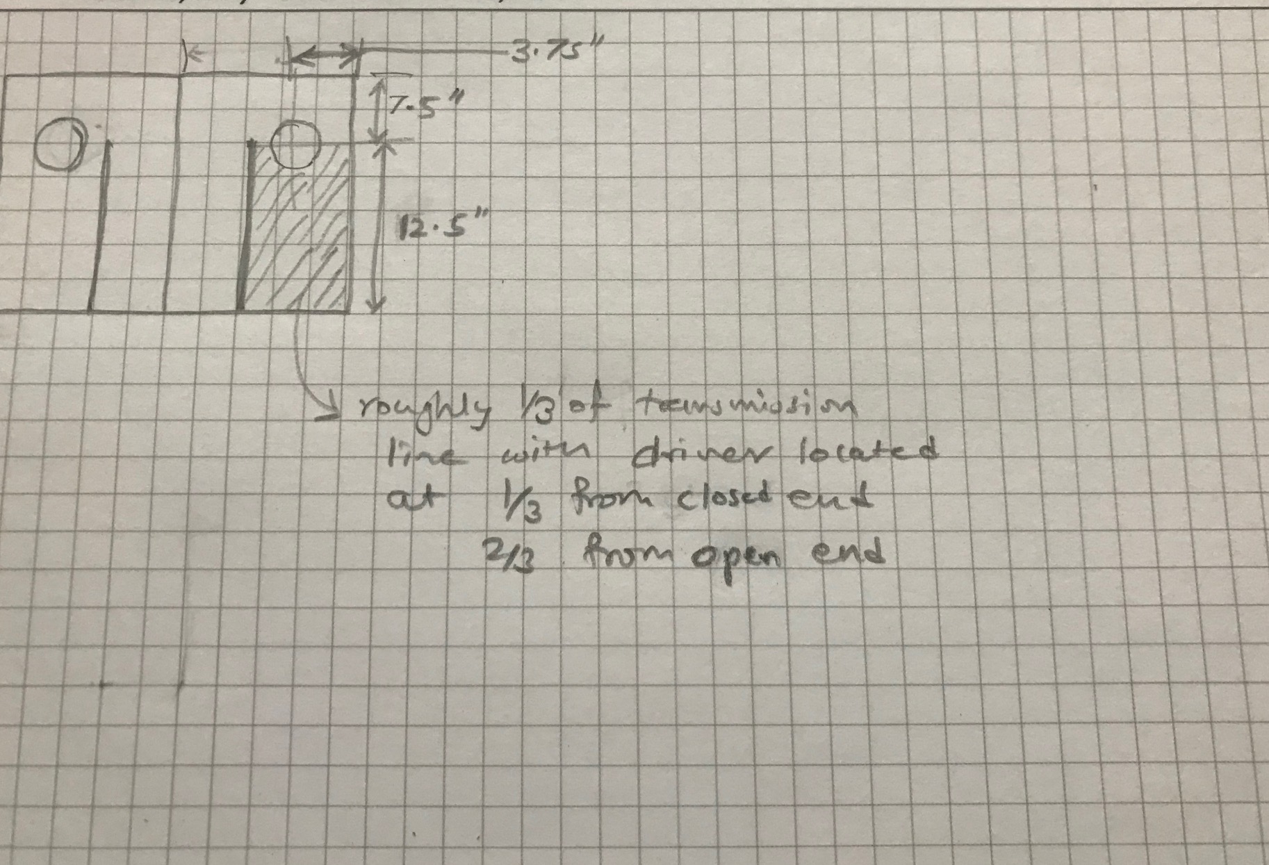

Thank you so much for a quick response. Learning something each time from your posts
So here is my interpretation of your drawing. Specifically the driver will be centered at 3.75" from the sides and 12.5" from the bottom. Also, the 12.5" from the driver to the bottom will be filled with pillow stuffing 🙂
Hope I got that right. Will have something to share by Sunday night.
Thanks once again
Yes, that’s about right. The lateral position is flexible. You can move it closer towards the divider wall - clearance for the basket provided though.
