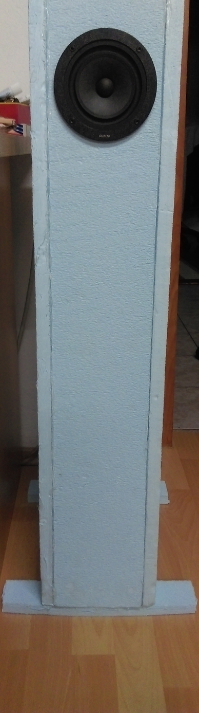

The foam boards works well in things like the Cornu because it's only about 3-5" wide and the pressure is equal on either side of it. In a more regular box, the panels are prone to flexing so need to be stiffer. For a 1/2" board I wouldn't go more than about 6-8" by 10 or maybe 12". Doubling the baffles is always a good idea.

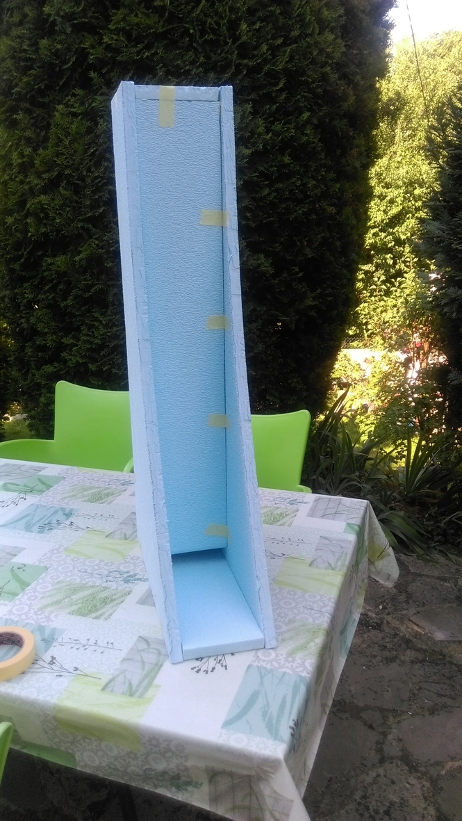

So I destroyed some more XPS boards and some hot glue. Playing quite nice. Better half said that even they not have same response as my other speakers this speakers doesnt irritate her. Other speakers are Sonus Faber Signum and Monitor Audio Gold 100 connected with Straight Wire Virtuoso to Denon PMA 2010.
This is Mark Audio CHP 70 connected to Kenwood micro system...what to say
Nice work Cindra! So the foam speaker sounds better than a Sonus Faber to your spouse? Nice. 😎
Thx guys��
Elmojo, its really easy to work with foam boards. I used sharp kitchen knife. Not too happy with hot glue but wasnt sure what to use because some glues melt foam (learn that hard way)

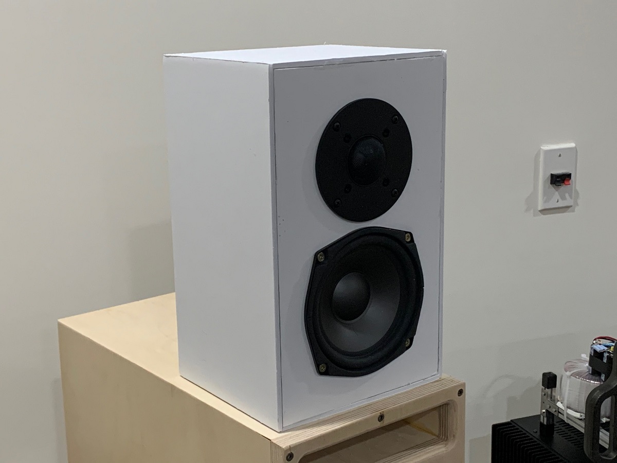

Homage to LS3/5A in Foamcore
I have not posted a speaker build here for a while, but I got to urge to make another set of foamcore speakers, and this time wanted to try something very conventional: a 12in tall x 7.5in wide x 6.5in deep compact 2-way sealed monitor with 5.25in woofer and 1in dome tweeter. Sound familiar? Well it's an homage to the venerable LS3/5A. It started as a question of whether or not I could try to make an inexpensive speaker that mimics the response curve of the LS3/5A over in this thread.

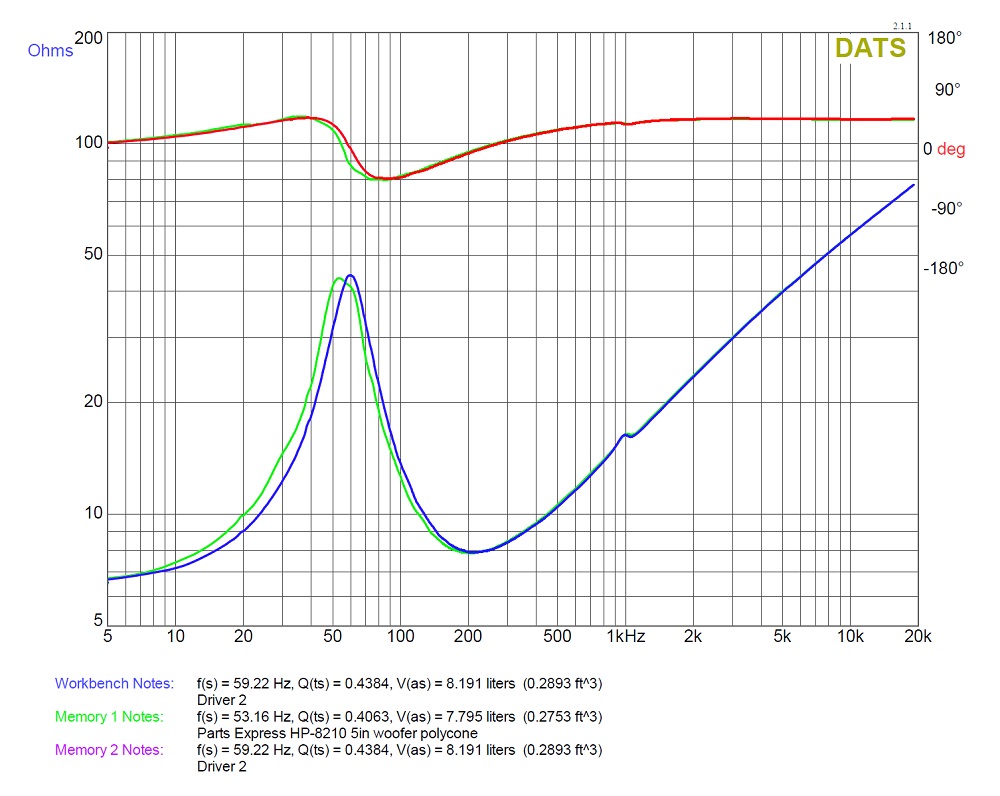

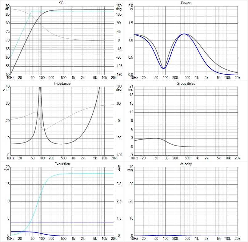

I am using a polycone 5.25in blowout driver from Parts Express, the HP-5210 and the Dayton RST28F-4 dome tweeter. Here is how the woofer measured on DATS:
Since I am using foamcore (3/16in thick), there is a bit more than 5L in volume compare to using 1/2in BB ply. For 7.5L, the simulation in VituixCAD for this driver's TS parameters shows a -3dB of about 95Hz - consistent with the goal of replicating the bass response of the LS3/5A - predicted response curve here:

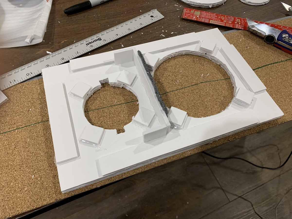

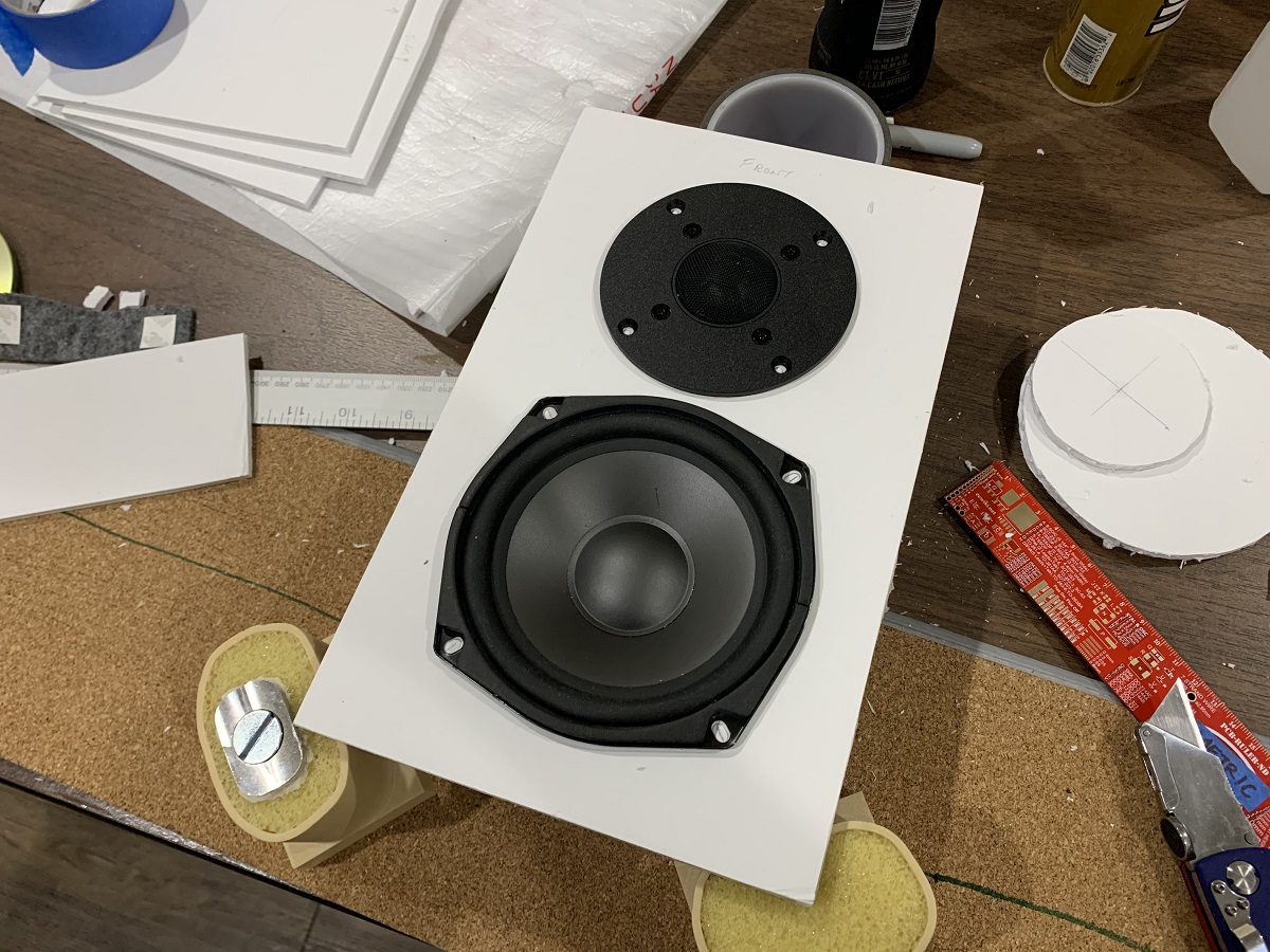

I started by cutting out the panels using a Starrett aluminum meter stick and utility knife:

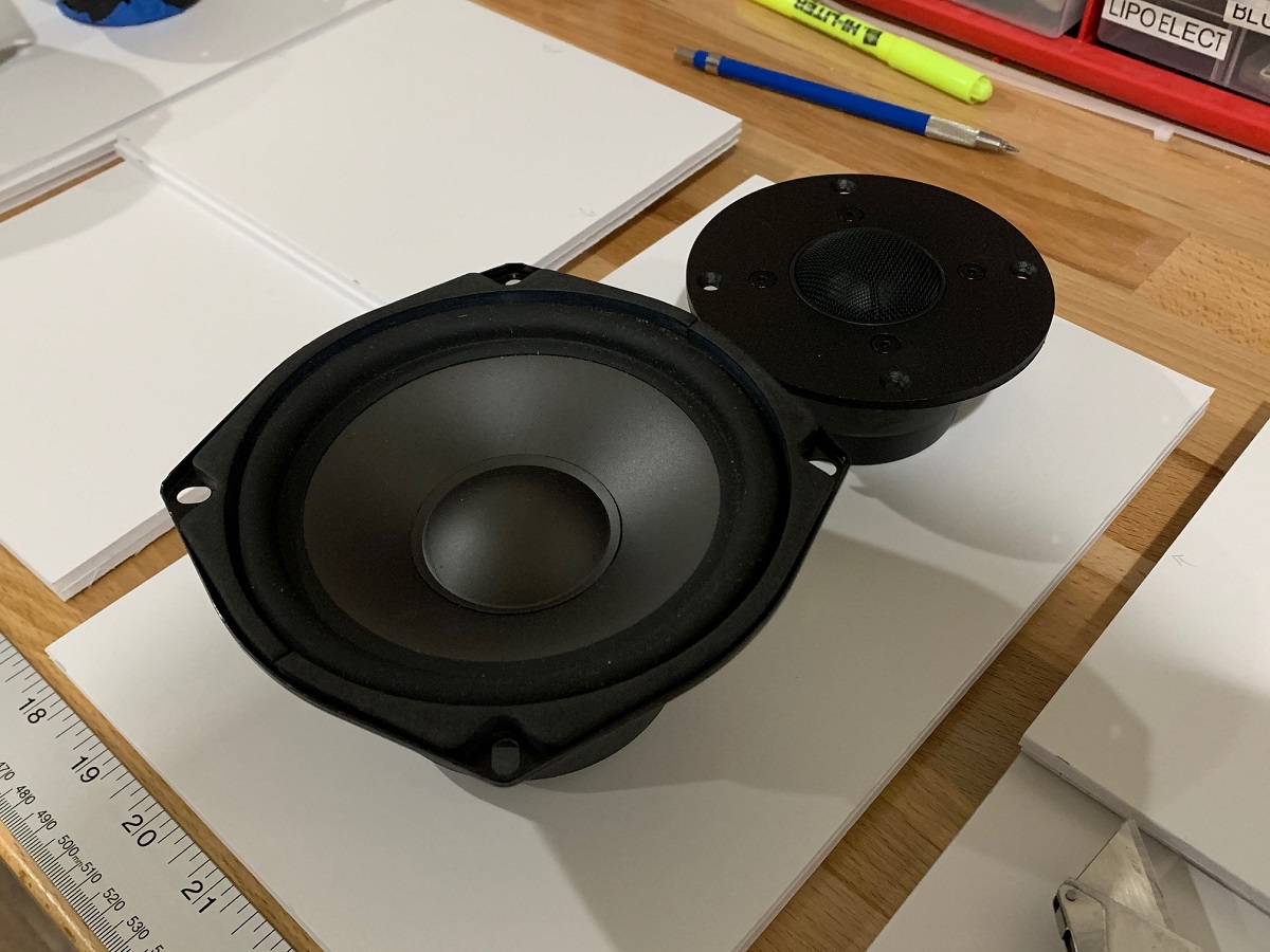

The drivers have a nice look and will fit well:

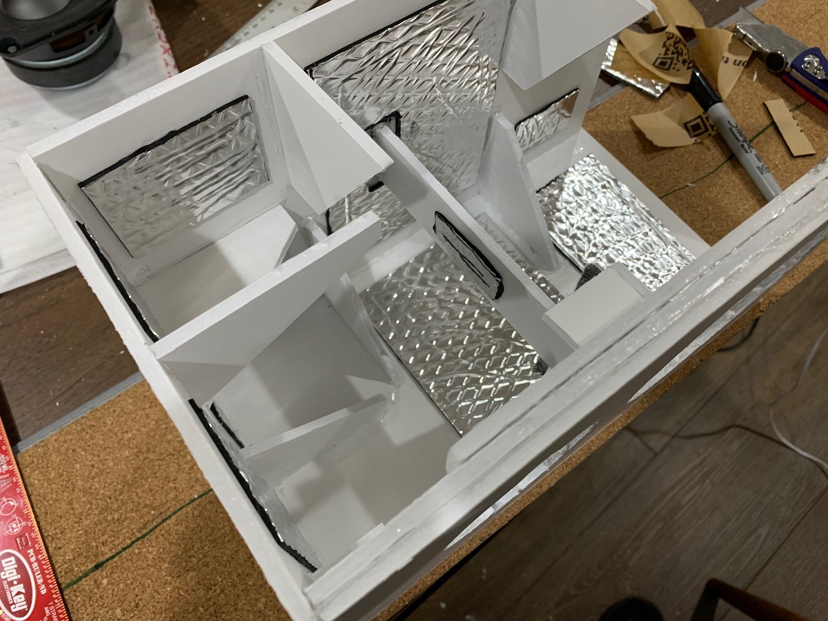

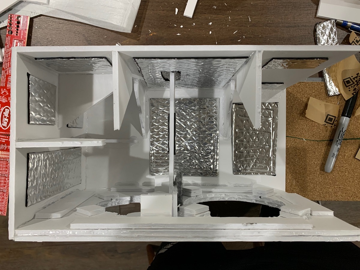

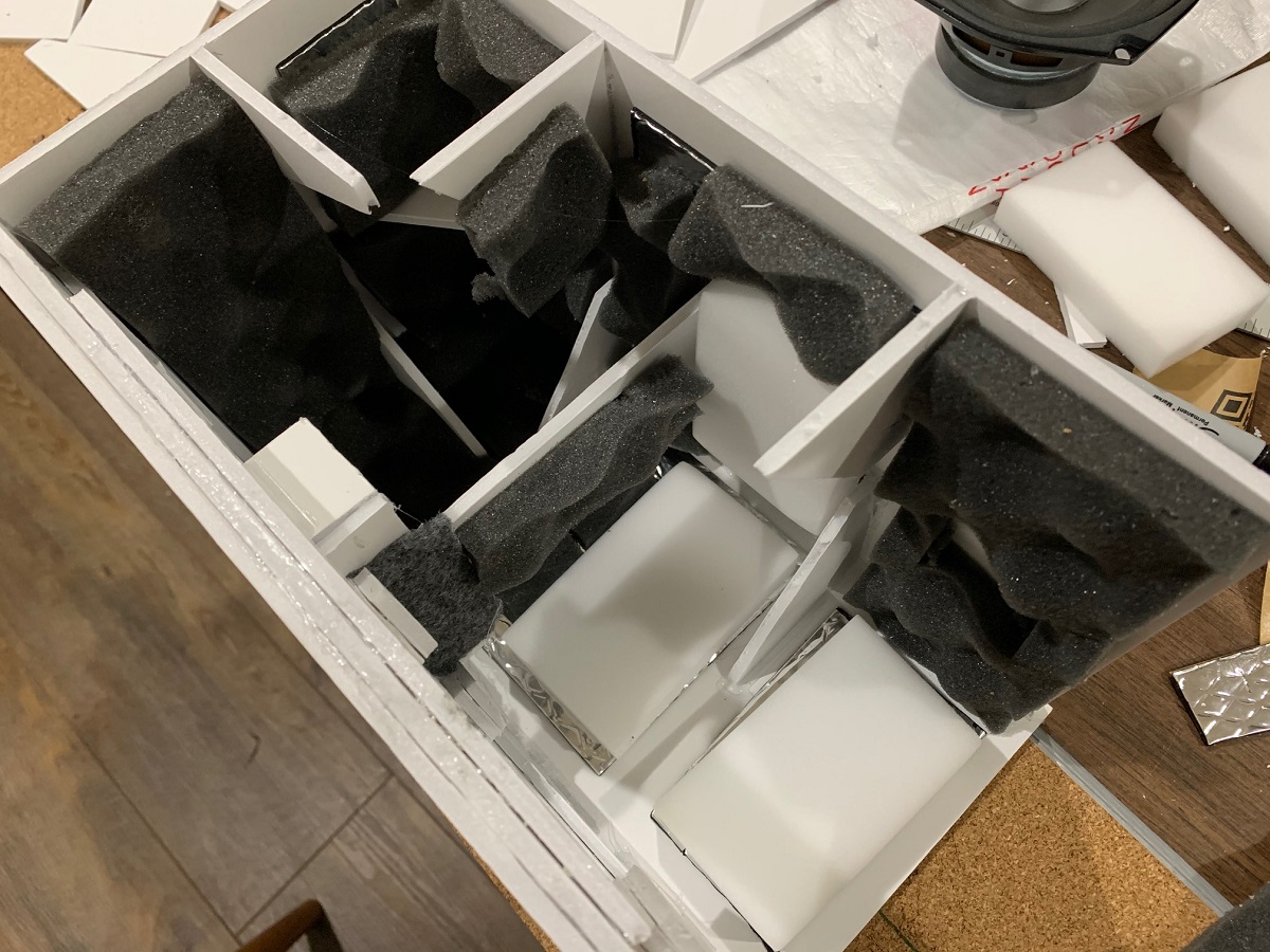

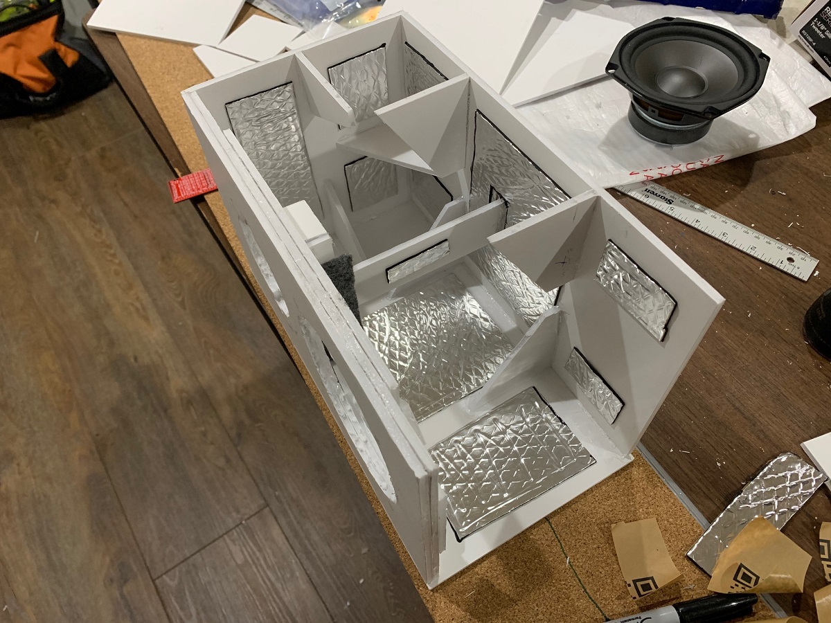

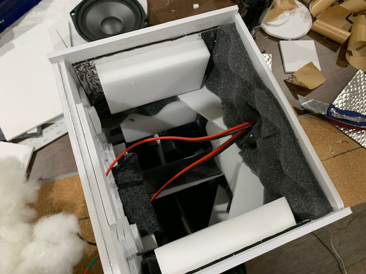

Construction proceeded with adding Noico mass loaded butyl sheets to the inside to dampen panel vibrations, then strategically located melamine foam pads plus 1/2in thick grey acoustic eggcrate foam. Of course, lots of bracing. This whole speaker went together using hot melt glue. I did things differently this time in that I glued the bottom panel on last.
Lots of bracing on the front baffle and extra pads for the screw mounts:
Noico damping:
Melamine foam and grey acoustic foam application:

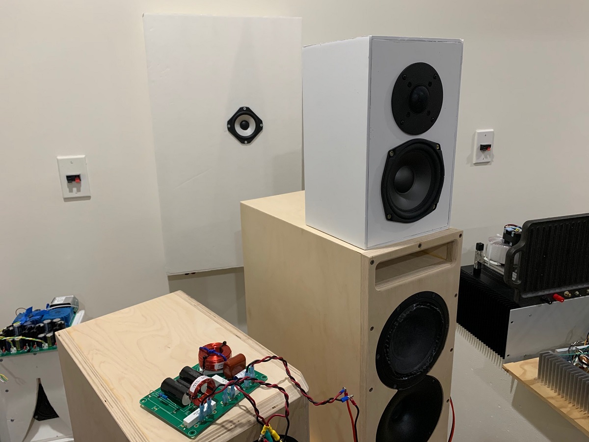

Adding two sets of wires so that the XO can be developed externally first. Once the XO is finalized, it will be installed inside and the wires replaced with a terminal cup:
First test with an existing XO I had from another speaker - sounds pretty good actually:
I will measure the driver raw responses tomorrow and then develop the XO in Xsim. I might try VituixCAD if I can get past the learning curve.
I have one built - and if all goes well, will make the second one on another night.
Noico damping:

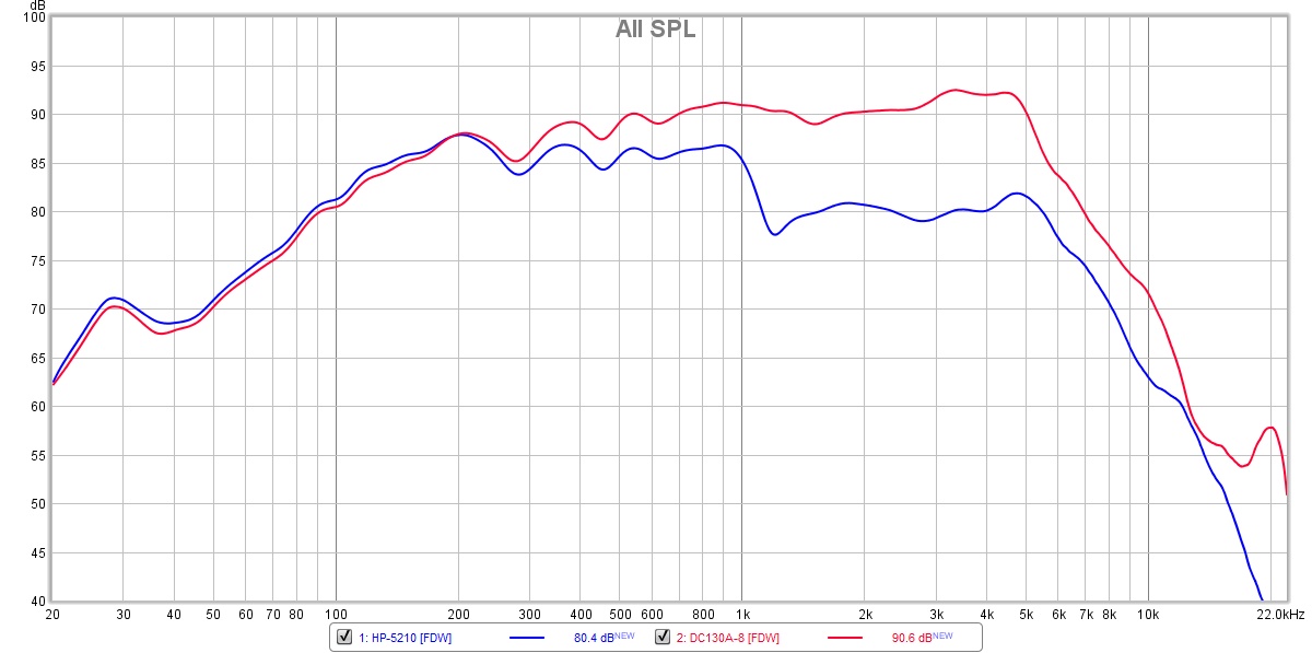

The cheap buyout woofer just isn't going to cut it. I switched to a Dayton DC130A-8, which has a much smoother response and is still in production. Data measured at 0.5m and 2.0Vrms on tweeter axis with6-cycle freq dependent window (FDW) enabled.
