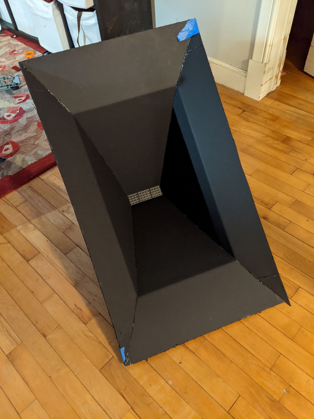

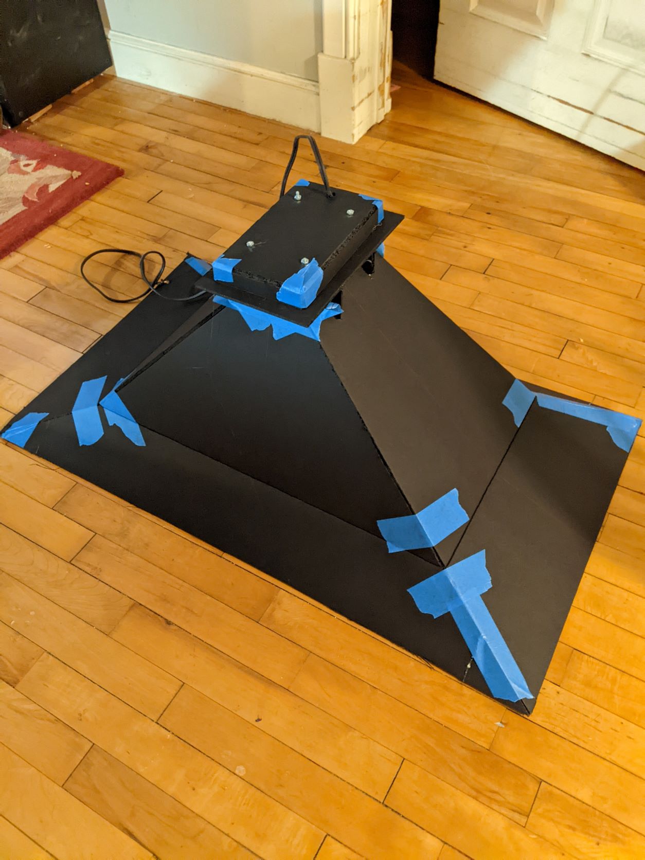

I've been musing over a couple of designs recently, and then I discovered this thread showing off how the GRS 8" planar driver loads well into a horn.
After a brief chat with @xrk971 , I decided to go ahead and use @bwaslo 's spreadsheet to create a 250Hz horn, and then stretch the vertical dimension to accommodate for the rectangular shape of the driver.
I was told that the back chamber could be small, so I made it 6.5" wide, 10" tall and 1" deep.
I had some 1.75" machine bolts and nuts at hand, which allowed me to not only bolt the driver to the throat flange, but also bolt the rear chamber to the flange as well, which made life simpler - all I needed were 4 bolts and 8 nuts for each horn.
I've done a little bit of listening with them as a stereo pair, and they're very pleasant to listen to. Very accurate without sounding 'cold', and the transient response is fantastic. I did get the sensation of being enveloped in sound again, similar to that headphone effect, and the stereo separation was really accurate and created a very detailed image.
My crossover to my Bass speakers was a little high at 400Hz, so I'm not sure if I was missing any information, but I'm going to sort it out so that the crossover is at 250Hz.
All in all a quick build with a really good result. Highly recommended! :)
