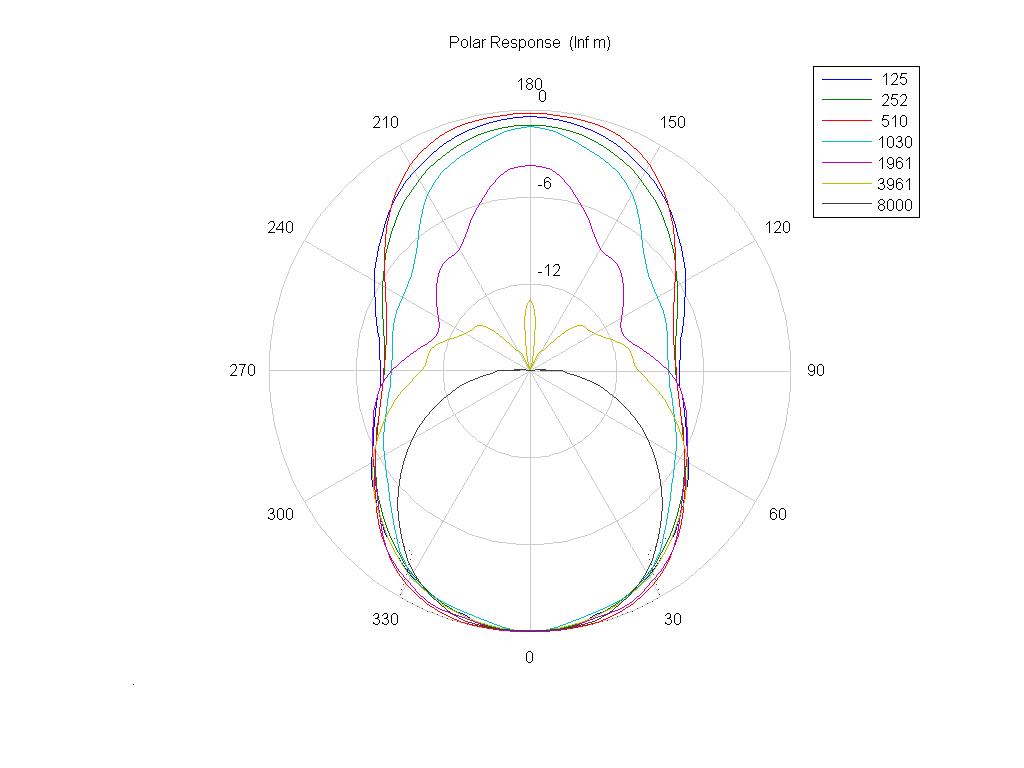

Floor to ceiling is fine but there are a lot of weighted coefficients arrays that give smooth response on and off axis.
I'm currently working on a log spaced array that has fabulously good polars with constant directivity. Its proprietary work so I can't go into the individual drive curves but here is a polar curve to give you a taste.
9 elements in a progressively expanding array.
Constant directivity for over 6 Octaves.
Absolutely no lobes.
David
David
Dave - constant directivity only in one plane you mean, correct? Unless it is a 2-D array, but with only 9 units it can't be. Still, good for churches and that sort of venue, but that's hardly new for those applications. Keele's array works very well in the vertical, but I care far less about the vertical than the horizontal in a small listening room and his is not controlled horizontally.
Certainly. No different than any of the other line arrays discussed here. Directivity in the horizontal plane is simply that of a single element.
These are a good match to what Toole and others believe, that wide lateral dispersion and narrow vertical are a good fit to our hearing mechanisms. (Not to narrow here, as the array was intentionally designed to match the units inherent dispersion, about 120 degrees up to 4k or so.)
I will probably end up building a pair of these and mounting them flush or near flush in the walls.
David
David
I'm assuming the median plane. What is the speaker's total size, David?
1.4 meters from end to end. Everything is scalable but the sim shown is based on a 58mm full range unit (chassis width) and sized to match the appropriate bandwidth of the unit. It holds pattern to below 125 and can then pass to a small sub.
David
