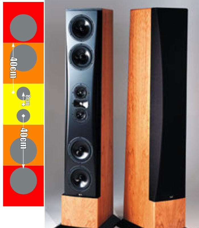

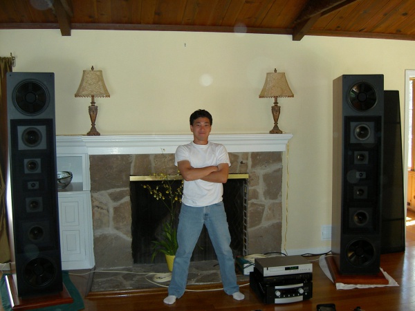

A picture is worth a thousand words, so I made one.
This is David's Snell XA Reference. As noted earlier in the thread, the crossover points dictate the geometry. According to David, "I tried a number of alternative schemes, but none of these alternative systems looked promising, so a more conventional symmetric array was settled on... The simulations showed that constant directivity came from having a constant element spacing relative to the crossover frequency. That is, if the highest crossover frequency is six times the next crossover frequency, the mid-to-tweeter spacing should be one sixth the woofer-to-tweeter spacing. Both of these spacings should be one third (at most, one half) the crossover wavelength. In practice, this means the mids had to be placed very close physically to the tweeter, and the top crossover point should be as low as practical."
In the illustration, we see that the Snell meets this criteria. The distance from the center of the midrange to the center of the woofer is 40cm. 850hz is 40cm long. Divide that by three and you get 283hz. Not coincidentally, the crossover from midrange to woofer is about 283hz. 300hz, to be exact.
The distance from the center of the tweeter to the center of the midrange is 8cm. 4250hz is 8cm long. Divide that by two and you get 2125hz. Not coincidentally, the crossover from tweeter to midrange is about 2.1khz. 2.4khz, to be exact.

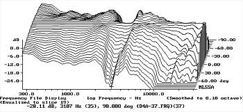

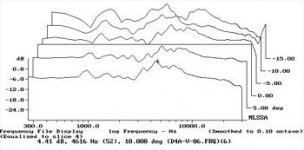

Here's the frequency response.
Here's the vertical polars. There's a bit of narrowing at the xover between the midrange and the tweeter (2.4khz) but otherwise the array is doing exactly what it's supposed to do. The narrowing above 13.5khz is due to the sound wavelength becoming smaller than the diaphragm.
If you stare at it for a bit, you'll realize a few things:
1) This concept applies to an array of any size. The Snell array is about a meter and a half from end-to-end, but there's nothing stopping you from extending the concept to two meters, or even three meters.
2) If you want horizontal directivity instead of vertical directivity, flip the array on it's side
3) If you like the sound of the Quad ESL, you could do this array in two dimensions and create something similar
4) Though Snell used drivers of dissimilar size, there's nothing stopping you from doing this design with a pile of full range drivers. For instance, if you used an array of nine 3" drivers you would have an array with a surface area that's like a 9" woofer, but with high frequency extension of a 3" driver. Not a bad combo, no?

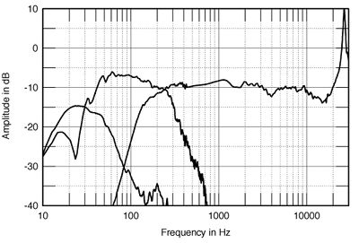

Here's why:

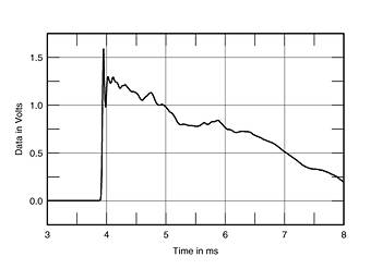

John Dunlavy's number one criteria was excellent phase. To achieve this, he used first order slopes. Dunlavy and Danley make speakers that can recreate a square wave; most speakers can't do this. The Snell can't do this. Here's the step response of the Dunlavy and the Snell:
You can see that Dunlavy really focused on getting that step response as perfect as possible (and he made no secret of this on rec.audio)

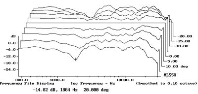

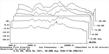

I can't speak for David, but I'm under the impression that the Snell is optimized for vertical directivity. Basically it's a speaker with wide horizontal directivity and narrow verticaly directivity. This is the same goal that B&O and Revel pursue. Here's the vertical directivity of the Dunlavy and the Snell. Note that the Snell measurement goes out to +/- 20 degrees, while the Dunlavy measurement goes out to +/- 10 degrees. This difference makes it hard to see the difference in vertical directivity between the two, but you can see that the Snell is noticeably better.
Here's the horizontal directivity of the Dunlavy:
(Stereophile didn't publish one for the Snell.)
Long story short: yes, the two speakers LOOK similar. But Dunlavy was all about phase response, and it shows in the measurements. I believe Smith was after directivity, and you can see the difference in the measurements. (Hint: the tighter spacing of the Snell makes a difference.)
