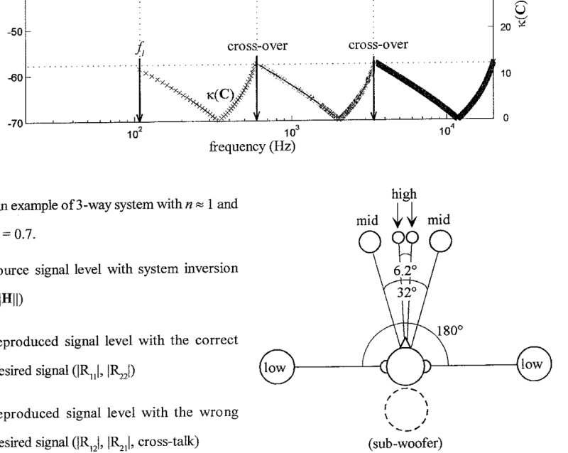

Patrick, in the first picture you have, the small speakers on stands, imo they are set up incorrectly. Too close, the listener is way too far back for this spacing. You get basically a small slightly better than mono result. So, put your orchestra or grand piano in that space, what do you end up with? Is that natural? Perhaps that is what a grand piano sounds like at a distance of 75 feet or so, etc... of course if you make it loud, in this set up it comes forward, but the size is still basically wrong from that listening position.
You did notice the low frequency woofers on the side of the listening position?
(A picture to make it clear)
No idea if this works, never had the opportunity to listen to this kind of setup.
But my gut feeling would say the same as you just said :). If you see the setup in the above picture it makes it more clear what Patrick said about those Dynaudio's on its side (and bent over backwards).

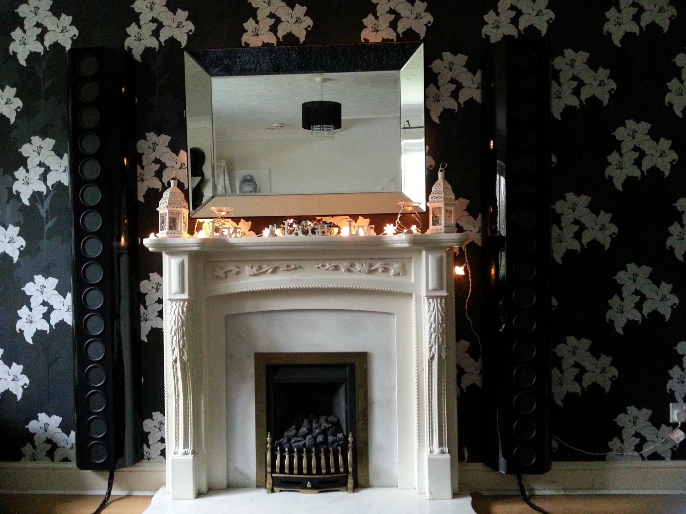

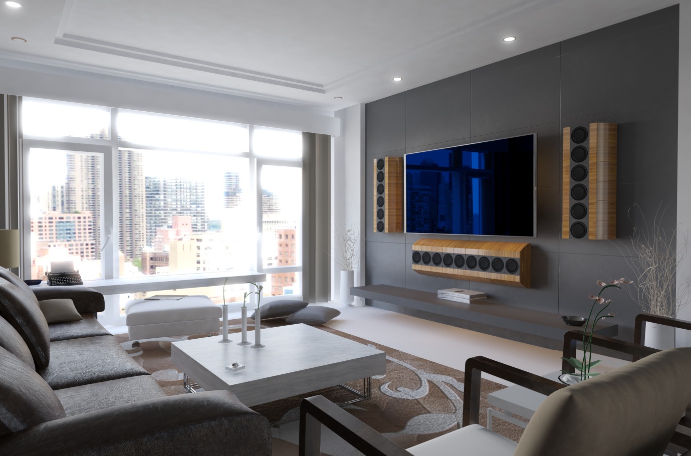

I hope to be ready to start a DIY kit of 32 drivers in the UK in a couple of months, price around £1,250 for the drivers.
Even the 6 or 9 drivers per speaker gives really fab results, with Sd of 67.5 a 9 driver line array has a greater surface area than a 12 inch driver...
I have attached a pic of the finished speakers.
Cheers
Derek.

It's actually on topic, as an Opsodis array isn't much different than a conventional multiway array... On its side!
