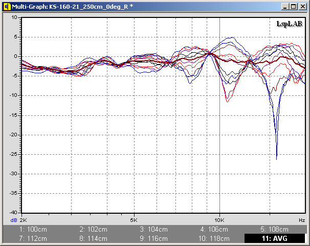

Kimmosto's line is 200cm high and rooms here at 250-260cm. I think it works as infinite line in a room. He doesn't show horizontals but says that there is bad lobing. Overall they were really good speakers, but didn't deliver the bass mode control that he wanted
That particular array (KS-160-21) has a tweeter line that is not floor to ceiling in length. The tweeter line isn't anywhere near 200 cm.
I've read a lot of material on line arrays and most boil down to this:
Floor to ceiling line array: not advised to use shading.
Shorter array: shading is needed.

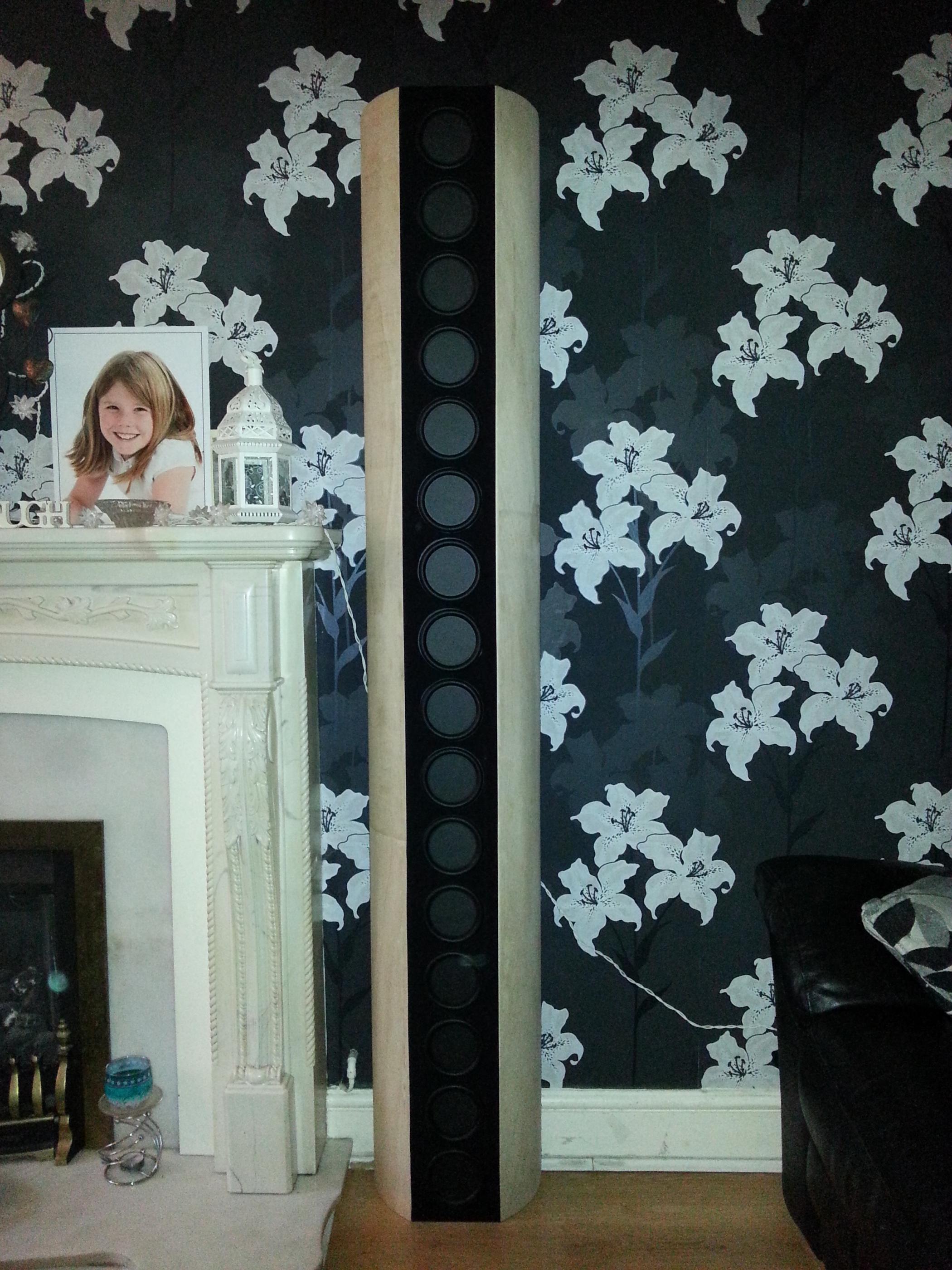

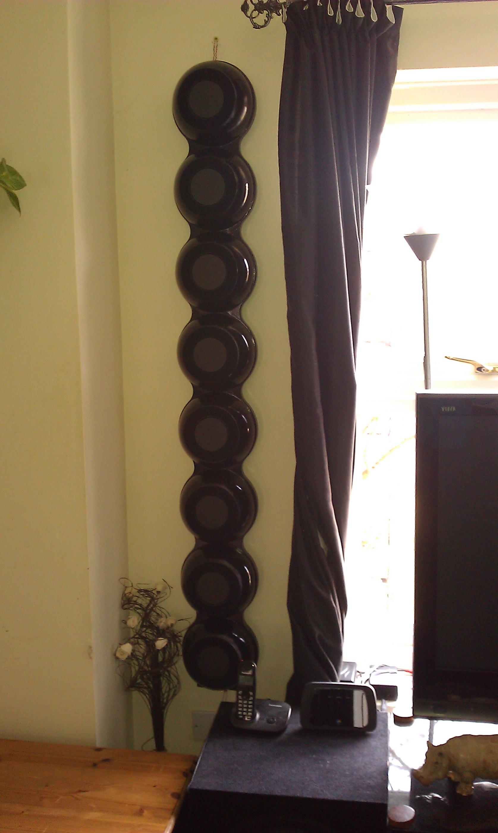

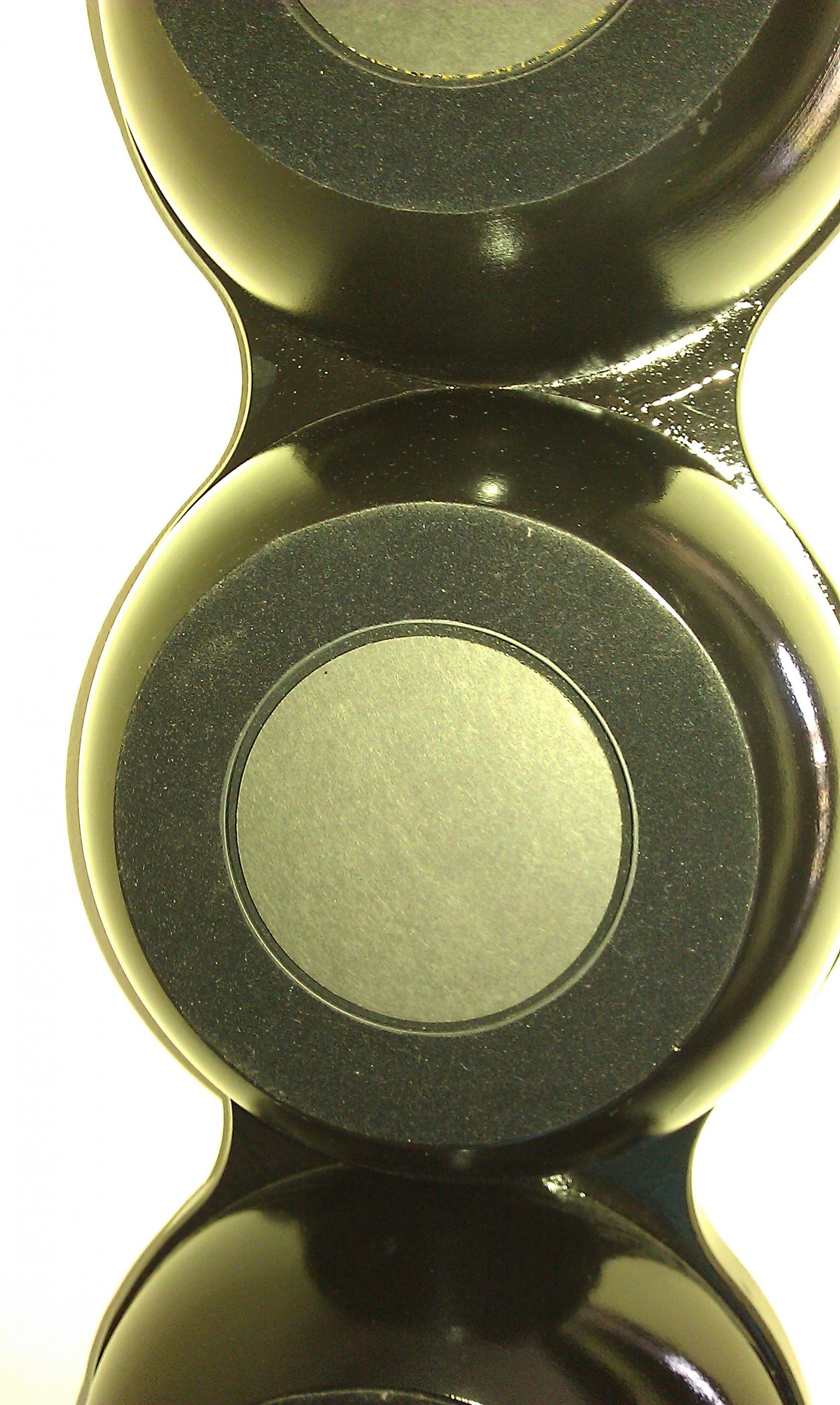

I am still experimenting with full range driver single column arrays (as well as twin and triple column ) and finding that one over riding factor counts more than any other.
When using full range drivers the power response is crucial ie A very even on and off axis response out to plus minus 90 degrees is the key.
Using a version of the 4.5 inch Neo magnet BMR driver I have been getting great results, esp when used in very shallow curved wall cabinets which can hang on the wall. ( See pics)
Also the min height is interesting....It is less important than driver choice for sure. But the 1.6m tall ( 8 driver version) sounded identical in terms of imaging, 3D accuracy, texture, detail etc Vs the 1.8m tall ( 16 driver version) , but the 16 driver version could go louder with lower distortion and was more sensitive....
All simply a function of more Sd... Double the surface area of cone moving and you half the distance it needs to move for a given SPL / distortion.
Even increasing the driver to driver centre spacing has no audible in room effects ( slight measurable differences) ie 112mm tight spacing Vs 210mm spacing with the dome array's.
The bottom line is that the unique ability of the BMR to sound and measure within a couple of Db from on axis to plus / minus 80 to 90 degrees ( giving almost perfect 160 to 180 degree coverage when wall mounted) is changing the way domestic line arrays can perform in real world rooms.
Still learning and experimenting but the sonic results are so good I am now in the strange position that I will have designed something that sounds better than anything else I have ever built and yet I don't fully understand exactly how it works...!!
Cheers
Derek.

Hi wesayso,
Not really , I have one pair of on wall arrays either side of the fire place which I use for two channel music, they fire across the short ( 4.5 meter width) dimension of the room.
Also have 2 more pairs in the same room for the home cinema set up, firing up and down the 5.5m length of the room.
I have had several folks comment that music still sounds great 90 degrees of axis ie on the home cinema sofa, and also guys on the two channel sofa still get a fab home cinema sound...
Don't think its Beverage related just very broad and even off axis coverage.
