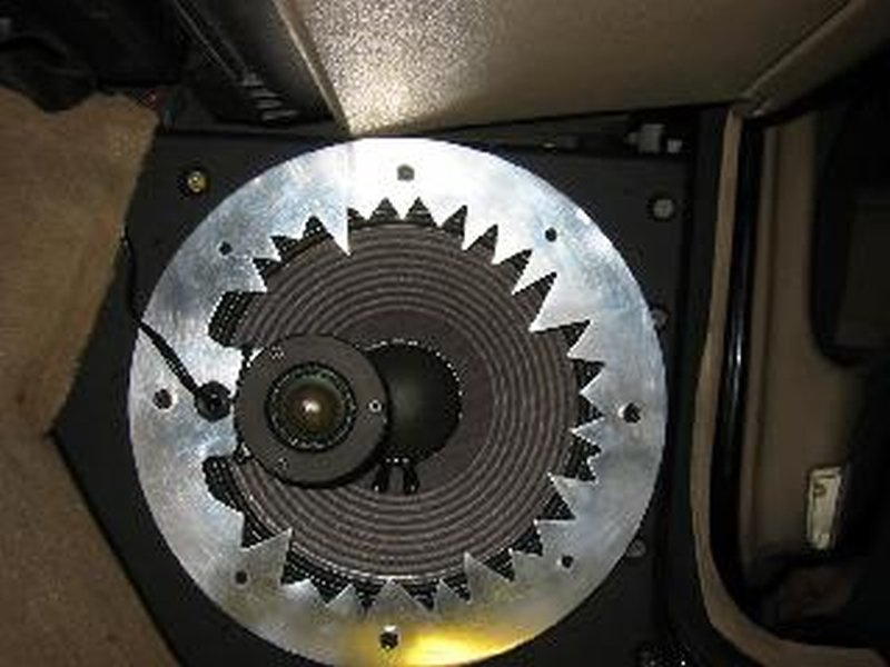

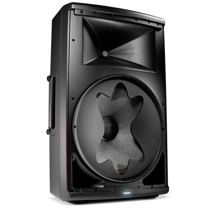

Yep. It basically makes the 15" woofer behave as if it was narrower, so that it's a better match for the waveguide. I wonder if Sprinkle was inspired by this:
That was in Douglas Winker's car, back when he was competing.
It would create diffraction, but then the polar response of a disk is caused by the diffraction of the edge of the disk. (And this diffraction would widen the horizontal polars.) Diffraction is not an issue when it is very close in time to the radiating wave. Its when it is delayed in time that it gets so audible.
This idea certainly isn't new, as I've seen it being used in car audio some 8 years ago to widen the polar to match a tweeter. That particular case had a irregular multi-pointed metal star mounted in front of the woofer for exact the same reason as it is being used in this JBL example.
The basic idea probably is even older than that, and just received a renewed interest from Sprinkle.
I get the why, I just doubt it is the most effective way to solve this specific problem.
Edit: 😀....John just beat me to it, that's the one, I do remember at least one more external link about it with even more info about that construction. I seem to recall this particular example was inspired by yet another example.
If you don't need the speaker to play full range, I literally can't think of any drawbacks.
Douglas Winker is the first to do it, as far as I know.
Then NEXO started doing it on their prosound speakers.
I don't know if Sprinkle copied Winker, or NEXO, or came up with it on his own. But it works.
It looks a little bit silly but it works.
I don't think diffraction is an issue because these wavelengths are long. The JBL is crossed over at something like 1500Hz. That's 23cm long.

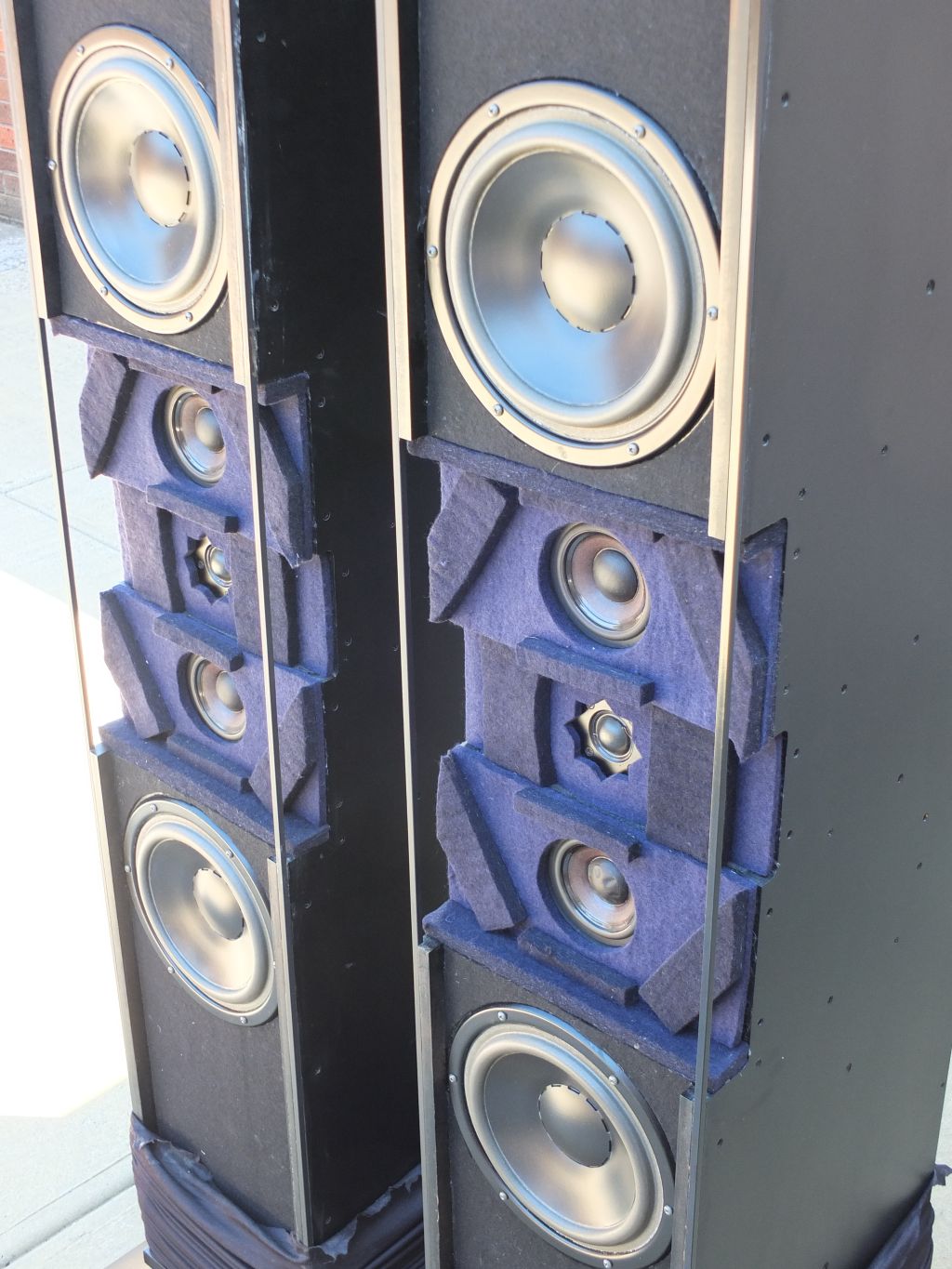

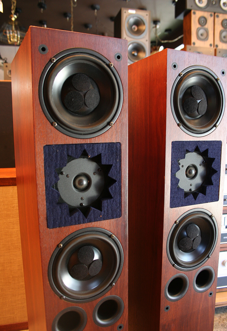

Duntech did something similar with HF.
I think there were models* where the 'star' was a lot smaller, and partially covered the tweeter dome ...but these are the best example images I can find now.
*maybe someone other than Duntech? - I'm digging up an old memory here.
