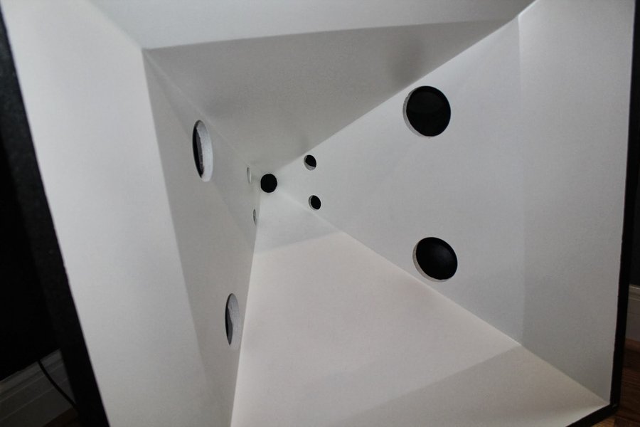

A synergy horn is very interesting, but I'm a little skeptical to the additional holes and how it might effect the impulse response, hence sound quality. Hard to say and probably dependent on the size of the horn.

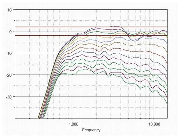

It's a tradeoff, no doubt. I was actually measuring a bunch of my waveguides yesterday to see which produced the smoothest frequency response.
The thing I noticed yesterday, which I think was interesting, was that the AXIS that you listen on seemed to have the greatest impact on the overall smoothness of the response.(1)
For instance, nearly every waveguide that I measured had the lumpiest response ON AXIS!

So one of the things that I've been doing with my waveguide designs lately is that I've been making them asymmetrical. And I don't just mean the beamwidth, the axis of the waveguide is asymmetrical too.
JBL DD55000 is the only speaker I'm aware of that's done this.
My thinking is that the *symmetry* of the waveguide is the reason that waveguides measure worse ON axis than OFF. So breaking up the symmetry should improve things, is what I'm thinking.
And the difference isn't subtle either; for instance the JBL PT waveguide measures about +/- 1.5dB on axis, but OFF axis it's about +/- 0.5dB!
I'm too lazy to dig up my measurements, but here's a measurement that Geddes did of his oblate spheroidal waveguide from the Abbey. Note how it's smoother off axis than on. That behavior seems to be typical of waveguides.
Of course, Geddes probably knew this, and that may have contributed to his setup recommendation, which is to listen to his speakers off axis.

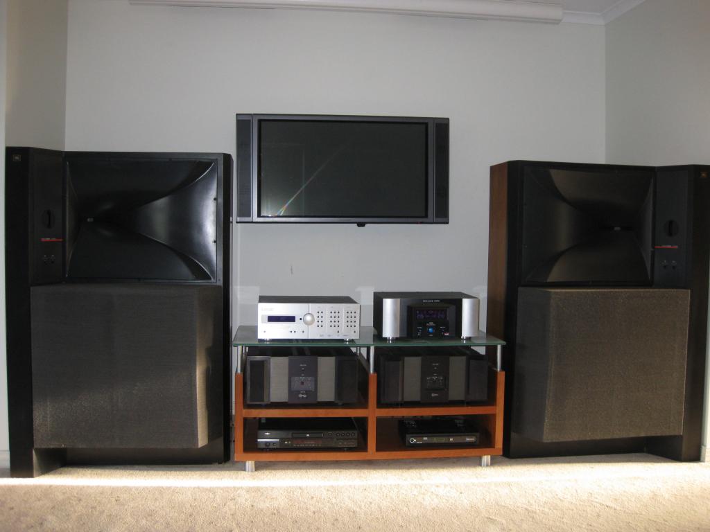

Charles Sprinkle wrote this about his "image control waveguides":
"“The Bi-Radial horn that we have had for decades was a 90x60 horn, and not the best match for the low frequency device in the M2,” Sprinkle says. “This horn is 120 degrees horizontal and 110 degrees vertical. We knew that if we wanted a good directivity transition between the woofer and the high frequencies, we had to have that amount of pattern, so the waveguide was designed to have a pattern consistent with what the woofer was doing with no discontinuity at the crossover point, which is 800 Hz.
“The second thing we did was use a blending geometry—there are no straight lines, you’ll notice—that has a generally decreasing radius,” he continues, “forming an infinite number of reflections, and the net effect is that it smears the reflections coming back down the horn and negates them."
Seems like an example of moving away from a true high-end solution IMO. They could have used a midbass horn to match the directivity of the older bi-radial horn. But obviously that makes it too big to market.
The polar response of the bi-radial horn used in JBL monitors 4430 and 4435 were almost perfect. The M2 and PT waveguides are clearly a step or two back in the power response. Even with a 1.5" exit driver, they beam more than the old horns with a 2" exit and are generally less even. But they measure better on-axis. Some of that might be related to the driver though.
Getting both a flat on-axis response and a great polar seems to be a conflicting matter in a horn. The question is how much is minimum phase behavior, thus can be EQed.
