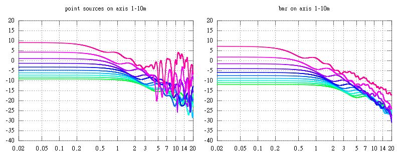

I have not had a convincing demo of any software that can accurately predict the BMR as point source, never mind as a line array or panel....
I cannot really simulate BMR because I have no idea how the membrane really behaves but I have compared a line source of 16 aligned point sources and something like your BMR16 simulated as continuous sources of 6cm diameter with 4cm between membranes.

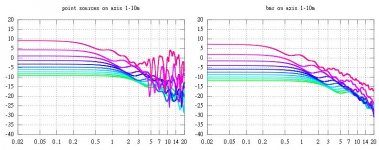

Here on axis between 1 to 10m distance.
Extra data on a CSS BMR driver
BMR is really just another cone loudspeaker hiding behind a flat diaphragm. I'm sure the usual breakup modes still apply. Simulation via a series of point sources is probably the most realistic look at these.

The driver I simulated is an ideal driver consisting of 49 point sources with each flat frequency response. The simulation of 16 drivers, 784 sources in a finite line, with some separation beetween drivers, gives the frequency responses of the picture. As Dave said, those curves are quite characteristic of line arrays.Thanks for trying, but that driver ( what is the spec?) looks pretty bad to me!
Thanks!
Are you sure this apply to a virtually infinite line source as well? I guess so. Then there will be no such thing as a "cylindrical wave front".

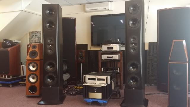

I had a question about the MTM array in your avatar, from the Snell XA90PS speaker. This morning I was doing some tinkering with MTM arrays and it appears that the "eXpanding Array" can be flipped on it's side.
The reason that I say this is because the spacing between the tweeter and the midrange is much tighter than in a conventional D'Appolito array; the spacing appears to be about one-third or one-half wavelength.
It looks like you could use some delay, adjustment of phase, or both to achieve a polar response that's basically free of vertical lobes.
And if you can do THAT, then you can flip the array on it's side.
Thoughts?
I'm picturing something like the eXpanding Array, but horizontal.

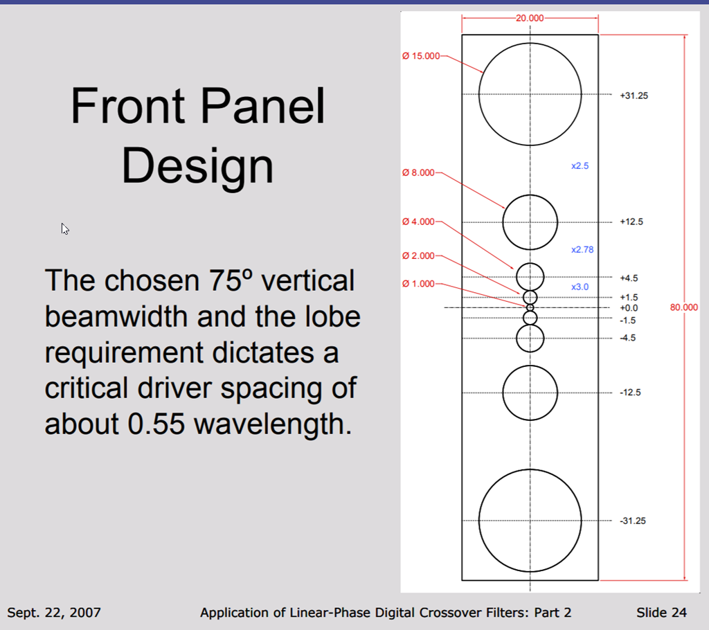

I took some inspiration from this interview here:
[Interview] David Smith [English]
"The eXpanding Array was a concept I came up with afterwards while at Snell. I suppose the systems were an evolution of work I had done on THX certification. THX was pushing higher vertical directivity but most of the licensees would just stack a pair of tweeters, or perhaps 2 tweeters and 2 woofers. The axial response could be fine and the directivity was higher, so room effects would diminish somewhat, but the response as you went off axis was a mess.
It was important to me that I achieve a system with smoother directivity and without the usual response nulls off axis. At Mac I did a THX system with 3 tweeters in a short row, not a line array so much as just a short multi-element array. If the center tweeter was used for its full range and the outer tweeters were progressively rolled off I could get something that was lobe free. It was directivity without “pain”. At Snell I just extended that over a number of sections and a wider frequency range. I was using Peter Shuck’s early Xopt crossover/system modeling software and was finding ways to stack elements tight and roll off each section in particular ways that gave very well behaved directivity. I found I could achieve flat response on axis, less than a dB or so droop at +-15 degrees vertical and a totally uniform 6dB or so shelving at +- 30-40 degrees. This was exceedingly well behaved. In essence, with the smooth transition from the inner tweeter to adjacent mids, to surrounding woofer, you are making a system that has an effective length proportionate to radiated wavelength. Looking for a marketing hook, we called it an eXpanding Array, meaning that its effective length expanded as you went down in frequency (that seemed more positive than it contracting as you go up in frequency!)
So with JBL I worked with constant directivity wave guide devices, at McIntosh with medium and long line arrays and at Snell with highly optimized symmetrical arrays. Of the 3 approaches I think the symmetrical array is best. Response is very well behaved and the directivity increase is about right, not as extreme as it is with the long arrays."
A picture is worth a thousand words, so I made one. <snip>

This is the Snell XA Reference Tower
In my post from a few years back, I'd stated that the center-to-center spacing was 16cm and the crossover was 2400Hz. I no longer believe that was accurate.
I believe the center to center spacing is 18cm and the crossover was 2400Hz. That's a small difference, but these arrays are really picky about their spacing, phase, and crossover. If you're off by even 10 or 20% it'll screw up your polars.
The reason that my spacing was off in the original post is because the Stereophile article stated that it was a 4.5" midrange. But I don't think this is the case; I believe it's a FIVE inch midrange, likely this:
https://www.falconacoustics.co.uk/downloads/Vifa/PL11WG09-08.pdf
The reason that I think this is because Vifa doesn't MAKE a 4.5" midrange! (AFAIK.) You would think that the "PL11" midrange would measure 11 centimeters, or 4.33", but it actually measures five inches across.

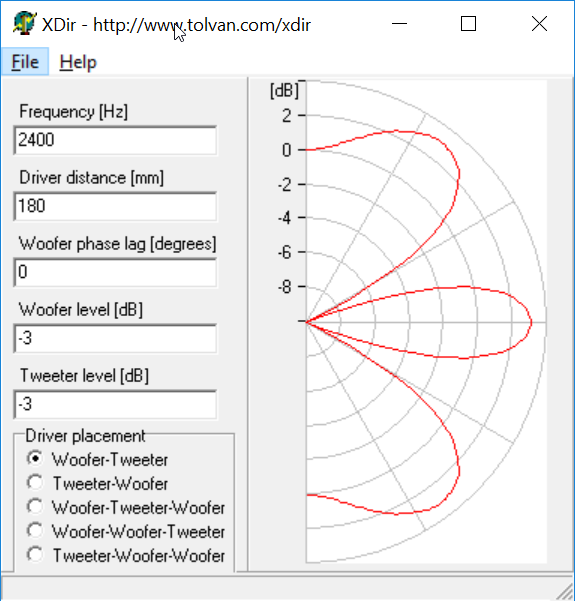

So the thing that I can't figure out is how the Snell works, when the side lobes are fairly nasty. The pic above shows what the vertical polars of the Snell look like, assuming a spacing of 18cm and a crossover of 2400Hz. The vertical beam is nice and narrow, but the side lobes are fairly brutal.
The Horbach Keele speaker uses a crossover that's virtually identical, but much tighter spacing. The tighter spacing reduces the severity of the side lobes of the array. (I believe the Snell spacing is 18cm; the Horbach-Keele spacing is 4.5cm.)
I think that animations are really handy to visualize this. The animation above shows what happens as the spacing gets tighter and tighter and tighter. The side lobes get less severe, and eventually the vertical beamwidth gets wider. But note that the units have to be REALLY tight for the vertical beamwidth to become particularly wide. Even with a spacing of just 25mm there's still a narrowing of the vertical beam.
I can only speculate, but I'm guessing that David Smith was aware of these limitations, and may have been constrained by a lack of good small midranges. Twenty years ago, they were quite a rarity. That all changed as TVs got smaller and smaller and smaller and now we have a plethora of great 2-3" drivers.
The succeeding Snell speakers switched to a midrange that's half the size.

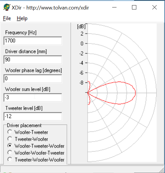

Good news, I answered my own question.
Here's an explanation:
In the previous post, I wondered how the Snell speaker could function properly, when the spacing of the midranges indicated that it should have a vertical polar response like this. Obviously, this isn't so hot.
There's a clue in David Smith's Stereophile interview:
"The one breakthrough was finding a high-output, low-resonance tweeter from Audax that has a compact-diameter magnet structure. By rear-mounting this driver on a computer-cut aluminum MTM plate, the Vifa midrange units' driver baskets can overlap the tweeter's metal frame to keep the center-to-center spacings minimized."
So that was the part that I missed:
I was focused on the beamwidth of the dual midranges, but ignoring the contribution of the tweeter.

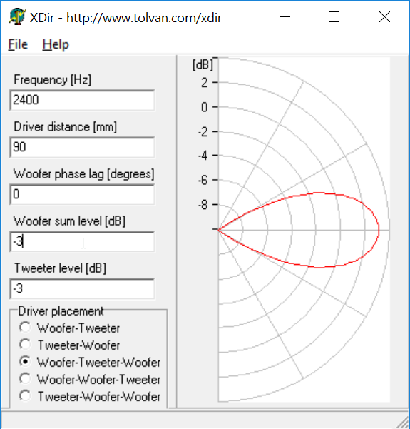

Understanding that difference, we get the following:
This is the response of the Snell MTM array at the crossover point. Nice and narrow.

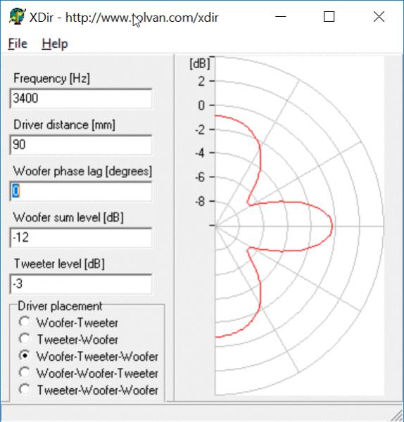

This is the response of the Snell MTM array at one half octave below the xover point. Still nice and narrow.
This is the response of the Snell MTM array at one half octave *above* the xover point. Things are starting to get weird here. Shaping of the response shape and the phase of the three drivers will be critical above the xover point.
To help illustrate the last point, here's an animation that shows how the beamwidth changes when you vary the phase. It changes a LOT! I'm starting to understand why the Horbach Keele speaker uses FIR filters, it allows them to control the beamwidth by varying the phase. Back in the bad ol' days of passive crossover design, you would have to try a combination of crossover slope and physically delaying the radiation by setting back the tweeter to control this behavior. A real can of worms it looks like. Hooray for cheap DSP!
