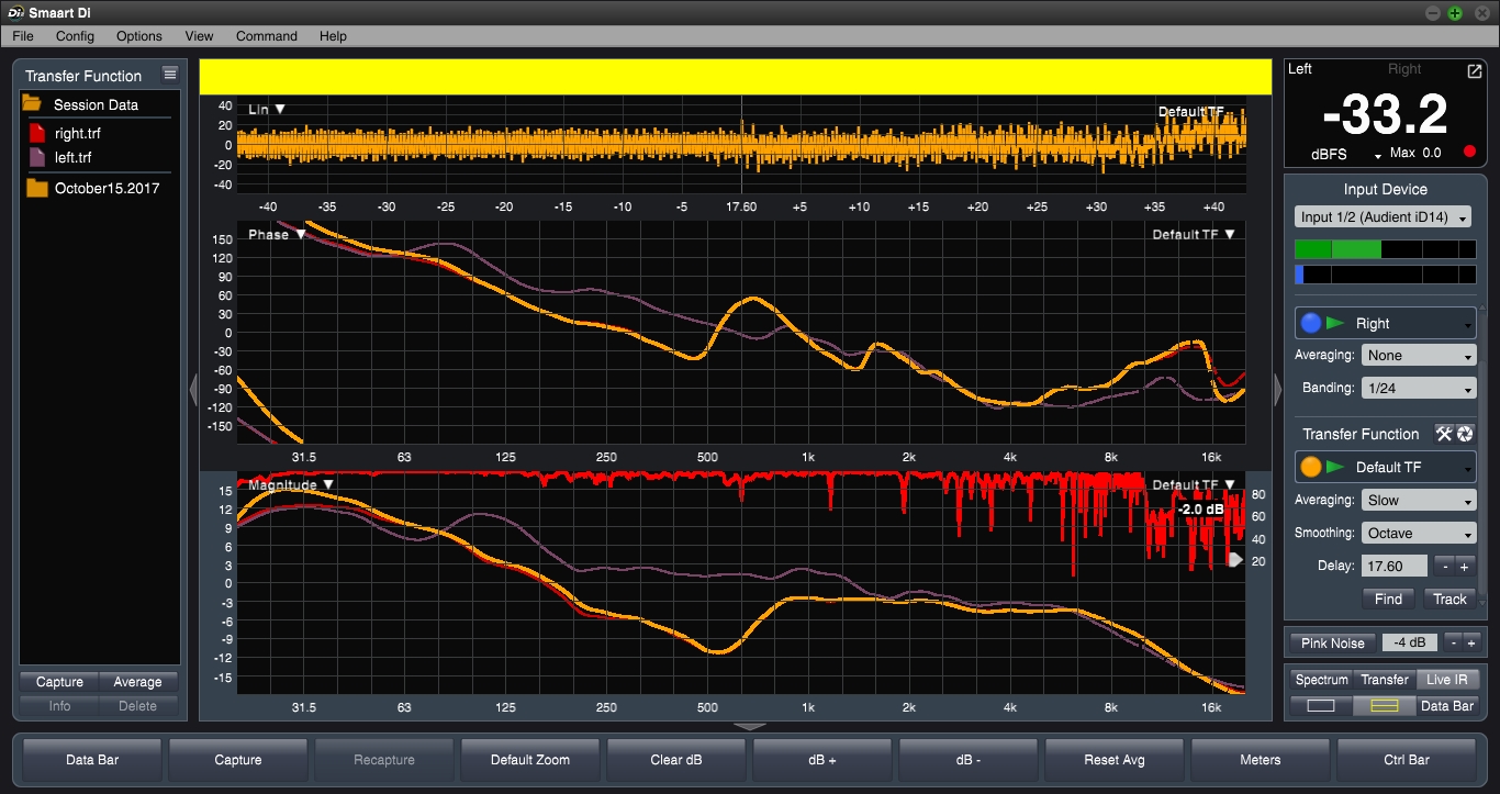

In-car you really need to watch EQ thru fingers. Dual channel FFT helps a lot rather than just measuring distances. There is lot going on, theres different slopes, maybe mixed if different amps.In the car audio world, during the last 10-20 years people have gone nuts with DSP. <snip>
For basics i take close measurements from high and mid, eq applied, minimal to none eq to drivers seat
example, you really cant eq that 500hz cancellation

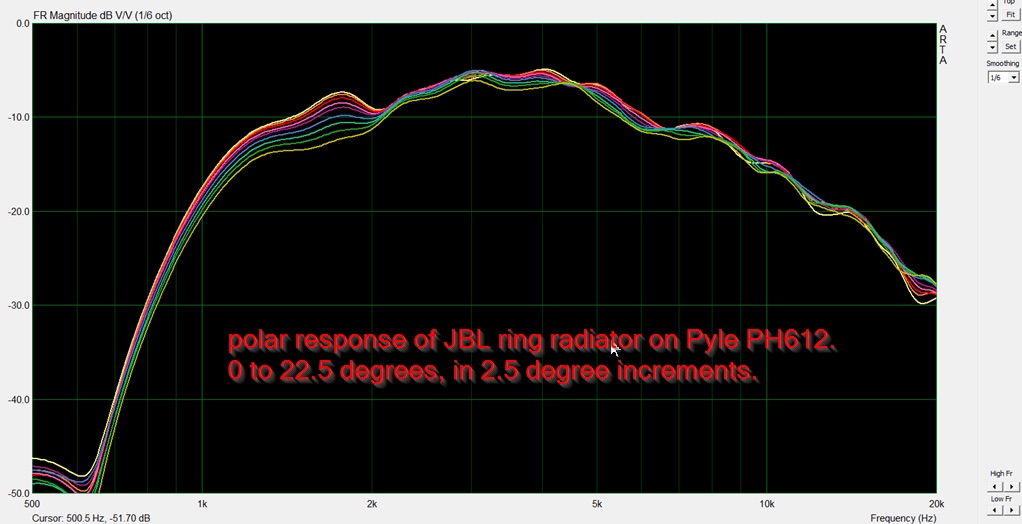

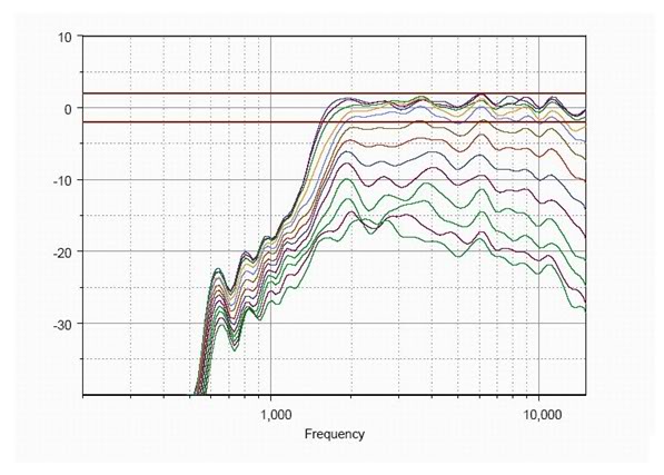

Can you save me a lot of time and just tell me straight away which waveguide/horn (exact model) is best, regardless of size? 🙂 (speaking as someone who might build wg-speakers one day)
I like the JBL progressive transition waveguides quite a bit. First measurement above is a measurement that I did with that waveguide and a JBL 2408H-1. That's the same compression driver that JBL uses in their commercial designs, so if you don't feel like DIY'ing it, you could get very good performance by simply buying their speaker imho. I've heard the newer waveguide/CD combos are even better. Check out the JBL 705 and 708.
The 2nd measurement above is one that Geddes did of the same waveguide but with a Selenium D220ti compression driver. Geddes included CD EQ with his measurement, I didn't.
I don't remember doing that and to my knowledge I have never had a Selenium D220ti. Could it be something else? That format of data is very very old > 12 years, so maybe I forgot.
