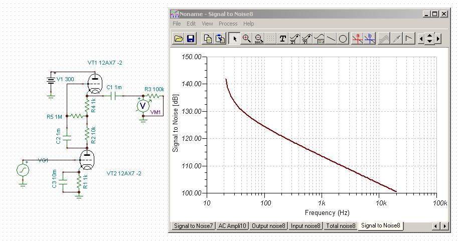

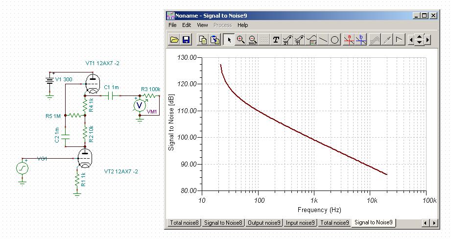

Some quick simulations show that the EIN of a mu-follower is OK, because it is equivalent to a gain stage followed by a cathode follower, so the gain stage dominates as usual. An SRPP (lower cathode bypassed) was worse by 1.2dB. These all assume identical triodes operating under identical anode current and bias voltages.
Thanks, Merlin. I am curious have you added your noise model to existing models of tubes, or it is separate "tube noise" component? Could you explain or/and post your SPICE here? Thanks!Some quick simulations show that the EIN of a mu-follower is OK, because it is equivalent to a gain stage followed by a cathode follower, so the gain stage dominates as usual. An SRPP (lower cathode bypassed) was worse by 1.2dB. These all assume identical triodes operating under identical anode current and bias voltages.
What did you use to bias the lower cathode of the mu-follower?
Bypassing the lower cathode biasing resistor of a mu-follower appears to increase the SNR by a lot.
I simply added a current source in parallel with each triode, set to generate a 2nA sine wave (a typical figure). For resistor noise I used a voltage sinewave source in series with the relevant component. Then I monitored the output voltage signal when each individual noise source is present in turn, then take the root of the sum of the squares to find the total that would exist if all the noise sources were present.Thanks, Merlin. I am curious have you added your noise model to existing models of tubes, or it is separate "tube noise" component? Could you explain or/and post your SPICE here? Thanks!
Noiseless battery (i.e. fully bypassed).What did you use to bias the lower cathode of the mu-follower?
