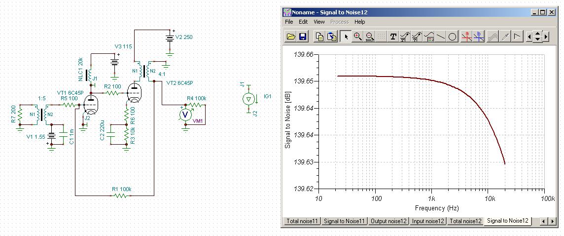

I simply added a current source in parallel with each triode, set to generate a 2nA sine wave (a typical figure).
I can't do that in Tina because it won't allow more than one source. Oh well. Thanks anyway.
Do you need more than one? You probably need to examine only one source at a time anyway... (I use Tina too)I can't do that in Tina because it won't allow more than one source. Oh well. Thanks anyway.
I guess not. It can become labor intensive to do one tube at a time, depending on how many you have. I'm still getting unrealistic results using this technique. With the input shorted by a 200 ohm resistor and one 2nA current source in parallel with one tube in the circuit I'm analysing, I'm getting 140 dB SNR, which isn't possible... Maximum should be 129 or so. I guess I don't understand how to use Tina very well.
The current sources would need to be set to produce an actual noise signal, rather than a sine wave, for the SNR feature to understand them. I don't think you can do that.
If you want to use the SNR feature then you're probably better off inserting a resistor in series with each grid, to serve as an equivalent noise resistance for each tube. Something between 500 ohms and 3k ohms is realistic, depending on the tube you will use. This won't model the noise spectrum correctly (no pink noise), but if you just want SNR it's OK.

OK, that works. Thanks.

example of 6S45P with noise
