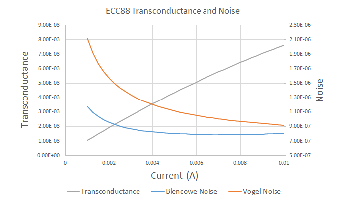

I think the best methode to model tube noise was outlined by Merlin on the ribbon-mic thread, you use multiple voltage and/or currrent sources with their respective equivalent resistances then run the simulation to get the sum for the total noise - in effect, you deconstruct the tube model into seperate parts to account for the various types of noise.
Figure 6 in the article relates Transconductance and EIN voltage with Ia for a 6J52P.
Taking the data from the Phillips data sheet for 6922/ECC88 (sigm =0.6, K=6.2*10^-14, and plugging the numbers into Eurequa I get a simple quadratic equation which relates transconductance to current. From this I derive the equivalent resistance with current (Vogel uses a static value and assumes that the two triodes are connected in parallel.)
I added in the grid load resistor noise, for both, but it can be eliminated. (This is why the graph differs from figure 4.)
