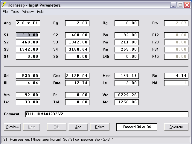

I am going to try to show some early work here if I can figure out how to link an image. This HR response is from a smaller ~550ish liter or so horn than I am planning now, using my IDMAX12 driver. I decided this cab was terribly inefficient and I could do better by making a larger cabinet. Its ugly on the bottom and top and very weak looking. So I scrapped that design and am now starting over from scratch. Target size is now larger at 4' x 8' x ~2'.

If your goal is high sensitivity and using the least amount of power possible a tapped horn might be a better option as weltersys mentioned.
4 x 8 x 2 feet is incredibly large for a single 12 inch driver. That's not a bad thing but there is definitely a point of diminishing returns, and if you want to be able to move the thing you might want it to weigh less than a metric ton.
Yes, add 20 - 25 percent to the sim volume to account for wood and extra space in folded corners and stuff.
Assuming you were showing your 550 liter horn at 1 watt it looks like you are on the right track. The response looks fine, it won't look so weak if you get some boundary reinforcement from a wall or corner.
To do initial proof of concept for a flh for a given driver I usually throw it into a hyp/ex sim. This can't be easily folded (it would need to be an Od sim with PAR segments in order to fold) but this gives a really quick idea of potential performance.
Shown here with low compression ratio in 568 liters with 1 watt using the specs you posted. Very close to your sim, so you are on the right track.
Don't forget to sim at xmax (or power max, whichever is the limiting factor) with high pass filter in place if that's how you intend to use it.

Driver specs [2 mH Le assumed] not suited for a ~18-60 Hz pass-band, so FWIW: a mouth area to fit a 2x4 ft area and theoretically small enough to fit in your box with probably some room to spare for damping, mass loading, so quite a bit bigger than JAG's with of course a bit more output, lower CR, group delay, etc., due to more acoustic damping, larger rear chamber.
Note that pass-band ripple will be very muted in reality, though the room will chop it up pretty good.

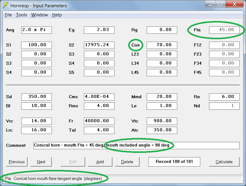

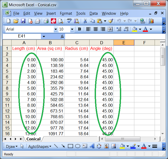

Fta is the flare tangent angle in degrees at a specified point along an axisymmetric horn. When shown on the Input Parameters window, it is the value at the horn mouth.
Attachment 1 shows a conical horn with a mouth flare tangent angle of 45 degrees, which means that the included angle of the horn is 90 degrees.

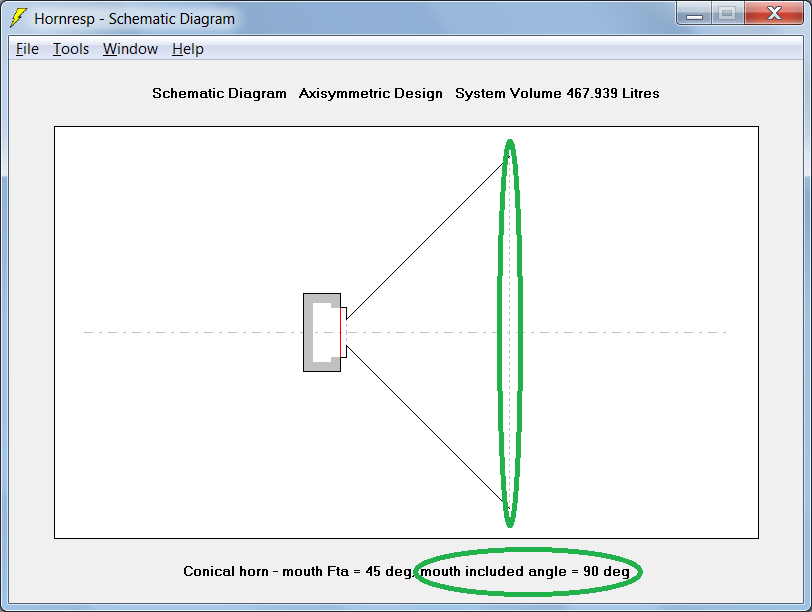

Attachment 2 shows the axisymmetric conical horn with the 90 degree included angle (i.e. a right angle).

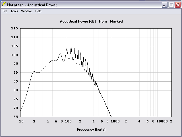

Attachment 3 shows an extract of the exported data for the conical horn. As expected, the Fta is 45 degrees at all points along the horn.

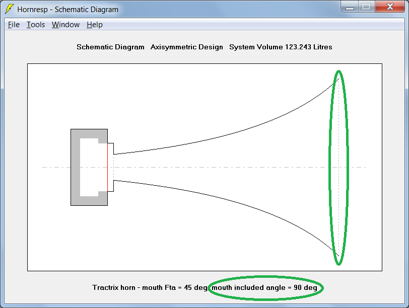

Attachment 4 shows a tractrix horn with a mouth Fta of 45 degrees.

Fl and Fh are fine for a 18 - 60 hz bandwidth but you get weird results with Leach's math when requesting that bandwidth, a very low flare T and an enormous throat. But a 18 - 100 hz bandwidth looks great, a regular flare T and just a bit higher than 2:1 compression ratio (which would be less when folded as offset driver).
Regardless, your horn is better in every way than the one I posted. But it's almost 3x larger. Is that extra size worth it? If the wood was free (or at least cheap) and it was a permanent build in then maybe yes. But if it's meant to be mobile I would say absolutely not.

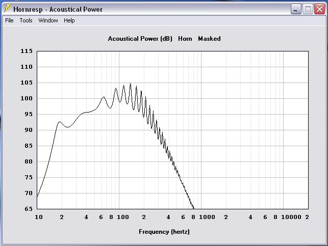

Here's a quick comparison, your design and mine overlaid. I changed your power to 1 watt and your Rg to zero to match mine and make things fair.
Yours has a bit more sensitivity but it takes more excursion. Both are to be expected since yours is 3x larger.
Now here's what it looks like at claimed xmax with high pass filter in place. Both designs require a slightly different hp frequency, yours takes 700 watts to hit xmax, mine takes 1000.
Your design will suffer less from power compression and is better in every single performance metric. But it's hardly practical and it doesn't beat the 3x smaller design by very much.
