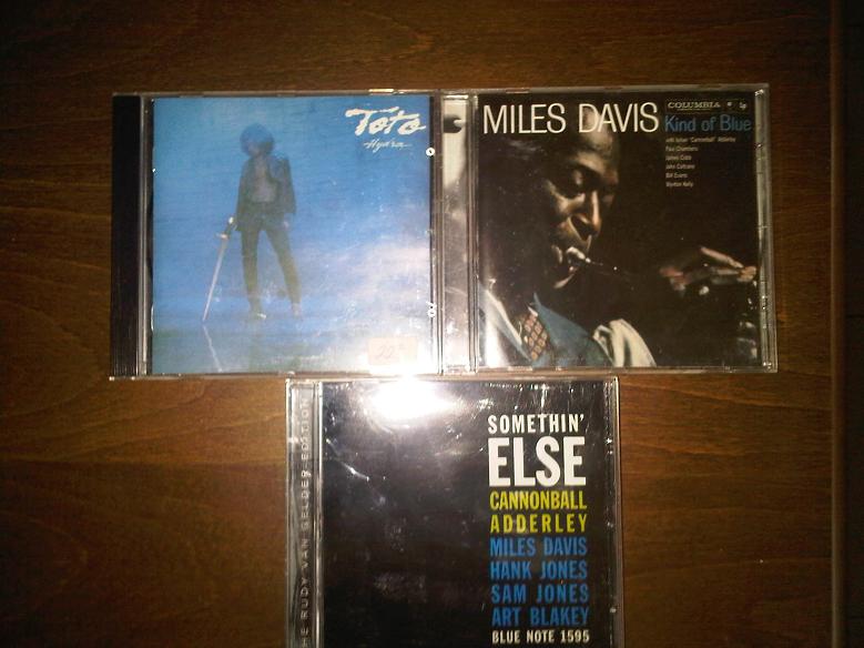

Checked and confirmed! - see attached image - especially the Miles Davis CD has HF souds recorded at levels as if to be reproduced for partially deaf audiences or through vintage extended range drivers. Both my Miles Davis and TOTO CD's are on the list.
The TOTO CD has more correction in the upper mids - around 1.5-2 to 6-7 khz
I think that has something to do with the HI-FI standart for allowed maximum distortion where the curve for the level of the distortion looks like a BSC electrical curve - less allowed distortion at higher frequencies, although it is about frequencies up to no more than 8 khz (because 3rd and second harmonics would be well out of the audible range for highed frequencies)
And probably the de-emphasis curve is a relative of the RIAA correction but with different shape.

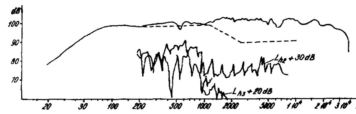

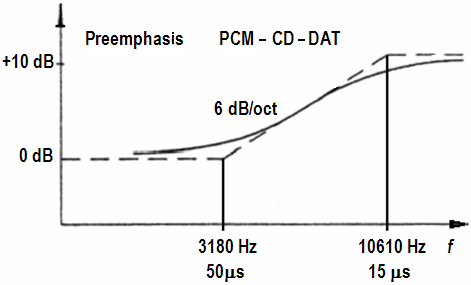

CD & DAT use a 15/50uS pre/de-emphasis curve.

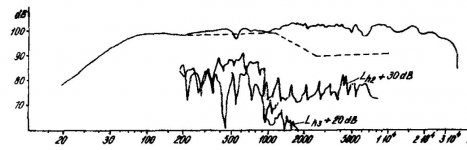

And here is a rare occurance of the DIN HiFi standard actual parameters - in this case the upper limit of the permited distortion in a loudspeaker...
Look familiar? 😉
A measure to reduce distortion and noise to some accepted level?
What are you playing the discs on though ? In theory if the player supports de-emphasis the end result should be balanced. Most CD players will do this correctly, but it seems that some PC software will not apply de-emphasis when ripping, with older versions of Exact Audio Copy being fingered as one guilty program - even though it has the ability to report the presence of the pre-emphasis flags on the disc, while iTunes silently does digital de-emphesis if necessary when importing.
So depending on what software you use, if you're ripping CD's to a lossless format like FLAC and then playing them back it's possible that these will be uncorrected and have far too much treble. The difference should be obvious when compared with the same disc played on a compatible CD player though.
As bolserst posted, the pre-emphasis curve is vastly different to RIAA equalization on vinyl, essentially the bass is flat, the response starts to rise near the middle of the midrange, and has risen by about 10dB at the top of the treble range.
1. A 20+ yar old Sony 2x something, a DVD-SACD player Pioneer 6xx something and a Yamaha 993
- Will investigate the exact issues of the CD's - in theory they are original and ordered directly from the publisher, but in practice they might be re issues using unknown master source. - will investigate thoughly as it gets more and more interesting for me.
2. I used "d Relative" for a curve that modifies the energy distribution (balance) across the audible frequencies without discrimination for the actual material ecorded and without relation with the initial energy distribution.
- The resulting energy distribution is just a sum or a product or etc. - a universal and constant correction curve.
