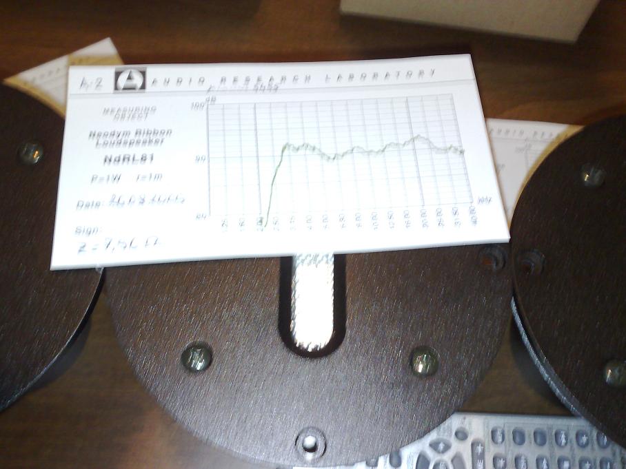

I can still hear above 20 khz, so if I may, I will consider myself a reference listener. Almost 29 years old to be specific.

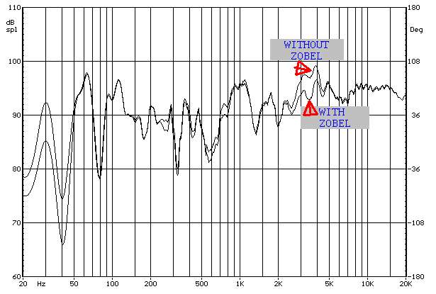

When I designed the crossover of my so far best speakers, I switched several HF attenuation resistors and tried several crossover slopes and ended with 3rd order electrical crossover and 1 ohm series resistor.

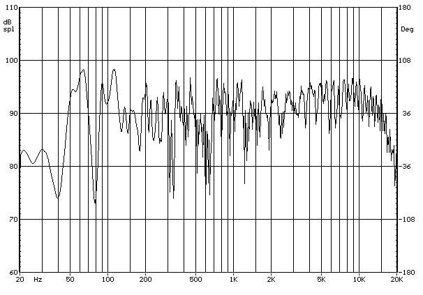

Below you'll see a FR taken in laboratory conditions (the certificate that comes with the driver), unsmoothed off axis response taken in small room (16-17m2) and smoothed off axis FR taken in the same room.
Note that on the smoothed and unsmoothed FR's there are two HF drivers working together (back then I wanted a 300+ w rms system with near field of at least 4m so i seeked for some sort of directivity.. - that's another story).
So back to topic... I listened to the slightly padded ribbon tweeter for several months like that - mean sensitivity of the system above 150 hz is about 89-91 db/w/1m all the way to 40 khz... and it's OB up to 10 khz.
