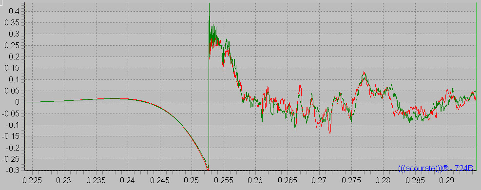

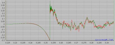

Hi, I went through all this with very serious blind testing, with my DSP-equalized system (true dipole in the bass, 15" PA coax driver) where I can introduce arbitrary additional phase shifts further to the minimum phase bandpass target equalization (50Hz...18kHz, sloping down 3..4dB overall, so much for the "flat" part again not being acoustically preferable in a specific setup). There are definitely differences when I phase-EQ a 4th(6th)-order rolloff to minphase as a BR(with HP) would do, compared to a mixed phase rolloff of resulting second order nature (not to be confused with a second order amplitude rolloff which sure sounds different per se).What are the implications as far as the audibility of group delay in a reflex box? If I am understanding this correctly it seems to imply it would be a non issue with boxes tuned below 50 Hz as many are.
Yet best balanced in timbre and perceived "compactness" of bass signals (drums, bassguitar, etc), as I found, is a fully linphase phase "rolloff", eg, none) together with a 4th-order amplitude rolloff at least at 50Hz or any lower/flatter the better. The changes are subtle but not completely irrelevant to me, and indeed differences from other reasons, may still be more significant (when I phase-linearize my small 50Hz BR monitors with their 6th-order rolloff they still don't get the bass right from inherent design problems, it remains just less bad, compared to my main system).
A problem with the full linphase highpass target is the leading "pre-echo" slope in the (symmetrical) step response -- see pic -- which sometimes makes itself audible with very strong, very low frecuency signals (in electronic music). Therfore I could use a phase-EQ that gradually reverts back to minphase on the way down from f3 to DC. Additionally I could try to generally roll back the phase around f3 more than linphase to compensate a bit for any typical minphase low-cut in the recording process... I fully agree a level of rapidly diminishing returns is reached here (except for the fact that changing absolute polarity then even becomes more noticable than before -- related in the same way to the result as phase shifts do : related to the half-wave rectifying fashion the hair cell's neurons seem to fire).
Other aspects of a speaker make more to good or bad than that.
- Klaus

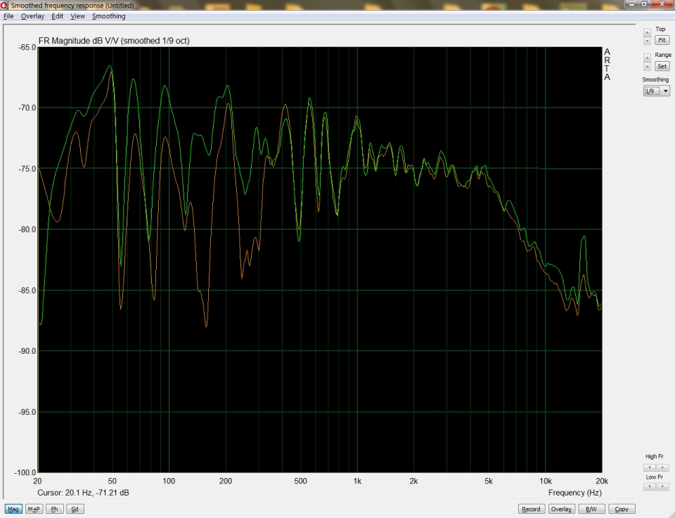

I have found a location where helper woofers 'help'. They are placed part way between myself and the mains on the perimeter of the listening triangle closer to the speakers. I believe that perhaps at least half of the sub 300Hz anomalies are floor and ceiling related.
Subjective thoughts are that this is better. EQ or no EQ, it simply sounds better. No amount of EQ could seem to fix the mains only result to sound as good.
What is the crossover frequency of your woofer? Does the biggest cancellation frequency half wavelength distance (5.6 feet for 100HZ for example) correlate with the distance between the main speaker, the listening position, and/or any particular room boundary, especially a corner? It makes sense to me that the lower midrange and bass cancellations could be largely filled in by "flanker" speakers, which because of their different distances to these things, would have different cancellation frequencies, and therefore when added at the listening location, would largely fill in each others cancellations. It might be worth trying adding a 3rd woofer in a corner or against a wall, some distance up the wall, to accommodate the 3rd axis in the room. Wouldn't it be nice to get back "acoustic fidelity" in the lower mid and bass at the listening position, and perhaps everywhere in the room, so when we turn up the bass on our preamp (which of coarse has tone controls), it would only sound warmer and better... No real boom problem...
These are crossed at 300Hz. The subs are off so ignore below 100Hz. The issues here are the dip at 140 and 250. The 250 dip is composed of the 1st floor and 2nd ceiling cancellation. The helper woofers happen to be a half of a wavelength closer to me than the mains at 250Hz.
As you are saying, it does seem to return fidelity. There is no noticeable boom...although you can see on the plot there is a peak at 200Hz and I can hear that and I'm thinking of notching it.
I think what we perceive as boominess is really the uneveness of the lower mid and bass region. Any high points can and should be EQ'd down, but if you try to bring up a cancellation, you end up causing peaks in other locations of the room, so that is not recommended. I think flankers of some sort may be the only way to even out those particular boom causing cancellations.
