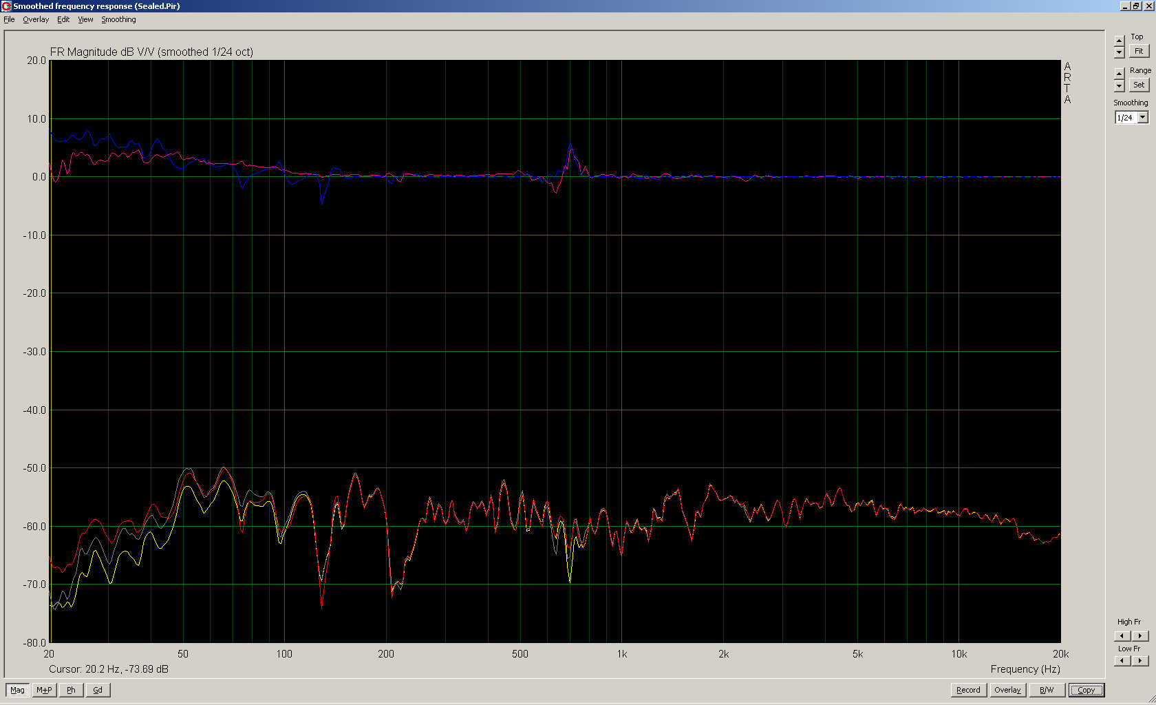

Conveniently I happen to have cabinets with ports on both the front and back so I took a few fresh measurements. One is on the front just below the midbass driver, one is on the back in line with where the tweeter is near the top - both are diagonally symmetrically placed within the box and are the same length and diameter. (At the moment the box is lying on it's side so they're both actually at the same height but the front one is closer to the side wall...)
Normally they are both in use giving a box tuning of 43Hz, but if I block one or the other the box tuning shifts to around 32Hz, however the important thing is the tuning is the same whether the front or rear port is blocked, leaving the only difference the physical location. (I would add that this low tuning is a very non-optimal "droopy" response for this driver and box size, but it shouldn't matter for this test)
The speaker is in it's normal location but this time the measurement position is only about 1 metre in front of the speaker. Our old friend floor bounce is very much in evidence here at this close measuring distance at 210Hz, and the notch at about 130Hz will be either floor/ceiling 2nd order mode or boundary cancellation from the rear/side walls...
In any case, we have the following measurements. Yellow is with both ports blocked giving a baseline response as a sealed box, grey is with only the front port open, red is with only the rear port open. It's hard to see exactly what's going on due to all the boundary induced peaks and dips but it's apparent that the rear port has more output below about 45Hz, and they really start to diverge below 30Hz.
At the top of the graph I've normalized the results to the sealed box case, so purple is the relative gain from sealed box to front port only, while blue is relative gain from sealed box to rear port only.
Points of interest:
1) The purple line shows what we would expect from a bass reflex response relative to the sealed response - gain above the port tuning up to a maximum of around 4dB, starting to fall away at and below the port tuning - around 32Hz here, and falling below the sealed response at around 21Hz.
Normalized "gain" from the front port appears relatively smooth, because the front port is right next to the woofer and experiences almost the same room/boundary loading as the woofer, so any peaks and dips induced by the room tend to fall at exactly the same frequencies, and don't show up when normalized.
2) The dark blue line shows the normalized "gain" of the rear port. The first thing immediately obvious is how much increase in output there is at the low end relative to the front port. At 30Hz the increase is around 3dB, at 21Hz the difference is around 6dB. Surprisingly, there is some increase up to 45Hz - well above the port tuning, although this may be from other effects than dipole separation.
The blue line is very peaky with lots of peaks and dips - this is partly due to the fact that the different physical location of the rear port from the woofer means boundary cancellations tend to fall at different frequencies to that experienced by the woofer, thus create peaks and dips in a normalized response.
Something else apparent looking at the normalized rear port response is that all the main room modes are showing up as dips - 39Hz is the length-wise room mode, 50Hz is the width room mode, 75Hz is the floor to ceiling mode.
In the sealed response we can see that 39Hz and 50Hz are peaks at the listening position, and 75Hz is a notch (typical of those three room modes) and yet the net result of the rear port is a reduction in all three frequencies.
The front port only shows a reduction at the 39Hz length-wise room mode and no change at 50Hz or 75Hz.
I'm a little bit baffled by some of this. Some things make sense, others don't. Some unanswered questions for me:
1) Why is there so much gain at and below the box tuned frequency for the rear port - more than I expected. Does operating in dipole mode below box tuning fully explain this ? It's not a huge baffle either - 63cm x 39cm with a box depth of 30cm, and the rear port is 70cm from the nearest boundary.
2) Why do both front and rear ports show less "gain" at the room length mode of 39Hz than the frequencies on either side of this ? (Changes with impedance match to the room at the mode ?)
3) Why does the rear port show less gain at the 50Hz mode than the front port ? (Possible explanation - the front port is about 50cm closer to the side wall than the rear port due the cabinet laying on it's side, so may not be exciting the width room mode as much)
4) Why is the notch at the 75Hz floor/ceiling room mode actually worse with the rear port than without ? At this frequency the port should be in phase with the woofer, and both are at the same height. If they were out of phase dipole effect could account for a reduction in vertical mode excitation but they're not out of phase.
5) Why is the notch at 130Hz worse with the rear port than without ? Why is the port even contributing anything at this frequency when tuned to 32Hz ? If it is contributing something small, it should be in phase, and should be reducing the depth of the notch slightly, not worsening it.
Points 4 and 5 are probably moot in that the woofer is 70cm off the floor, with a low woofer both notches probably wouldn't be nearly as bad in the first place.
Other incidental observations are the yucky pipe mode resonance of the ports are clearly visible at 600-800Hz, which is something that needs taking care of...
The front facing port induces a notch as well as a peak, while the rear facing port is only inducing a peak. The notch is from out of phase radiation from the front port at ~650Hz partially cancelling the woofer on axis, while the peak in both cases is the resonance of the pipe inside the cabinet affecting the direct output of the woofer.
Anyone have any thoughts on the interactions of the rear port with room modes, or the apparent low frequency gain ?

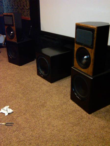

Here is a photo of flanking subs used with matched-directivity two-way speakers at a recent audio show. The rigid hotel walls (concrete on all six sides) are notoriously difficult, so the multisub approach is really helpful in that environment.
Wayne, after looking at your corner horns I wonder whether you've considered doing something with the backwave at floor level in a two-way design as a way of filling a floor bounce hole?
Yes, I've tried various approaches over the years. One was a two-way cornerhorn, and it sounded pretty good. But I do think the approach I have now is better, with a large format midhorn at ear level. That's always a problem, the competing priorities of having midrange at ear level while maintaining source position that is acoustically close to the corner.

Here is my current setup..
As you can see Im a fan of the AEspeaker! I have many, many drivers from John. Love the TDM series woofers. The bass bins are AV15X and I can add more to flank the main speakers.
Im currently rebuilding the room so everything is going to change. Im changing my mains to IWATA-300 designs too.
Hi DBM,
Interesting curves and I think I agree with all your assesments.

I'm guessing you are seeing the same thing, that ports at different locations make the difference (interaction with the room and its dimensions) and the actual direction of port facing doesn't matter.
Your port resonances are interesting also. They are usually there but you frequently overlook them unless you can "turn them on and off" as you have done.
So in summary then,
1) Significant increase in output below the box tuning frequency of the rear port vs front port is probably due to dipole action from having the out of phase sources separated on opposite sides of the cabinet instead of next to each other ?
2) All other differences between front and rear port response at and above box tuning frequency (up to about 200Hz) can be explained by different room modal/boundary interaction due to the significantly different physical location of the port resulting in different room interaction ?
They are audible too. Not horrible or immediately obvious but I had noticed it in measurements before and done listening tests where I blocked one port, applied EQ to "correct" the bass response back to the same as when both ports are open, then listened to the midrange in particular with front or back port blocked.
With only the rear port active the midrange is quite noticeably smoother and cleaner, and it's the main reason I favour rear ports, particular on a 2 way. (Unfortunately this test cabinet was made years before this realisation, or I would have put both on the back...on the other hand it has been quite useful as a test bed for these sort of measurements) The ringing of the pipe mode resonance of the front port shows up quite clearly on CSD plots, while the rear port one doesn't (when measured anywhere in front of the cabinet) even if the speaker isn't far from the front wall.
