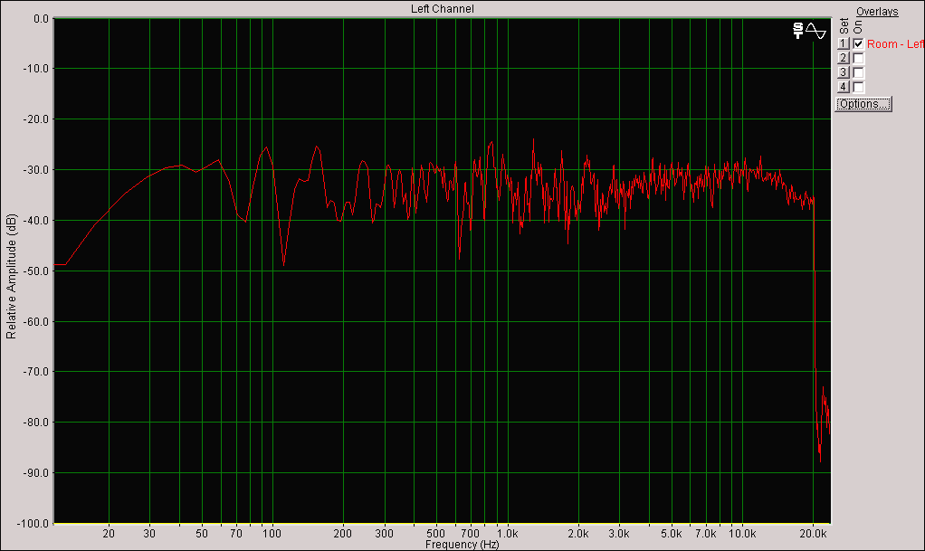

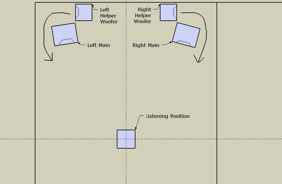

In one of my previous living rooms a notch at 75Hz was a huge problem at the listening position - there was a very deep notch such that a 75Hz tone was almost inaudible whilst sitting, but if I just lifted my listening position by a few inches it started to return. Forwards or backwards movement made very little difference, (at least less than a couple of feet) neither did left/right. Up and down movement was the sensitive axis - when standing up in the same location there was no notch.
It was a large 4m wide by 8m long, 2.4m ceiling room where the floor was carpet over a poured concrete foundation - so the floor had almost 100% bass reflectivity.
The front wall and right hand side wall whilst normal plaster board on the inside were brick on the outside so were probably very reflective in the bass too, all of which contrived to cause very large standing wave ratios and several modal problems.
The listening position was about 3 metres from the speakers, leaving about 4 metres to the back of the room behind the listener. There was about 0.8m from the front of the speakers to the front wall, and about 1 metre to the side walls. Any further than this and more serious holes started to occur in the bass response.
I recently found an old steady state listening position measurement that I took of it around 2004, which I've attached. The holes at 75Hz, 110Hz, and 200Hz are quite obvious, and that's after the speakers have been positioned for best response.
Interestingly the hole at 110Hz was present despite bass being produced by a 12" woofer whose centre was about 30cm off the floor. On the other hand a higher woofer had a far more severe hole at 110Hz so it was helping a lot, the remaining cancellation was boundary cancellation from the front wall and side walls - moving the speakers further out from the corners moved that notch down in frequency but never eliminated it.
I tried a lot of things to get rid of the hole at 75Hz, including moving the speakers, (obviously) flanking woofers, and while those helped a little bit, especially for the dips around 100-200Hz they never really solved the problem at 75Hz when they were facing forwards beside the main speakers.
Even placing them right in the corners facing forwards didn't really seem to work, it helped a little bit, but there was still a very height sensitive notch at 75Hz at the listening position. I put it down to a destructive reflection from the ceiling - ceiling bounce I guess you could call it.
For no good reason that I can remember other than experimentation I one day tried positioning the flanking woofers as shown in the second image attachment - against the front wall, right up beside the main cabinets (the gap between the main cabinets and front wall was almost exactly the width of the flanking woofer cabinets) but pointing behind the other speakers. The main cabinets were about 50cm wide by 80cm high, with the flanking woofer cabinet being about 50cm high.
Much to my surprise with this configuration the height sensitive notch at 75Hz at the listening position was almost completely gone, and the 110Hz notch was largely gone as well. Improvement in the character of the bass with those two spatial holes filled in was amazing.
Keeping the flanking woofers in the same position but turning them to face forwards or towards each other still improved the notch at 110Hz somewhat but did very little if anything for the notch at 75Hz.
To this day I'm still a little bit puzzled by this, and at the time my working theory was that the large tall cabinets were together with the corner of the room forming a very crude corner horn for the helper woofer at mid/upper bass frequencies. I never found any other configuration of main speakers or helper woofers in that room that so completely solved that hole - sitting or standing the level at 75Hz hardly changed.
I see that kind of graph a lot, having a notch around 120Hz. It's pretty wide really, definitely audible. Especially when followed by a peak then another notch at around 200Hz. This makes vocals and stringed instruments sound unnatural to me, sort of thin and thrummy.
Yes, I've found this general configuration works very well. Of course, my constant directivity cornerhorns have this sort of built-in, and the geometric relationships between sound sources are fixed. It is nestled tightly back into the corner, so there is no boundary interference. Speakers with dual midwoofers in a 2.5-way configuration have pretty close fixed spacing too, so they can be blended fairly high, I imagine, probably 300Hz or so.
But if you use an external flanking sub, you can place it wherever works best and suits your decor. That's kind of nice. I like putting them on the ground and against the wall behind the speakers, just a little bit outside. This makes them offset a couple feet in all three axis, and puts them in-between the mains and the closest boundaries. Seems to work well in most situations. But I don't run them up very high, usually only to 120Hz or 150Hz.
