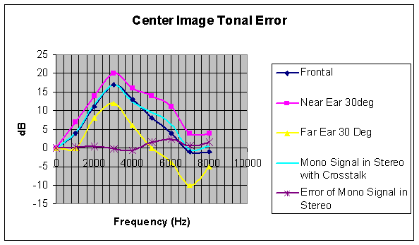

Thanks for the chart, Dave. It's interesting but I don't really understand it. Do you have more info about it?
Hi Pano,
Sorry about that. I think the graph is worth explaining as it concisely illustrates this whole concept. BTW, I won't refer to it as "SL's" concept as I arrived at it many moons ago (and no doubt have others).
Here is the graph attached. What it shows is the sound pressure incident at the "drum reference point" in the ear canal caused by a flat broadband signal in an anechoic condition, under various conditions which I'll explain. Stated another way, the curve shows the frequency response of your head, outer pinna and ear canal as measured at the ear drum. For DRP definition see section 4.4 in
http://eu.sabotage.org/www/ITU/P/P0057e.pdf
Stereo speakers in the "classic" stereo triangle are 30 degrees to the right, or to the left, in front of the listener. The magenta curve is the frequency response of your near ear if the sound is playing from one of these locations. To illustrate, lets say the sound is playing from the right loudspeaker. The magenta curve is the head/ear frequency response measured at the DRP of your right ear (Near Ear). The yellow curve would be the frequency response at your left ear (Far Ear).
Now, imagine the same signal is played in both the right and left speakers (mono). The light blue signal is the frequency response in either the right or the left ear. Its the combination of the "near ear" response and the "far ear" response, using a power summing rule. Caveat: the power summing rule isn't always the most accurate rule, it depends on circumstances. The perception of loudness depends on the source signal frequency content, dynamic characteristics and duration i.e. sometimes "double" loudness is +6 dB as I showed here, sometimes its closer to +10 dB, or in between. Zwicker and others have shown this in DBT tests (Ben, this no doubt plays a part in your question: how do you measure loudness?).
So, the light blue curve is the frequency response at both DRPs for the "phantom" center image.
The dark blue curve is the frequency response at both DRPs when a sound is actually physically directly right in front of you.
Comparing the light blue "phantom image" curve to the dark blue "physicaly present" curve, you can see that the phantom image, generated by speakers at +/- 30 deg, will present 2 dB more sound pressure to your ear drum, from ~ 5 to 8 kHz, than the same signal if it was actually physically located at the phantom position, in front of you.
This difference is the purple curve.
This is one inherent error in stereo itself. Caveat again: head frequency response vary with a high sigma over a population of individuals. This calculation uses industry agreed standard curves. I think the trend is universal though, only the magnitude will vary from person to person. The reason is that a source at 30 deg sees less acoustic shadowing from the head/pinna than a source which is directly frontal incident.
You could take this approach and calculate the error for any phantom image within the +-/30 deg window. Now, some are arguing here that the recording engineers will correct for this. My response is, some might, some might not. Who knows what they individually do or think? If they do , its by ear. From what I can tell, standard pan pots do not use azimuthaly dependent frequency shaping (though they could post eq). The side effect of the "error" magnitude being user dependent also means that the "correction" required is user dependent. What may sound "right" to a recording engineer might not sound "right" to you, for very objective, concrete, physical reasons.
