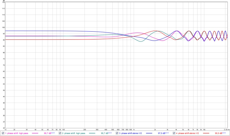

From what I could see the shuffler in post 3 was less well defined. The later posted shufflers are a bit cleaner.
Try the v2 version: http://www.diyaudio.com/forums/multi-way/277519-fixing-stereo-phantom-center-2.html#post4399454 or the first high passed version instead: http://www.diyaudio.com/forums/multi-way/277519-fixing-stereo-phantom-center-4.html#post4400043
A plot of what they do looks like this:
Looking at the plot here the high passed shuffler would probably work best.
I'll await the 900 Hz high passed version and test that.

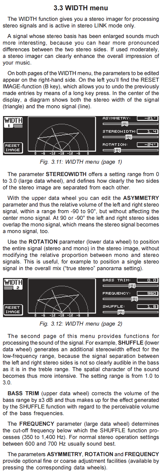

Seen somewhere pretty shure you both own a DEQ2496 and wonder is there any relation from its "WIDTH" meny to subject this thread. Attach description from DEQ2496 manual below.
Thanks sharing interesting stuff, at present not in position to test myself and help share the experience because my setup run a mono speaker feeded stereo signal, when that change will try the exercises from here.
Although I do own one, it's sitting in a box upstairs, never been used, bought new in 2011(!). I started with JRiver and never bothered to unpack the DEQ due to the results I was getting.
From what I read there it is indeed doing mid/side processing with adjustable results for bass and higher frequencies. I had planned on playing with it but never got around to installing the DEQ.
I used the DEQ 2496 Width effect on my system and it made some noticeable changes. Never found it of real benefit for my set up, tho.
The shuffler is different. It should not affect width, just tonality in the center.
The behringer width control speaks of "shuffle" too. But lets be clear on this, it is most probably based on the Blumlein shuffle idea.
The phase shuffle is indeed a totally different concept.

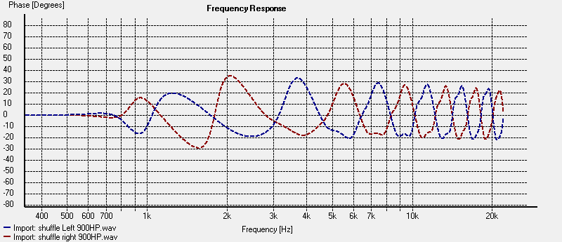

This is what the phase shuffle looks like on my latest version. The shuffle part was high passed with a steep filter at 900Hz. Not as smooth looking as I might like, but OK for testing. Basically alternating +/- 30 degs.
If you manage to incorporate that phase response included into a passive cross-over, then this method can become very popular 🙂
That would be interesting to test. Never heard that before.Some say phase randomisation is achieved by bending wave transducers due to their operational principle, without additional phase shifters.
Quite so, yes. Much of this is covered in the white paper.Or if one allows some early room reflections, then cross talk comb notches are filled and become non perceivable. Thus speaker directional patterns becomes important.
One could say highly directional speakers propably benefit more of "phase shuffler" than low directional speakers.
HmmmIf you manage to incorporate that phase response included into a passive cross-over, then this method can become very popular

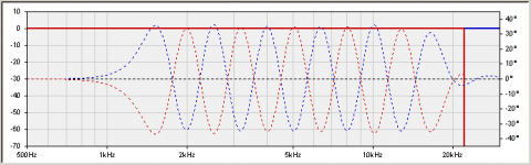

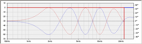

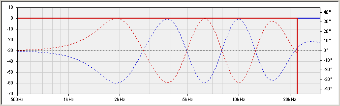

POS got me thinning about rePhase so I had a go at making a phase shuffler with it. Made two versions, which you can see below. It's a very different impulse from the original file I did. This affects phase only, not amplitude, as the original shuffler did. Certainly sounds different. The original is a series of quick reflections 11 samples apart that fall off by 5 or 6dB each. The new ones don't work that way at all, it's purely phase manipulation.
If you get a chance, check out the new ones and tell me what you hear.
Also included in the zip file is a perfect impulse. If you run this in your convolver, you should hear no change in the sound at all. If you do, there is something wrong. You can test if convolution is really working by loading the Telephone BW file, you will certainly hear that one if it's working! It is there just to verify that your convolution engine is working. No mistaking the effect if it works.
For those of you who can't use convolution in your playback chain, I will post some files next week that have been preprocessed.
Have fun with the new versions, let me know what you hear, if anything. Cheers!
Briefly listened to the first rephrase shuffler. This one didn't move the position of the sound on the sides for me (that's a good thing). Though it still did seem to push the center image away a bit. I didn't have both tracks (one with convolved shuffler and the original) at the same volume and had to adjust on the fly. They should be exactly the same to form an honest opinion.
I'm testing too many things at once a.t.m. to say anything really useful about the coherency.
I just might have found the improvement I was after in the mid/side processing described in the LoCo link a few pages back. That's still keeping me happy so far and was simple to incorporate because I had all components in place.
I do hope more will listen to this one. If anything I think in my setup the old shuffler was more effective to make a perceivable (positive) change in the tonality of the phantom center. I'll have to give it another go soon.
