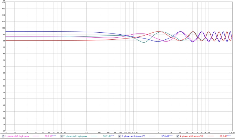

Thanks for the report! Interesting that you sense the sides moving back. I wonder if I can fix that? Below is the impulse but with the echo part high passed at 650Hz. It sounds different to me, let us know if it sounds different to you. It "should" apply the effect only above 650Hz

The high passed impulse file should only affect frequencies above 650Hz. That's an octave lower than the filter used in the paper, but it seemed like a good start.I'll try the high passed one later on, but I'm still trying to come up with some way to only affect the mid shared part of the left and right signal. I do like what it does there.
I'll have to do some analyzing to find if it is really only active above 650.

I did manage to look at both impulses in REW to compare:
Judging from what we see here I expect the new one to have a better balance overall. 1=left, 2=right, 3=left, 4=right.
