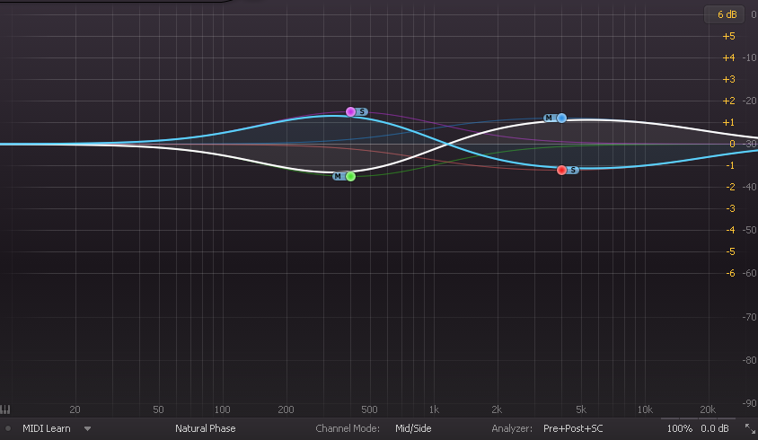

I didn't use an impulse to try the LoCo setup. I used some VST plugins to do it, like this:
But with both sides connected to the EQ (the right/sides is still bypassing EQ in this picture).
The first Voxengo MSED is encoding the stereo signal to mid-side.
If I EQ the left I'm actually applying the EQ to the mid channel only and by EQ-ing the right I can apply EQ to the sides.
The second MSED decodes it back to stereo. The curves I used within the EQ are based on the paper you linked. Hope this helps. Here's the EQ settings I used for starters:
In the equaliser I run 4 PEQ's
First at 4000 Hz, Q= 0.3 and boost is 1.2 dB on mid (left)
Second at 400 Hz, Q= 0.5 and boost is - 1.5 dB on mid (left)
Third at 4000 Hz, Q= 0.3 and boost is -1.6 dB on side (right)
Fourth at 400 Hz, Q= 0.5 and boost is 1.5 dB on side (right)
More here...
One note: in the above picture the mid-side processing is below JRiver's PEQ settings. That would not be the preferred position as it would change what is common on the left and right channel if one of the channels has a boost somewhere. So it would be best to do the mid/side processing before applying any other form of EQ on one of the channels.
Another note: Some EQ plugins have the ability to do mid and side EQ build in, you wouldn't need the (free) Voxengo MSED in that case.

Thank you for the answer, I didn't think of VST EQs.
I tried Foobar with Fabfilter Pro-Q 2(trial).
Just in case anyone wants to try it, the setup is quite easy. Make sure that you install the VST Adapter for Foobar. Install Fabfilter Pro-Q 2 like usual.
Inside Foobar go to File->Preferences->Components and click the small arrow to unfold the Sub-menu "VST plug-ins". Press "Add..." and locate the VST dll of Pro-Q 2 and press "Apply" or "Ok". After Foobar has been restarted go to File->Preferences->Playback->unfold via arrow the DSP Manager.
Now you can pick from the right side "Fabfilter Pro-Q 2" as a DSP by double clicking. Press "Configure selected". Inside Pro-Q 2 switch "Channel Mode" in the bottom to "Mid/Side". Double click the flat orange line in the frequency graph window to add a filter. Double click the filter(point) to enter values by hand. Click right -> "Stereo Placement" to define the channel(Mid/Side). If everything went well the Pro-Q 2 window should look similar to the attached image. Presets can be saved by unfolding "Default Setting" on top and select "Save as..." near the bottom.
Since I listen in the nearfield I'm not sure what differences I should exprect. On some songs I can hear a difference, on others I don't. If there was a difference, it was only subtle.

I like what the mid-side EQ does for me. Granted it is subtle, but so where the differences in tonality between the phantom centre and the sides. I'll admit it's still not 100% the same at all times but closer than before.
