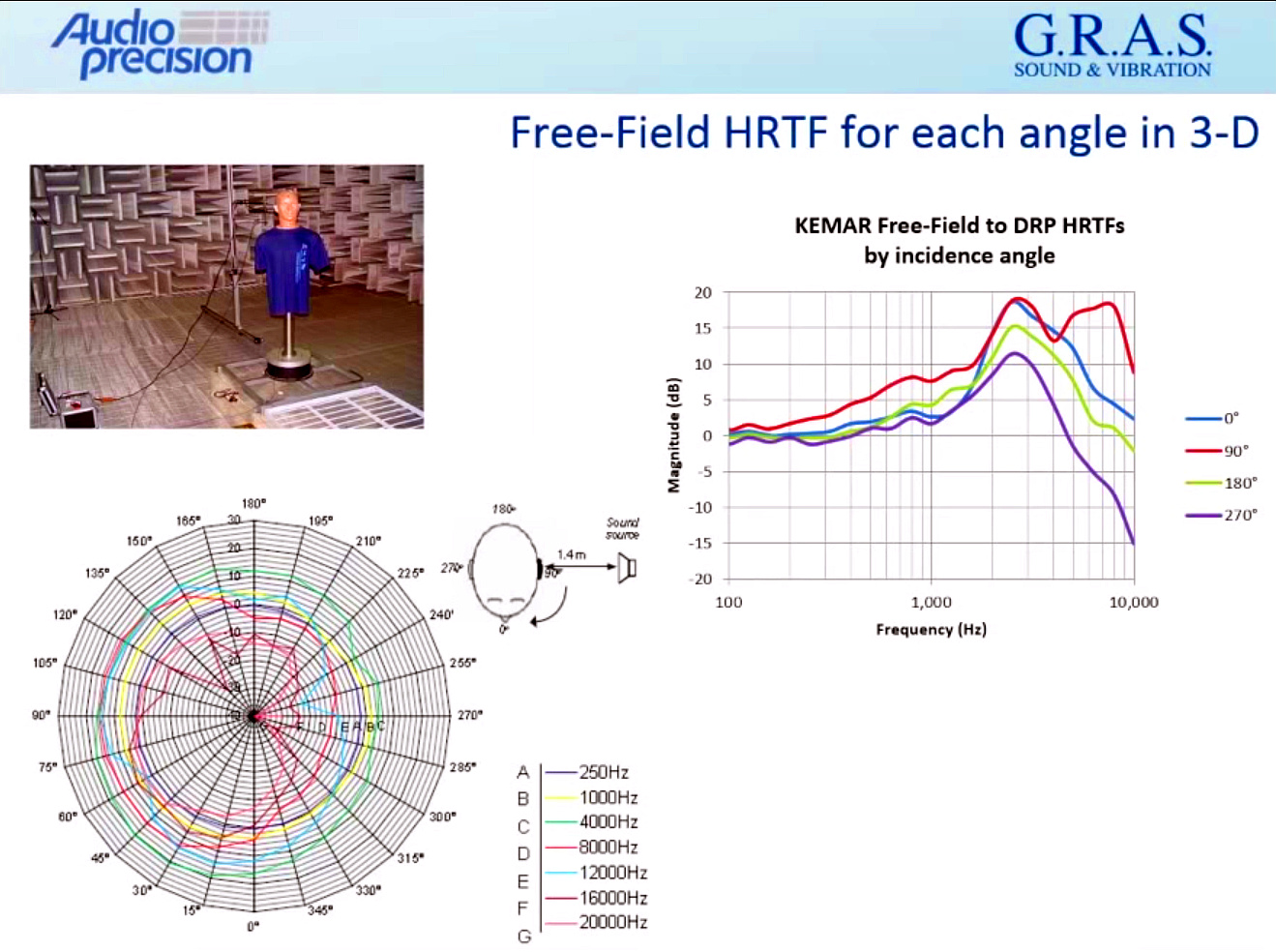

One thing that has bothered me about the phantom center over the years is its darker tonal balance, compared to the sounds coming strictly from left or right. Or to put it another way, a sound coming from between two speakers often sounds darker than a sound coming from a single speaker.
Maybe I haven't thought it through completely but it seems counter intuitive. Consider the HRTF directivity chart below. The ear 'expects' much less mid and high content from a source directly in front of the listener than one 45 degrees off axis. In a typical stereo set up, with speakers 45 degrees either side of the listener and equal content in both speakers to create a phantom centre, the listener will receive the mid and high energy of sources 45 degrees off axis but localization associated with 0 degrees. Assuming no compensation in production shouldn't it sound brighter instead of darker?
A useful experiment might be to compare level matched white noise played from one speaker then both to sort out if your experience is due to something happening upstream, i.e. the recording.
Yes, I've tried it. I've even posted some test files in the thread - somewhere back there.
Here's the thing. If you have a real source straight ahead, it will sound normal, or at least how you expect it to sound. But if that straight ahead source isn't actually there, it's a phantom made by two speakers, then the tonal change happens. It happens because of the comb filtering between the two speakers.
Remember, it's only because of the stereo phantom image, you don't get the effect with actual sources located directly in front of you. They don't have the comb filtering.
