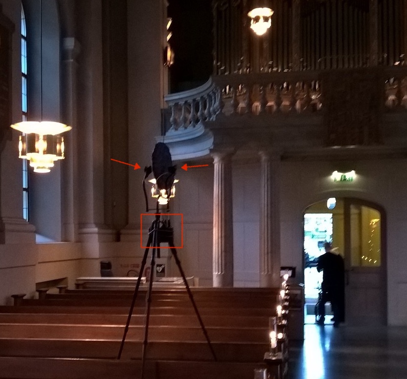

Btw: here is my Jecklin rig at the location of the organ recording...
The USB sound-card is placed indicated by the red square. I will do something similar for this but smaller and closer to mics if possible. Most certain I will solder both ends of the mic cables so it must be integrated with a transport solution for protection but need to "fold" out to take positions for duty.
