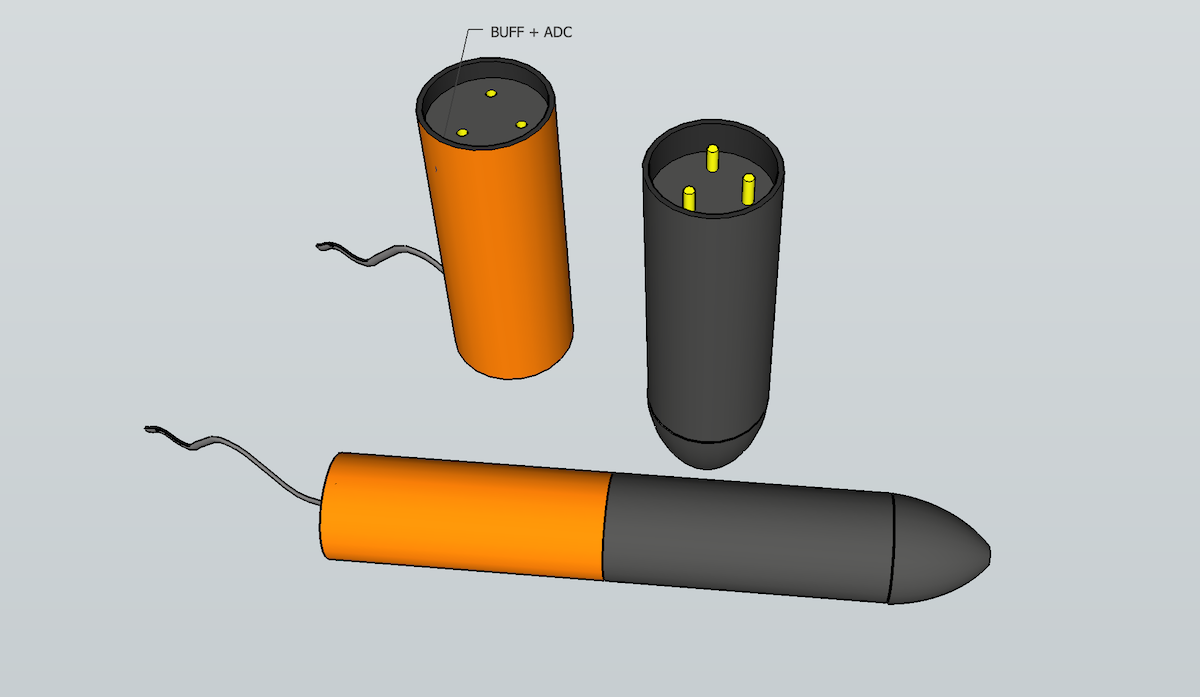

Sketch of how you could interface a normal condenser microphone with 48 V phantom supply ....
Thanks!!! I wonder how small one could make this? Would it fit in a tube which would be an extension of the mic? Sync L/R?
That's an interesting circuit and I'd be curious to hear the results. For my use I'd just go with a transformer (because I like them) but understand why other people might not want to. If built all SMD, it could be quite small. There would be some practical issues of signal transport and handling doing it that way, just something to work out.

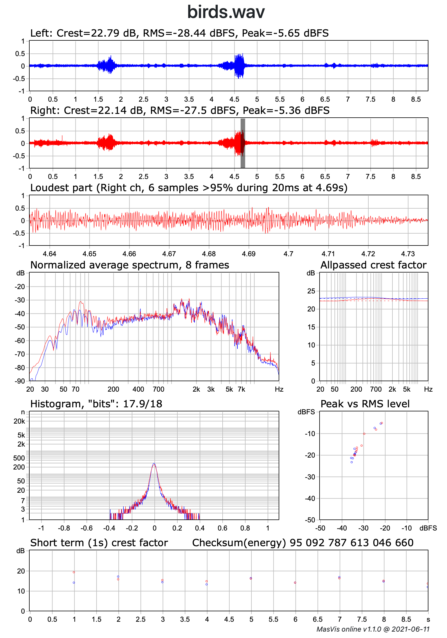

Thanks for the tip on the Mavis software. I've never seen it but will certainly give it a try, it seems to provide some interesting info! Also, I'll hit you up via PM for more recordings. I'd like to hear one or two in more length. Cheers.
As drawn it would require batteries for the floating ADC supply and for the ground-referred digital stuff and either a step-up converter or a battery for the phantom supply and op-amp. I guess fitting all that in a small tube would be difficult.
OK! Maybe one could have the batteries outside and fed to the mics using a multi function cable...

While you could do that, it would seem impractical to do so. The thing is, if you put the ADC that close to the mic, then you don't need 48V or balanced line drivers. You just need to get the capsule powered up with 2.5-5V and feed the ADC a low impedance differential signal.
If you come digital out of the mic how are you going to get it into the recorder? How will you record more than one mic? You could simply build the recorder into the mic, but then you'd have to stack and time align your recorded tracks in post. It can be done, but is an extra step.

When the microphones have independent ADCs, you would need to synchronize them to a common clock or use asynchronous sample rate conversion. Otherwise when you have 5 ppm clock frequency difference and record for an hour, you would have an 18 ms shift between left and right at the end. Interaural time delays are less than a millisecond, so the stereo image would be messed up completely within a few minutes - unless samples get dropped or repeated, which causes clicks. In fact the RME Digiface would drop or repeat samples when the signals are not synchronized to the same master clock, see page 65 of https://www.rme-audio.de/downloads/dface_usb_e.pdf
In a "normal" condenser microphone, you need a relatively high voltage for membrane polarization and you need to provide a supply voltage to the buffer/amplifier with extremely low input noise current. In an electret microphone, the membrane is permanently polarized without any external voltage, so you only need to provide a supply for the buffer/amplifier with extremely low input noise current. The voltage can then be much lower, in fact the 48 V phantom supply is often regulated down to 10 V or so.

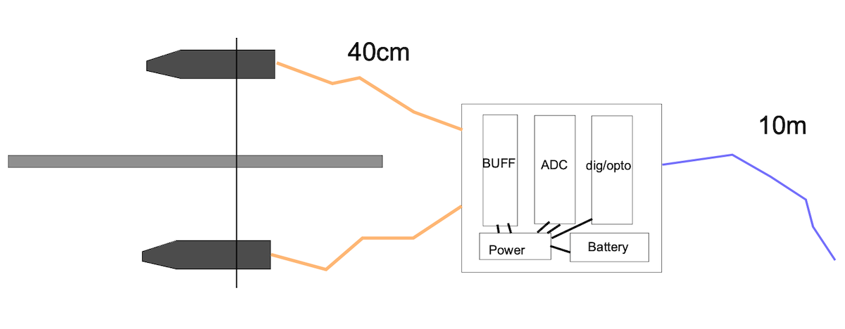

Seems to me that if you are using a barrier mic rig like the Jeklin, then a small box of electronics at the mic rig would not be a big problem. Even the whole recorder could be there. Otherwise if you really want to ADC at the mic, then maybe AES is the best cable transport to use back to your DAW. AES is robust enough for medium long runs.

The topology I think will need to be one common box close to the mics with room for battery power. Laptop say < 10 meter away so only digital interface out from the box - preferably opto - 24/192 max. 24/88 OK.
Maybe the PCM4222 evaluation board can be used. I would primarily need help with the mic-PCM4222 interface... pretty please...
