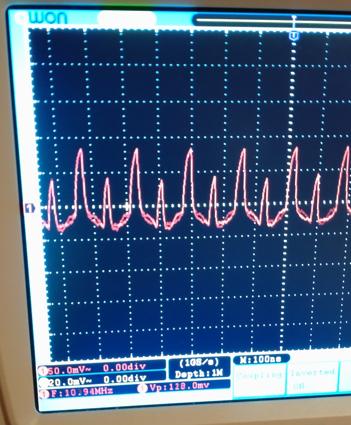

Hmm. After the event with the blown fuse that I suppose made the EVM board miss out of one of the + or - 15V, I now see efter the EVM op-amps (test points) what is depicted below. I was not there before and its on both channels. I just noticed as I was looking for output from mic #2 while tapping the table.
So close and now I sit with a possible injured EVM board. Mic #2 status looked to be better but now I need to first understand if I have a working EVM or not...
Sigh... But its my fault making a short in a mic while half assembled - I was to eager 🙂 and not taking precautions :-/

Marcel, seeing that oscillation, what would you say is its cause given the previous events?
Are the OP amps on the EVM boorked - or could even the ADC have been broken?
Unfortunately I really don't know. The amplifier ICs on the evaluation board have no direct connections to ground, which makes it far less likely that they go into destructive latch-up when the negative supply goes somewhat positive or the other way around. The outputs of the OPA1632's may have gone outside the specified absolute maximum rating for the input voltage range of the ADC chip, but the same can happen during normal use when you apply a too large signal. The current that the OPA1632's can deliver is typically 85 mA, while integrated circuits are usually designed to survive 100 mA under worst-case conditions for a short time during latch-up testing.
I don't think it's a parasitic oscillation, rather the sampling of the sigma-delta ADC. The frequency is about right and I would expect a spiky waveform because it is a switched-capacitor circuit (according to page 30 of the PCM4222 datasheet). Are you sure it wasn't there before?
What DC voltages do you see on the test points? They should be about 1.95 V. Is the spiky signal stronger or weaker when you measure at the OPA1632's side of R19 and R20?
When you measure them in circuit with the power off, do you get about 40.2 ohm for R19, R20, R21 and R22?
Thanks a bunch Marcel - I will check this later today. I'm quite sure they where not there. I have hooked up my scope probe several times to the 3 test pins after the OPAs on the EVM and this wasn't there before.

DC on test points:
CH1: 1,74
CH2: 1,86
Both same on +/-
On R20, its 4 times stronger on one side (cant figure out which really) 25vs100mV p-p. Same for R19.
All 4 resistirs show 40 ohm, EVM power off.

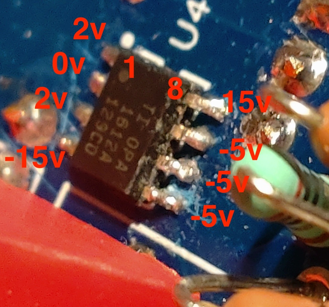

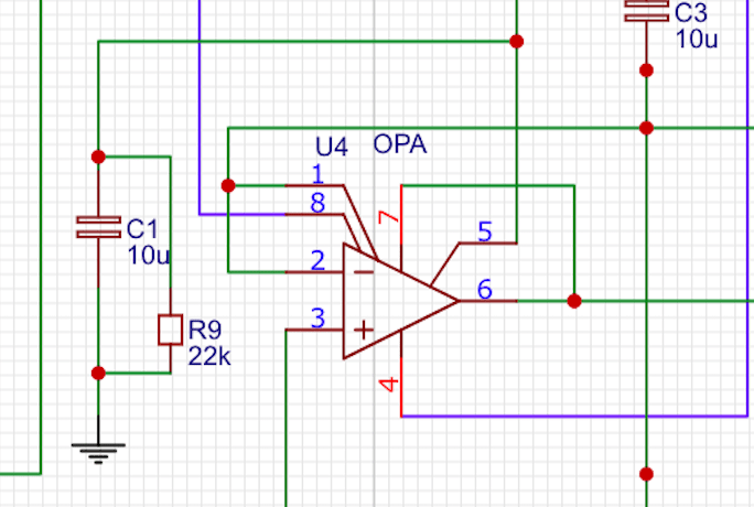

OK, digging in with the fault tracing...
Schema....
So there is a short between 5 and 6 using my ohm meter. What can cause this?
Is a short inside the OPA "possible"?
I have inspected and scraped with a knife... went back and verified an unstuffed board - ok.
Perhaps desoldering the OPA is the next best step to get a better insight into whats going on...?
