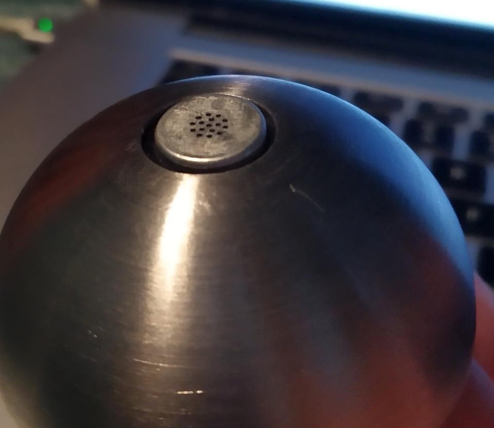

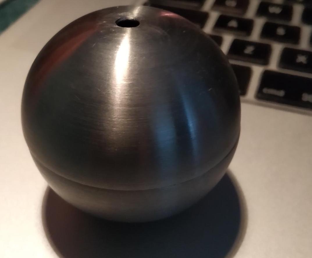

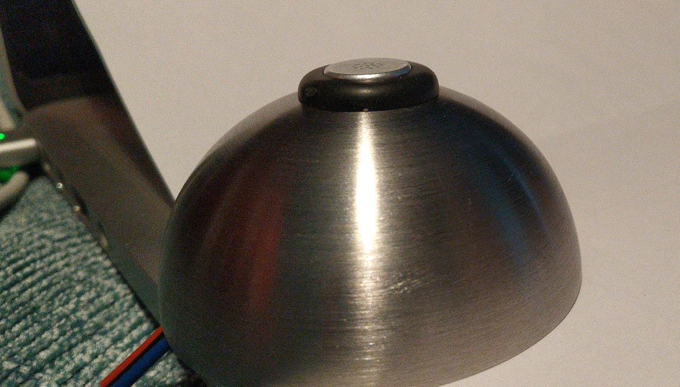

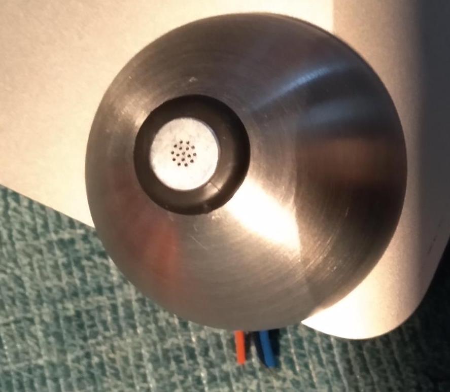

Some progress on the mic build... Maybe I want the capsule flush to the sphere. But these dimensions are small compared to 20k wave length... but still...
Wimas are 10uF... so 47 -> 10 and 100 -> 20 uF... 1Hz -> 5 Hz.... OK?

Yes, thinking about it I think I will do it flush. The grommet was quite hard rubber... I'd like a more compliant isolation and I think I will make one out of silicone.

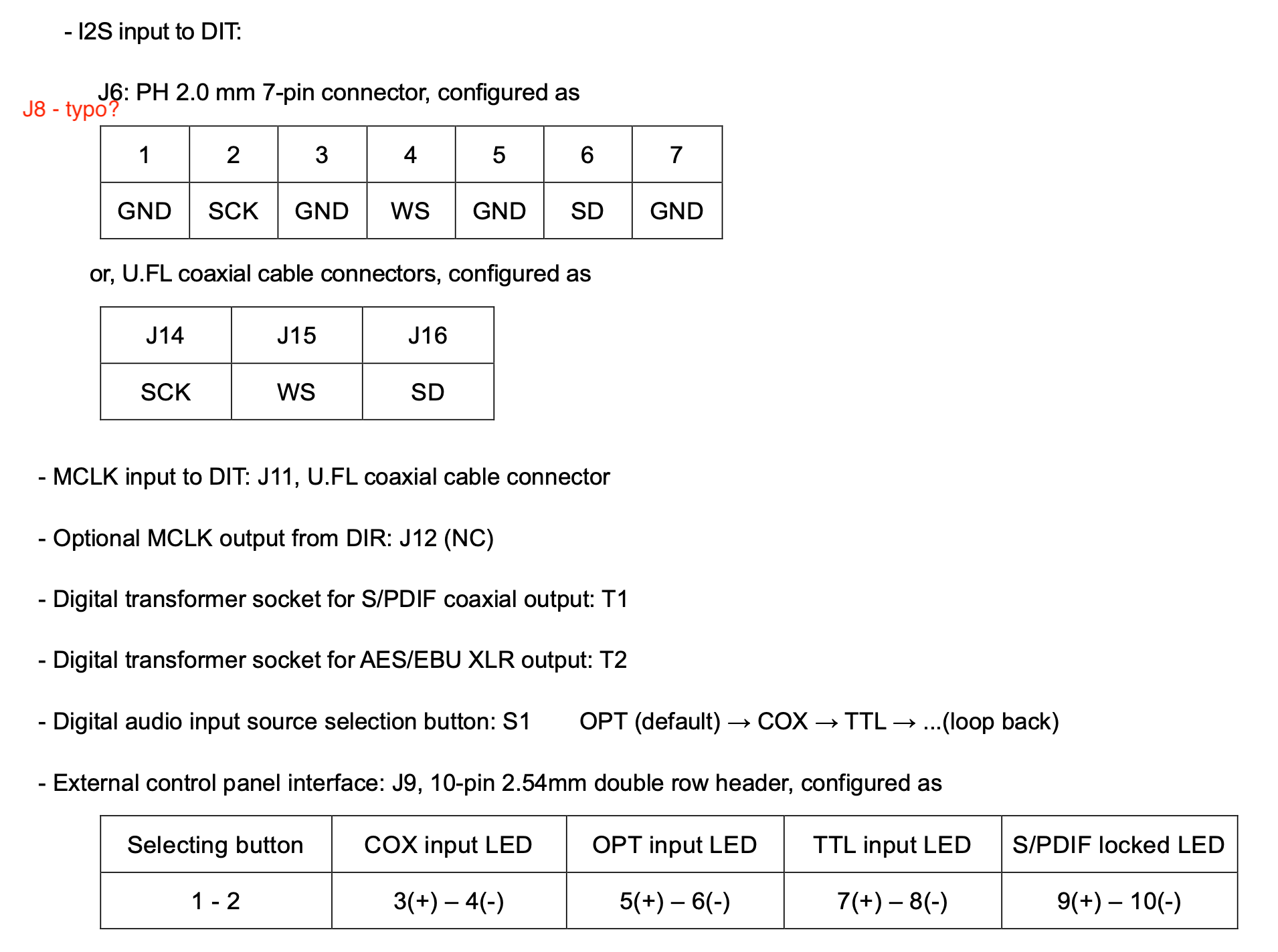

Can I use a Ian Canada SPDIF board for the i2s to toslink conversion?
I2S input
LVTTL (3.3V) logic input level
44.1 KHz, 48 KHz, 88.2 KHz, 96 KHz, 176.4 KHz, 192 KHz – 16- or 24- bit 7-pin PH 2.0mm connector
from: DocumentDownload/SPDIF_InterfaceBoard.pdf at master * iancanada/DocumentDownload * GitHub
Yes, that should work when you loop through the MCKO from the PCM4222 evaluation module to the master clock input.
SCK: official Philips/NXP name for what's called BCK in Sony lingo
WS: LRCK in Sony lingo
SD: data
Are you thinking about the case with or without FPGA board?
For the case with an FPGA board, the FPGA board will be I2S master and will drive the I2S input of the Ian Canada board.
Besides the I2S signals, the Ian Canada board needs a master clock at J11. It has to be either 128 or 256 or 512 times the decimated sample rate. You could use J4 pin 13 of the PCM4222 evaluation module for that, as it carries a clock signal of 128 times 88.2 kHz or 128 times 96 kHz. J4 pin 13 then has to be connected to an input of the FPGA board (pin 5 of SV2, mck) as well as to J11 on the Ian Canada board.
