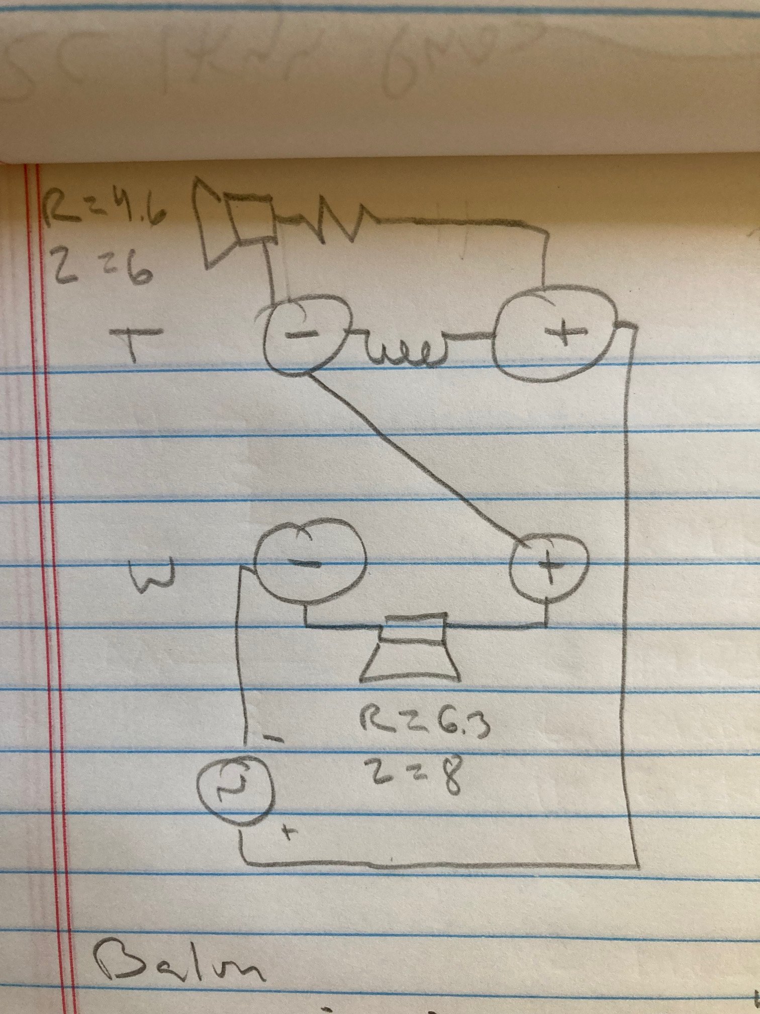

Per post #296, I have continued uncertainty as to how to rewire the crossover in my favorite 2-ways.
I think I've nailed it. A series crossover, where the tweeter sees amp + in series with an 8R levelling resistor and in parallel with a 0.33mH choke, and the mid-woofer follows in series, full open, connected to amp -, sounds pretty damn good. It brings up the mid-bass like heck, and it is in fact muddy and a touch floppy, but it's warm and full and really sings with RIAA equalization. Willie Dixon's Blues, Nina Simone on vinyl all sound wonderful. Current source is fun!!

So yesterday, I tried 50 ohms in parallel with the mid-woofer, and my quick impression was that it "sucked the life out of the music" so I pulled them out and went back to before. I think 22 ohms would be more severe, partitioning more of the current away from the mid-woofer, so I'm probably not going to explore that. Today I'm pushing the tweeter down in frequency, swapping the 0.33mH parallel inductors for 0.39mH. I like it better so far, but it's early days. This is expectation bias but the midrange is filled out more now. The A26RE4 mid-woofers do just fine driven full open.
As an aside, crossover calculations confuse me. This tweeter has a nominal impedance at 3kHz of ~6 ohms. A calculated 6dB high pass crossover for 3kHz and 6 ohms impedance calls for a 0.318mH coil. However, I have a 8.2 ohm leveling resistor in series with the tweeter, and if I do the calculation assuming a combined impedance of 14.2 ohms, the crossover point with a 0.33mH coil is 6.85kHz, way way high. I don't believe the tweeter is being crossed in that high.
I measured the actual impedance of a few of these 10W power resistors and they were all around 4uH, so I don't know how they would impede the AC much at all. So I'm ignoring the series leveling resistance in the impedance calculations for the LC network for now. If this is wrong, I'm all ears.

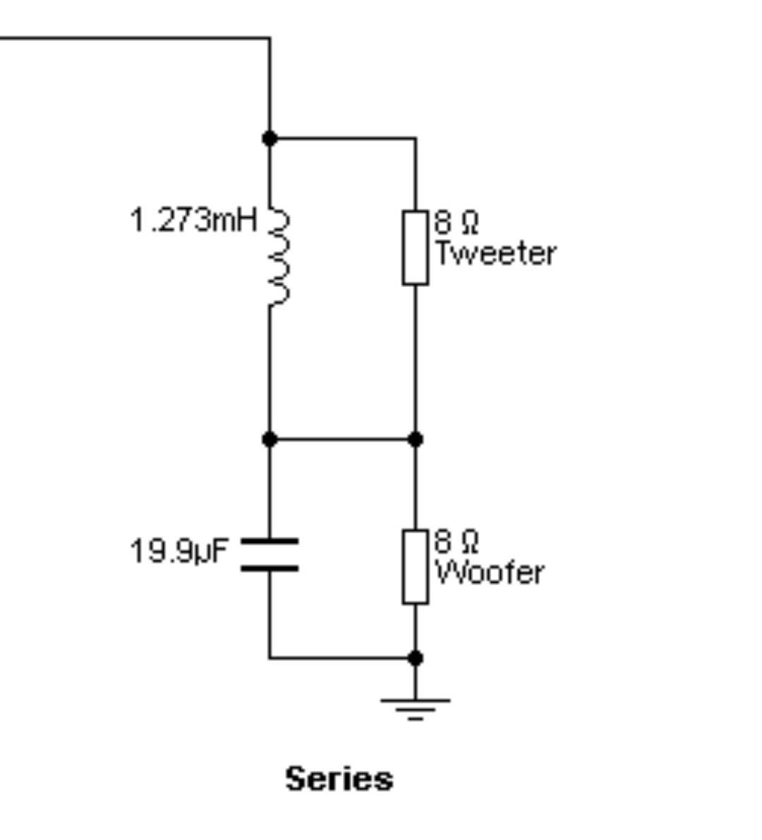

The way I understand series crossovers is that they act like a frequency dependent voltage divider (two voltage dividers in parallel, with their taps connected, in fact).
In the attached 1st order series crossover, in the top branch a LF/DC current will pass through the low resistance inductor unimpeded, bypassing the tweeter, but won't pass through the cap, so in the bottom branch it'll go to ground through the woofer, as intended. A HF/AC current in the top branch will not go through the inductor but will pass through the tweeter which has a much lower impedance, and it the bottom branch it'll get shorted to ground through the cap, bypassing the woofer. Somewhere in the middle the parts will all share some current.
So basically a frequency dependent series-parallel connected network of resistors. Change any one of them and you'll upset the whole interdependence.
In parallel crossovers this is not a problem and you can tweak each branch pretty much independently, but in series crossovers you'll have to view the network as a whole.
Yes. The way I've started thinking about impedance is that it's the sum of a resistance and a reactance. Resistance is frequency-independent and effects all currents equally* while reactance is frequency dependent. The amount of current a parallel reactance will shunt for frequencies where it is not reactive thus depends on it's DCR.
*is this true?
Is reactance (and hence crossover frequencies) voltage dependent as well? My current conception is that reactance is not voltage dependent but this gets back to what is confusing me about the "R" in LC and RC calculations. I don't understand how a resistance that effects all current equally independent of frequency would matter in a frequency-dependent calculation.
Joined 2004
My understanding is that each and every part in a series crossover has an influence on the response of both (all) drivers. While the resistor R itself is virtually purely resistive, it's in parallel with a frequency dependent part (L), and will affect the circuit further downstream.
Imagine the series crossover at the intended crossover frequency with all the parts sharing some current. In this picture, with a resistance in series with the tweeter, applying a voltage across the crossover will result in reduced tweeter output due to less current going through the R+tweeter branch.
Due to the added R there will also be a bigger voltage drop developing across the upper half (L in parallel with R+tweeter). So compared to the situation without the extra R, there will be less voltage available across the lower half (C in parallel with woofer). The -3dB point (in case of a 1st order xo) of the woofer response will therefore also have moved.
I tried some math, and I think these changes can be relatively minor in the case of this series crossover where a low DCR coil is used. The tweeter portion of my series crossover has an effective resistance of 0.197 ohms (8.2 ohm resistor in series with the 4.6 ohm tweeter, both parallel to a coil with a DCR of 0.2 ohms). With a 12 ohm series resistor the math gives me the same effective resistance = 0.197 ohms. The woofer resistance is 6.3 ohms. Having that parallel coil seems to make the effect of the leveling resistor negligible to the total resistance of the top branch, and by inference, to the crossover network overall. It also implies very little power gets to the tweeter currently due to the tiny implied voltage drop across the tweeter network, and that it would be utterly fried if the coil went open circuit. :eek:
Also I believe I have an answer to my earlier conundrum. The attenuation effects of an LC or RC are the sum of two attenuation curves- the linear, frequency-independent attenuation of the resistance and the non-linear, frequency-dependent attenuation of the reactance. Higher resistance lowers the linear contribution to a Bode plot, effectively pushing the knee of the non-linear portion out to higher frequencies.
