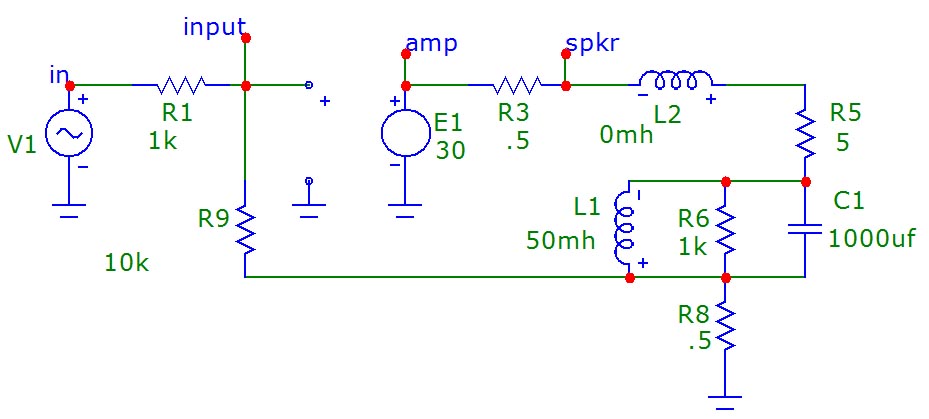

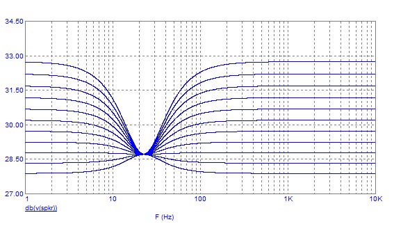

You can plug a simple pcf circuit into a simulator and get some very
interesting stuff. Here is the frequency response of an amplifier driving
a simulated speaker with varying amounts of pcf, and this doesn't
begin to address the control offered by a negative damping factor.
A suggested experiment..

....You can plug a simple pcf circuit into a simulator and get some very
Excellent Mr Pass
Thanks for the simulation schematic and interesting lesson 🙂
