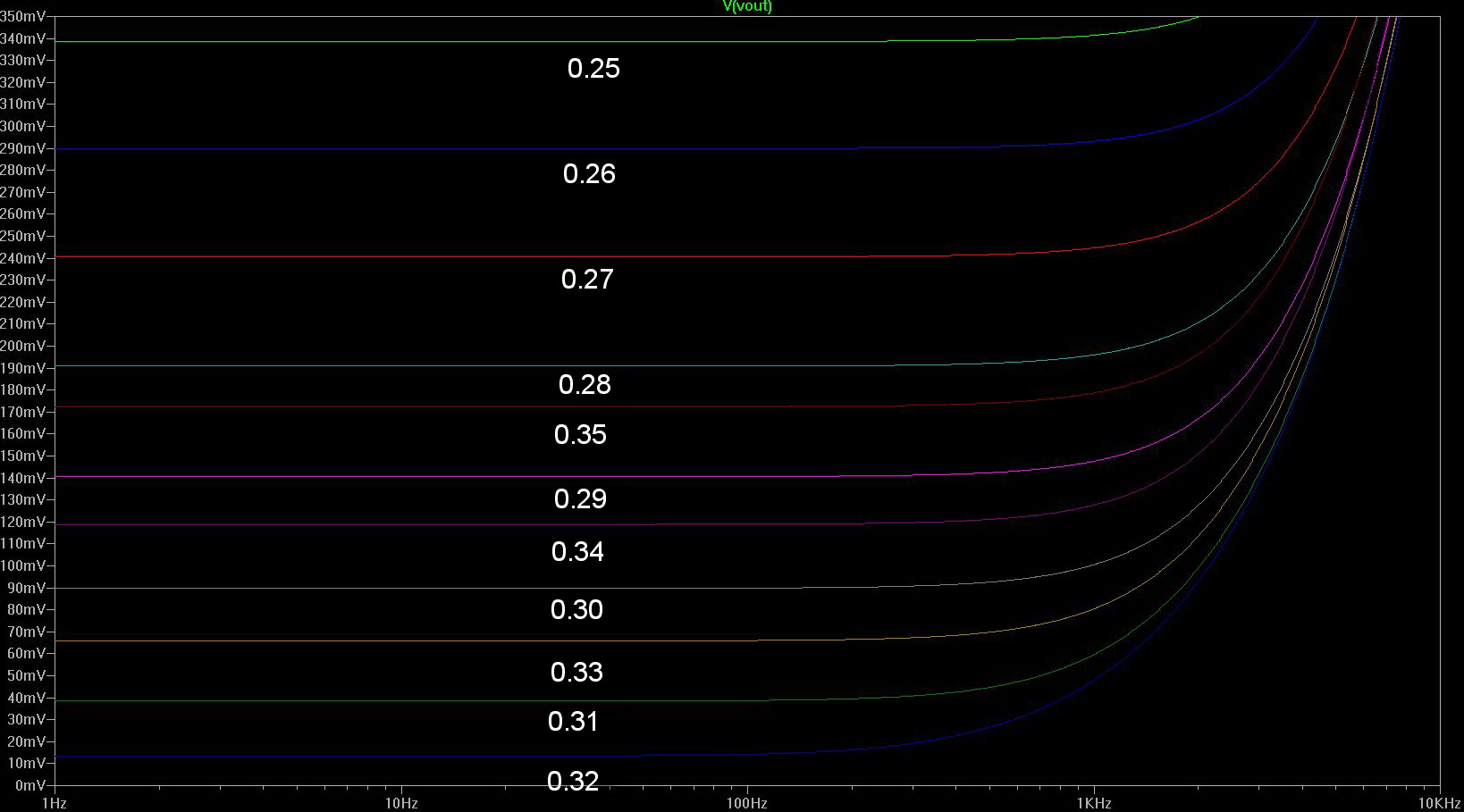

Here is the simulated output impedance. Vertical axis is in miliohms, Rsen is varied from 0.25 to 0.35ohms.

Something looks odd in your simulated response. For example, why does the DF for Rsen = 0.29 appear between 0.35 and 0.34?
Not sure if this is odd, but yes, the impedance reaches a minimum at Rsen = 3.2ohms. That was my point, the best Df can only be reached by tweaking the value of Rsen.
I think perhaps the query concerns whether you mean 3.2 ohms or 0.32 ohms as per the simulation picture🙂
Tested in the prototype. As the output impedance is very sensitive towards the value of Rsen and can easily turn negative i aimed for Df within 50-70. One channel Rsen had to be 0.434ohms and the other 0.456. Will have to do some longer term testing to see if this is stable.
