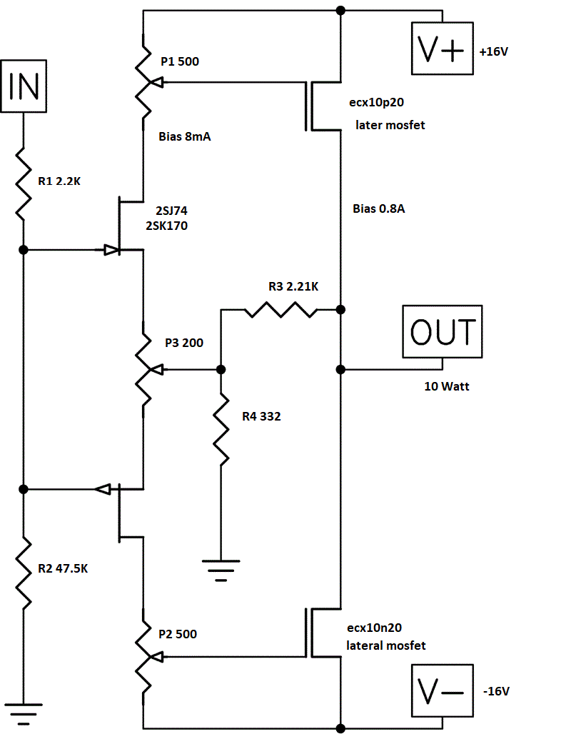

Hi Guys,
Actually the schematic is provided in below thread by Papa.
Now I added Toshiba FET's. Actually I am not expecting F7 but simple circuit which can produce 10watts.
Recommendation for 5-10W amp.
Can any one have good experience in First watt amps can suggect R1,R2,R3,R4,P1,P2,P3 and V+,V- for 10watts.

you already got it ;
it isn't F7 , nor F5
if you are not able to decipher and properly execute F7 , then just make smallish F5 , maybe with smaller IRF (510/9510 or similar) in output ..... if you insist on laterals - make Plantefeve's Buzquito/Mosqito or something
set Iq by heatsinks and PSU you have on hand

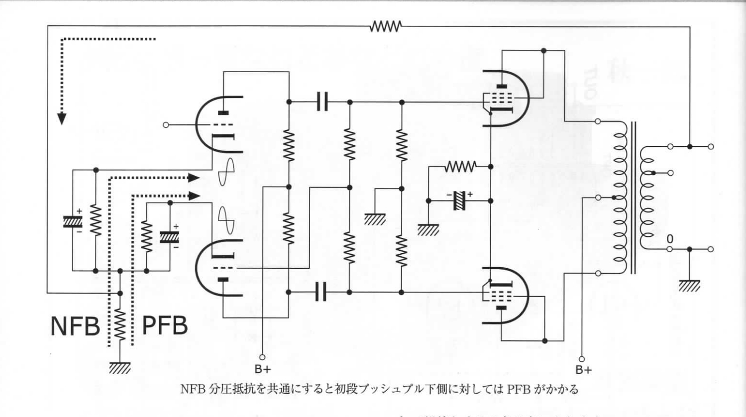

A note about PCF, it was explored in the 50's and abandoned, as far as I
can make out because of the difficulties when applied to amplifiers with
limited bandwidth due to output transformers and/or capacitors. The
phase shift involved makes it behave differently than with a DC coupled
wide band circuit.
If you are thinking about trying this with a tube amp, you will want to be
aware of this as a limitation as to the amounts of PCF you can apply.
wide band circuit.

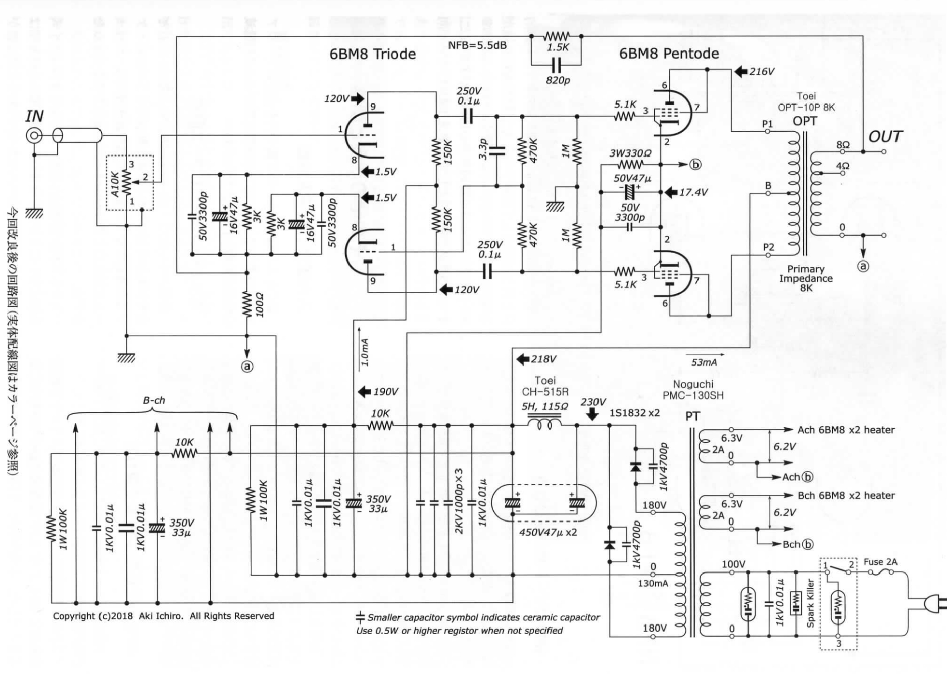

Recently find DIY tube amp with NFB = 5.5 dB and use PFB indeed.
r-tec1804_(04)6BM8(T)pp-power-amp(3)_AkiI.pdf - Google Drive
A commentaires about positive feedback on this schematic ? 🙂
