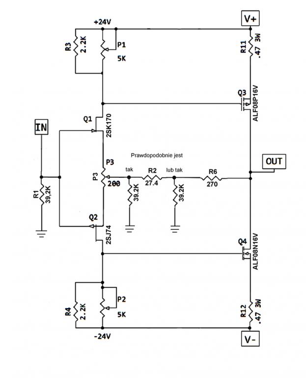

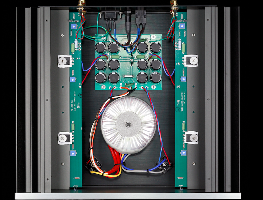

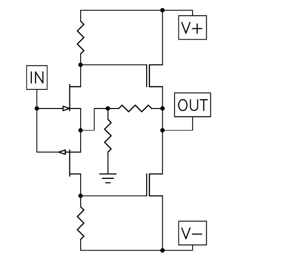

As per papa everything is on the table except it is official. Can you please look below images and let us know your thoughts. One is original diagram f7 manual and one from internet and one is actual amp. Look How it is so beautiful with no caps and very less resistors(with pots) components and only 4 transistors.

Yes, Colin way to complicated With these being lateral mosfets are those .47 ohm source resistors realy necesary ?

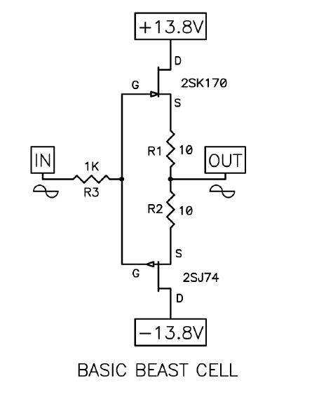

Yeah It is complicated but first stage is correct as per the document "The beast with thousand JFETS". And second stage is correct as per F7 manual, Both are provide by none other than Papa. So if we combine both the circuits we can expect working F7 circuit. Once I got 2SJ74 & 2SK170 I will build and test I verified exicon lateral mosfets they are identical to F7 laterals .
Not actually necessary to use the .47 ohm resistors, as the Lateral outputs
are low temperature drift. You do need something to measure the current
with, maybe .1 ohms. This leaves you with more gain the the .47's and
less degeneration.

No Positive Feedback in Nag's Circuit
Nag
I'm with Zen Mod on this as there is no positive feedback with your circuit, which is inherent in the F7 design (refer to F7 manual).
Nag

Actually I don't have background in electronics. very Little knowledge. Here we are feeding out put to input stage. As per my understanding it is not negative feedback, so we can assume positive feedback. someone have amplifier/audio circuits experience please explain 1095 post,
