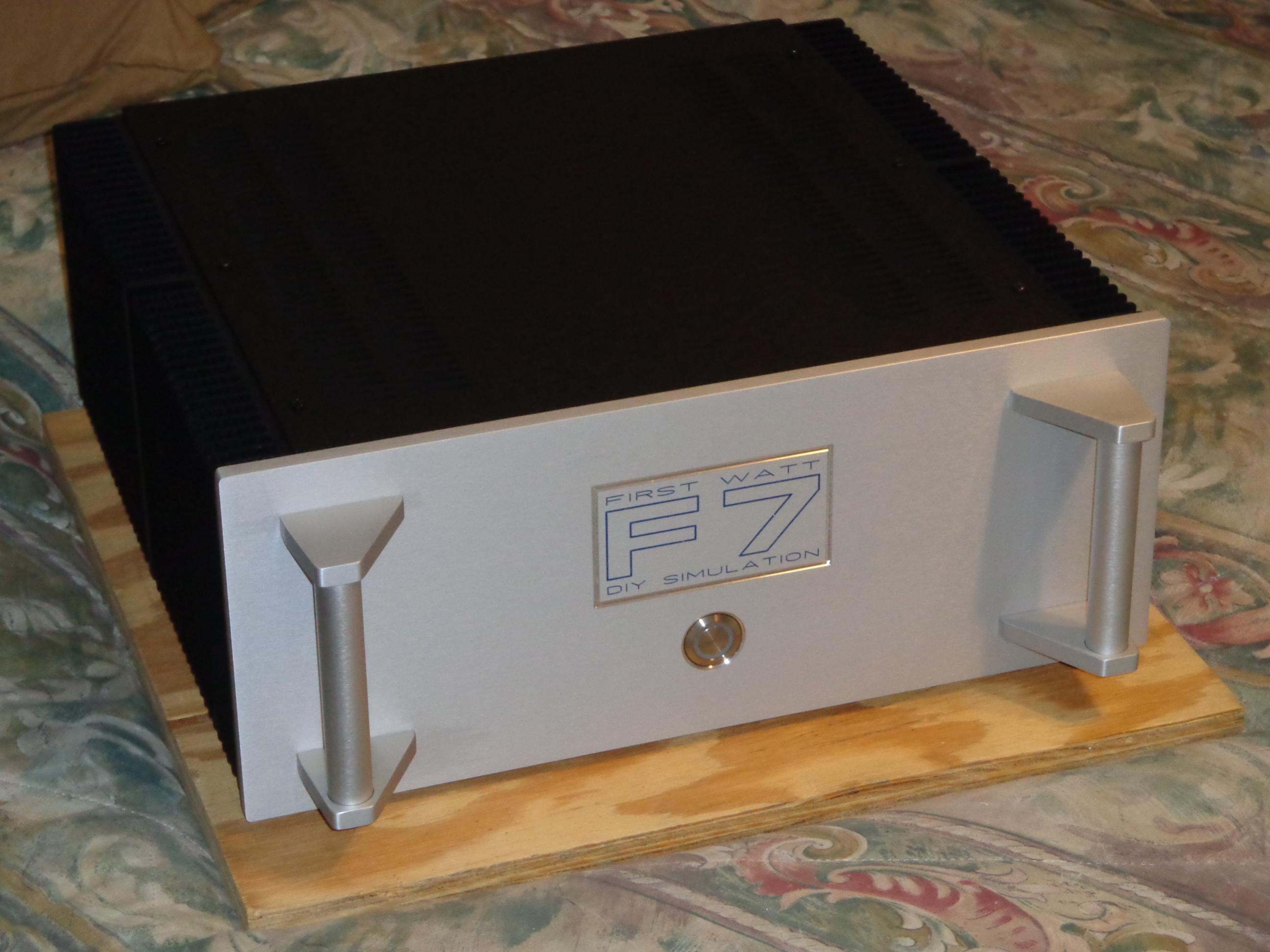

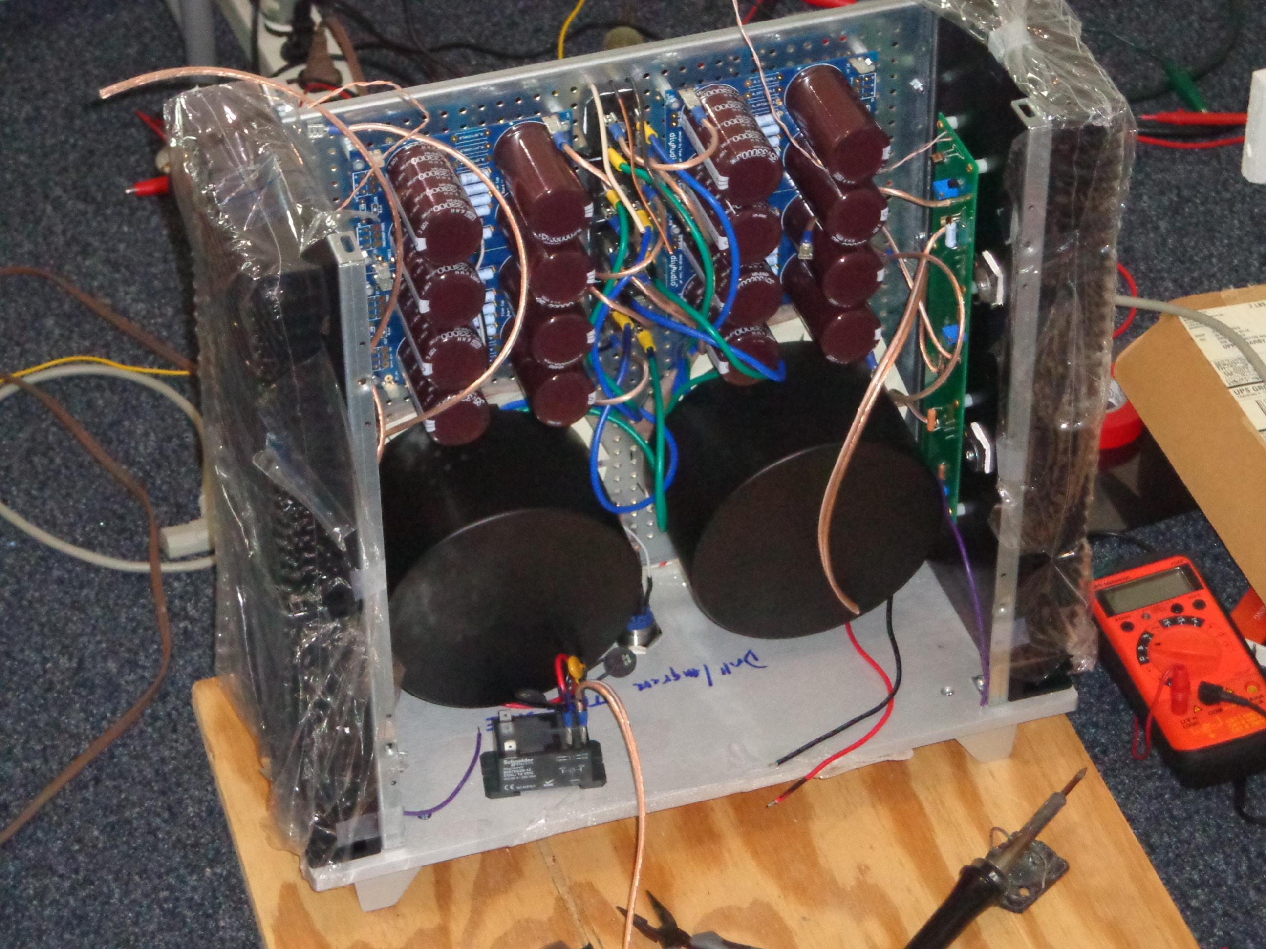

Schubert----(and Vince). Nice job on the amp.The supply looks like it will be rock solid.Is that a 4u or 5u case?

4u. Not very hot at all with 1.2A bias.
