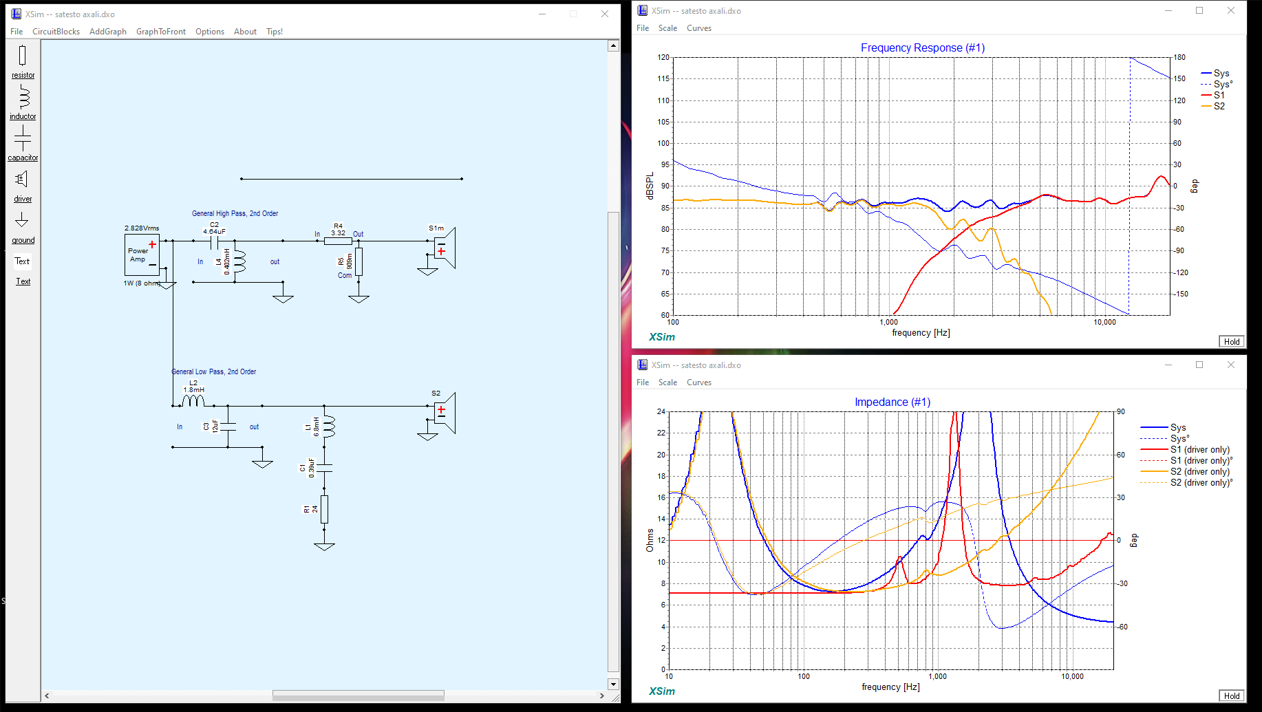

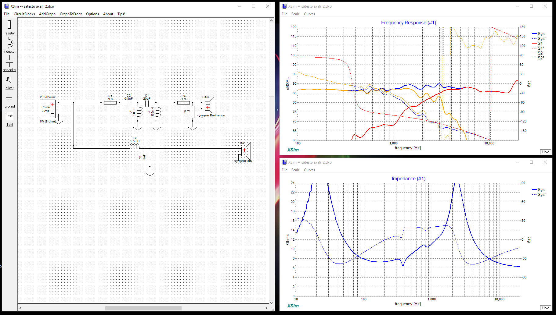

Hello guys,
Sorry for the late post! I didn’t have much time to go back to my build. After a lot of research, I’ve watched several videos about crossover design and have become more or less familiar with the graphs.
I’ve also made some changes to my plan: I decided to go with a different woofer to improve low bass performance since I don’t have the budget for a separate subwoofer right now.
For my 2-way speaker, I’ll be using my own compression driver (ASD:1001B) and the Dayton Audio RS270P-8A 10" Reference Paper Woofer.
If you have any tips for optimizing the crossover or improving bass in a 2-way design, please share your thoughts! Thanks in advance! please see attached file and give me suggestions what i am doing wrong? regards
