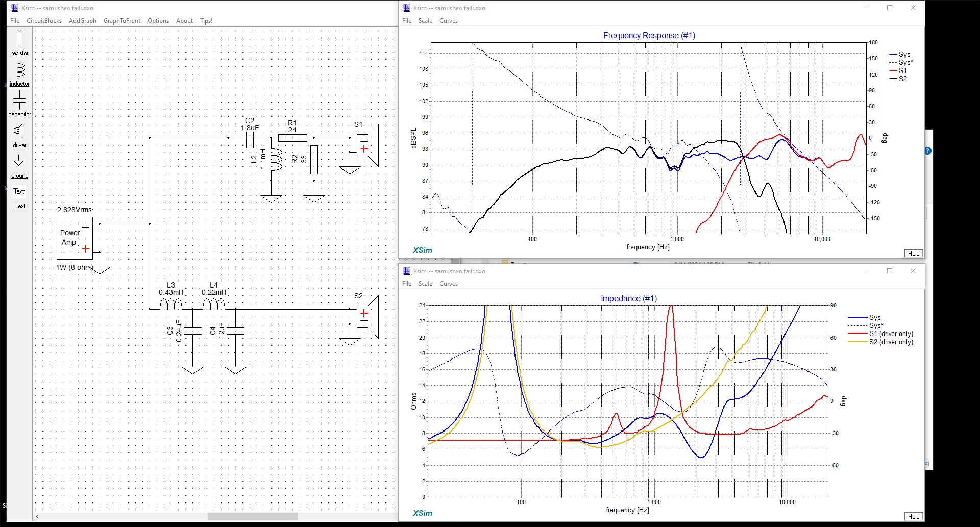

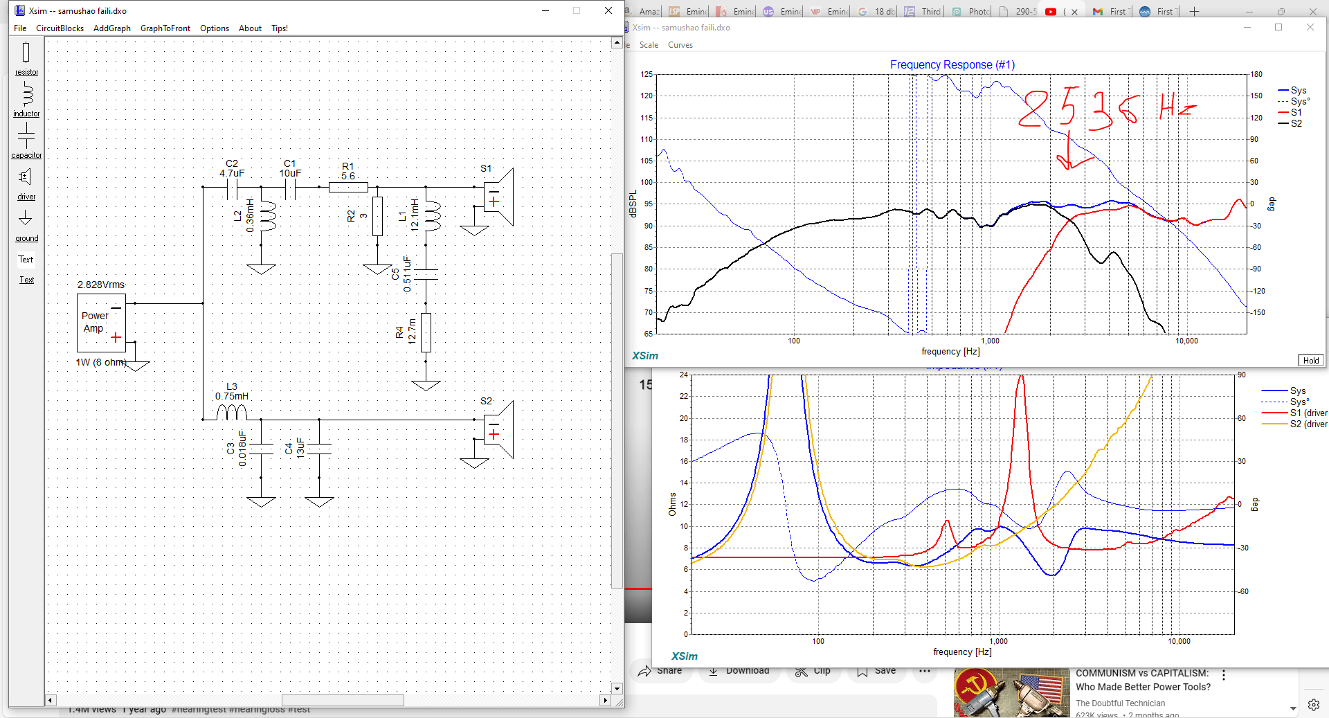

The blue line that corresponds to the magnitude response appears at different frequencies in your crossover's simulation results. You may have got the frequency limits wrong. If so, you will need to redo the digitization process.View attachment 1343919
you mean this graph? i have traced blue line and placed it in XSim. should i trace red wire? sorry for my English i am from Georgia
Also, you do need to trace the red line, as it includes the phase response information that is required to ensure that the simulations are accurate. Both the magnitude and phase response of the driver's impedance is needed.

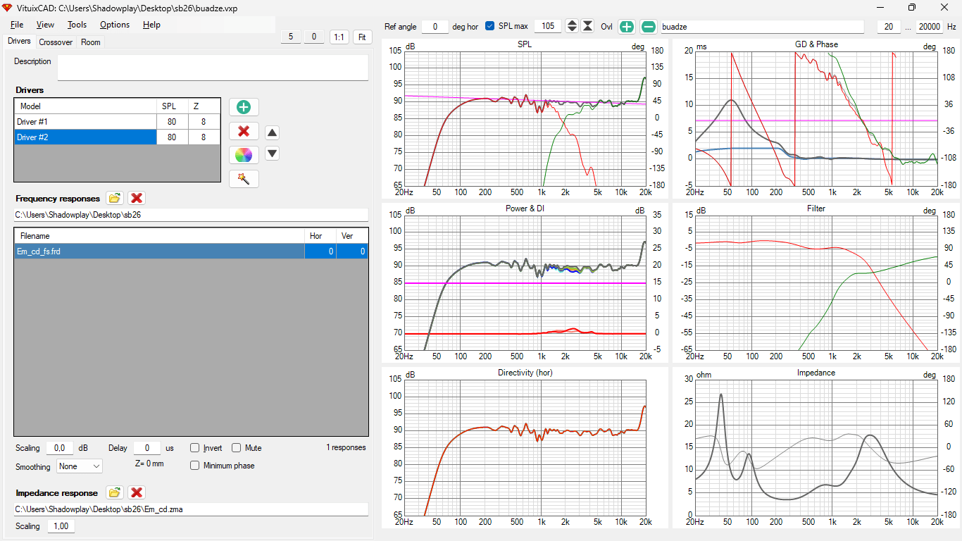

This is just an attempt with traced FR/Z, so it is what it is, a starting point. I used this woofer by FaitalProOkay, my budget is as small as possible like 150$ per speaker set just speakers and crossover (without box) i want to go with 2-way speaker, i want satisfying bass ( i am looking forward building separate subwoofer) i will run this speaker with AV receiver maybe 8-ohm load. (100-130 watt per channel)
https://www.axiomedia.it/it/midwoofer/10/10fe200-mid-woofer-10-faitalpro-ferrite-8ohm.html
Cabinet is a closed box of 50L stuffed and baffle is 40x60cm.
The voltage divider looks strange, odd values, really 2 Ohm parallel to the CD?
The simulation looks good though.

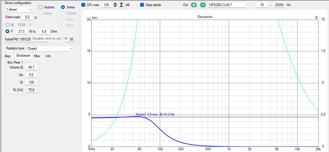

E: just had a look into the datasheet, with just 2 mm Xmax (12mm winding-8mm pole plate) /2 and sealed it won't make much bass.
E2: That seems to be a guitar speaker

Yes, the CD is 105 dB at 3kHz and besides the R in parallel damps the resonance of the ZR curve: anyway, the impedance curve at high frequency looks fine.

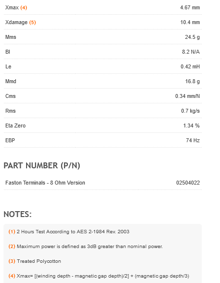

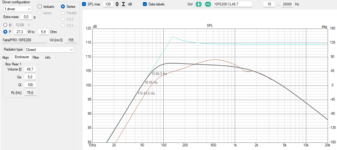

The Xmax of the 10FE200 is 4,67mm and with 27W you have 108 db at Xmax. Plenty enough for domestic use.
I know that bass extension is not that much (F3 at 68Hz), but the OP said he want to build a sub so I didn't care about it.

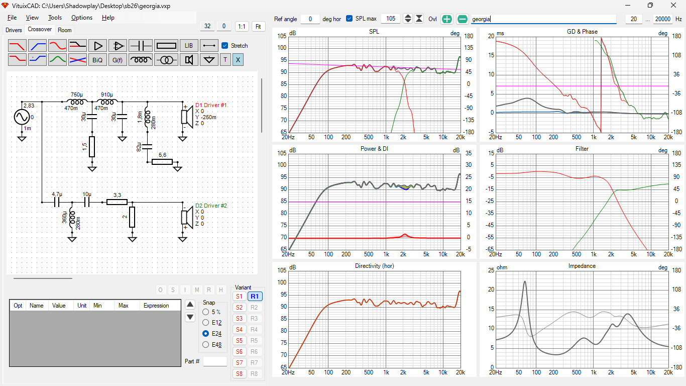

Thank you very much for your hard work <3 if i build this will it sound like it should? i have one question it is related to CD at the and it is hi dip in 17K region will i hear this, or no? Also, i have experimented with 8-inch midrange driver as you recommended but still i can`t crate flat response as you did with your build @shadowplay62
i used
i used
Dayton Audio MB820-8 8" Professional High Power Midbass Driver 8 Ohm but i don`t know what's the problem? i made crossover at 2800 Hz

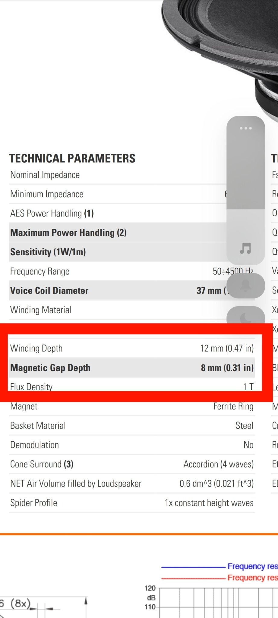

The mathematical Xmax is calculated
Xmax= [(winding depth - magnetic gap depth)/2]
--> X-max
Both values from the datasheet:
(12mm - 8mm) / 2 = 2mm
That's not very satisfying, it's as loud as a Teufel Boomster BT speaker.
@ICG
FaitalPro website reports this, see note #4. All I know is that the manufacturer has a good reputation.
Their drivers are great but that makes the data on the Xmax not correct, no matter if they add more than the actual Xmax on top of the mathematical result. They should just stop the marketing lies. That's the same as on the tiny PC speakers with "300W PMPO" .
Thats geometric Xmax, assuming no magnetic field is present outside the gap, which isnt the case in the real world.
I have updated the project with the DA woofer.Thank you very much for your hard work <3 if i build this will it sound like it should? i have one question it is related to CD at the and it is hi dip in 17K region will i hear this, or no? Also, i have experimented with 8-inch midrange driver as you recommended but still i can`t crate flat response as you did with your build @shadowplay62
i used
- The cabinet is a 20L bass reflex, tuned at 69Hz (vent D=8 / L=9,6cm).
- Baffle is 24x44cm and the woofer centre is at 20cm from the bottom of the baffle. The distance W-T is 22cm.
- All the FR are manipulated with the Diffraction tool to simulate the response on baffle.
I also attached the frd/zma and the VituixCad2 project files I used.
Remember that this is just a simulation and, besides, the horn used in the datasheet of the compression driver posted above is likely different from what you have/will buy. So, if you have the possibility, make your own set of measurements.
