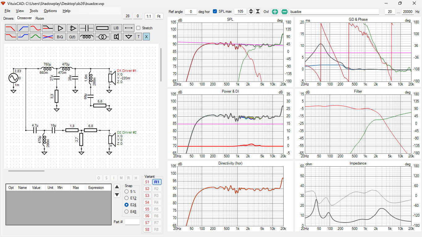

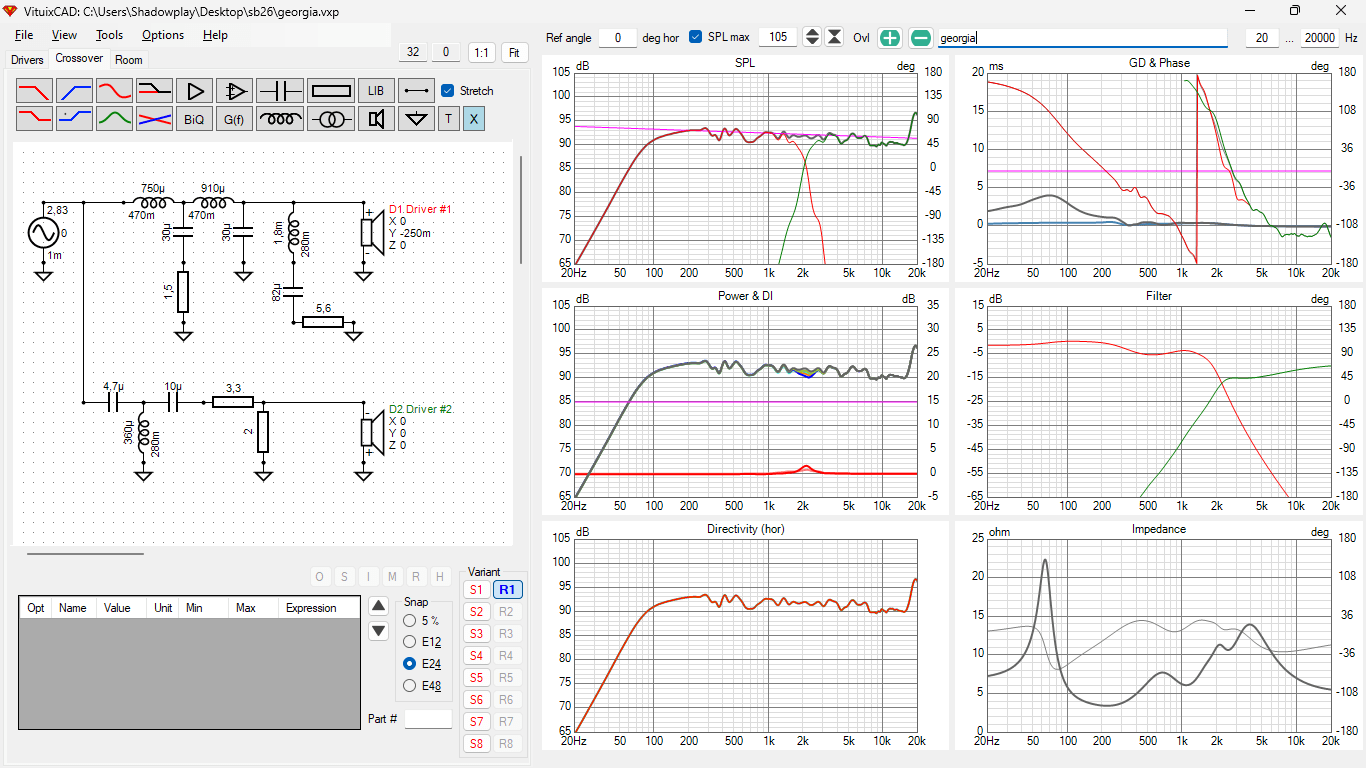

I have updated the project with the DA woofer.
- The cabinet is a 20L bass reflex, tuned at 69Hz (vent D=8 / L=9,6cm).
- Baffle is 24x44cm and the woofer centre is at 20cm from the bottom of the baffle. The distance W-T is 22cm.
- All the FR are manipulated with the Diffraction tool to simulate the response on baffle.

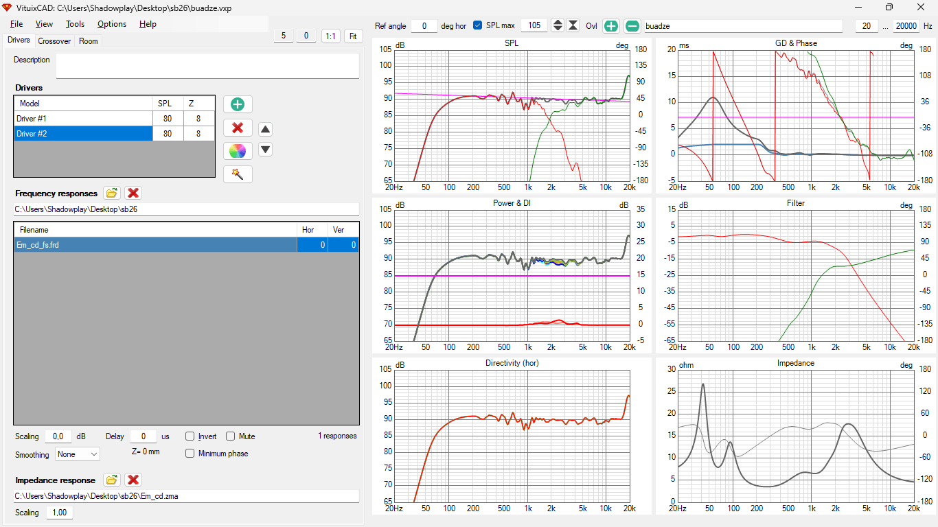

Where can i download attached frd/zma files for VituixCad2 project?I have updated the project with the DA woofer.

I also attached the frd/zma and the VituixCad2 project files I used.
He probably forgot to attach it or to zip/rar the file and the forum didn't accept the files.

Sorry, I forgot to attach the zip file. Here it is.Where can i download attached frd/zma files for VituixCad2 project?
I do not know if I can simulate that baffle in Diffraction tool, especially with 38 °C outside.Uhm, I've overlooked that. He wants his speaker to be close to this:
The forum does accept .frd and .zma files, also .dxo Xsim save files and .txt that Vituixcad uses for data files.He probably forgot to attach it or to zip/rar the file and the forum didn't accept the files.
Xsim does save the data files packed in to the .dxo save file, but I think Vituixcad needs them bundled from separate files.

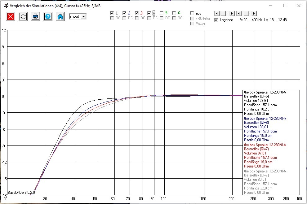

You are right though. It's a matter of compromise. So let's see if the compromise is on a different spot. If we'd use a 12", then the compromise is definitely the high xo frequency, respective the dispersion below 2k. So, what would we get instead?
The driver I had in mind is the the box speaker 12-280/8 A. Cheap, good Xmax, goes deep.
Again, the downside is the dispersion and it needs a large enclosure. With the planned large, wide baffle, the enclosure size can be quite good concealed. I'd say, that looks like it could be a fit for 'satisfying bass' but I have to say, I personally would definitely not like the dispersion with the high xo frequency the CD needs. But then again, it's not for me, maybe that's a compromise that's acceptable for him.
HiFi Selbstbau (German) got the driver tested thoroughly.

Well, the idea is, if you like the Thomann driver, you could at some time in the future replace the CDs with some which can take a lower crossover frequency. The "the box speaker 12-280/8 A" are from Elder Audio, they build most of the Thomann cone drivers (not sure about the tweeters). Check at first if the speaker enclosure won't get too big.

Faital Woofer (I attached the frd/zma files if you wanna modify the project).
Dayton woofer

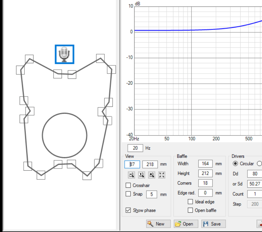

You can... 18 point should do it. Here's a crude mockup (not to scale or any accuracy).Sorry, I forgot to attach the zip file. Here it is.
However, I think that baffle has more of an aesthetic effect than likely a significant one on baffle diffraction
