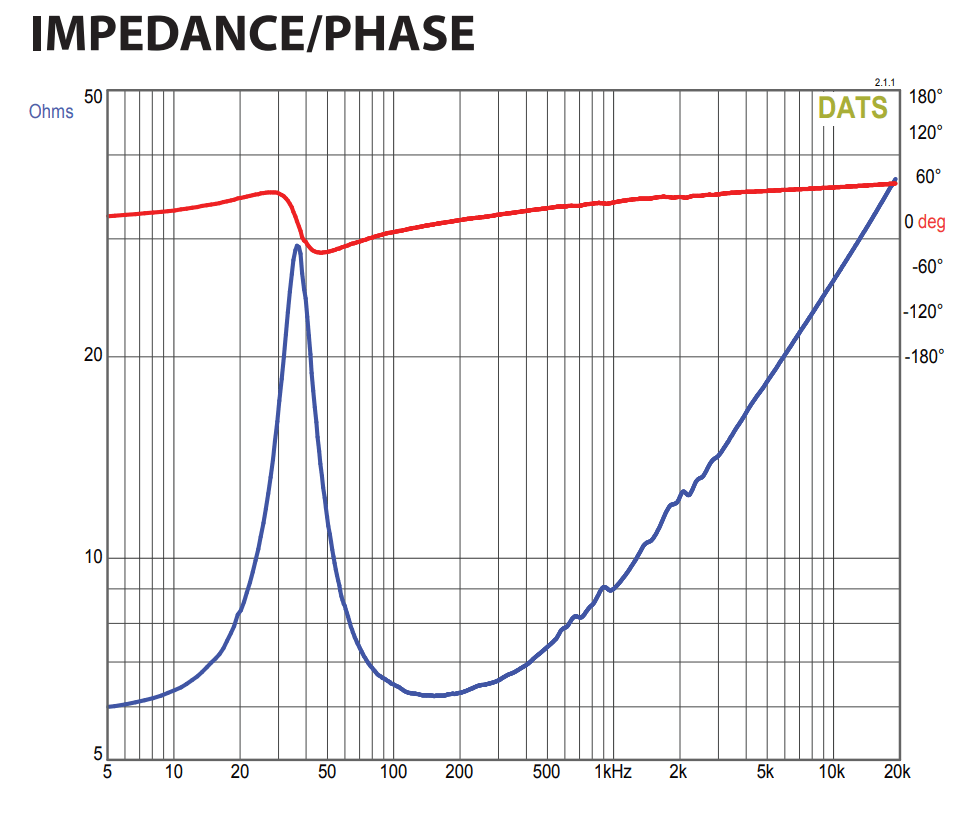

Impedance graph :
i like frequency response but when i look at impedance graph i think i should do better what you think?

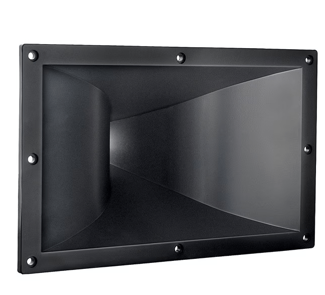

What horn are you using? Do you have angle measurements? The peak at 5k will be quite dominant in my experience.
It's often better to use a voltage divider instead of just a series resistor because you can adjust the level of the horn without shifting the crossover frequency
Your speaker will sound bright / bass weak.

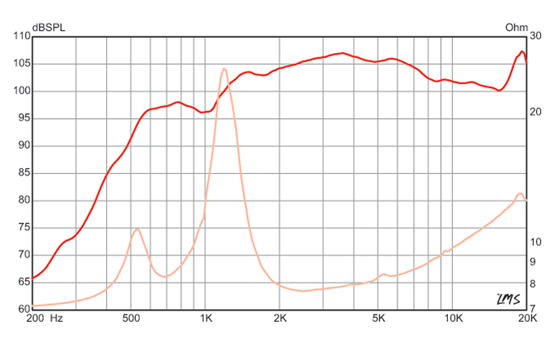

The horn can be used and loads properly, however, the 12" GRS bass will be a lot narrower at 1,5kHz xo frequency. The Eminence CD got its resonance at this frequency which leads to a strong decay ridge there as well. Aside from that, the impedance peaks mounted on the horn makes it much more complicated to build a fitting crossover and you can't use the traced impedance because at the horn it will be nothing like in the data sheet.
Further: The driver is recommend to xo at 2,5kHz with 18dB. The Eminence ASD 1001B will perform really bad at 1,5kHz, will have high distortion and show very slow decay down there. Or in other words, you need a different CD or a different woofer or a mid driver, making it a 3-way.
Same goes for the GRS woofer, the impedance graph suggests that it got several resonances above 600Hz, which means it's likely not a good midrange and instead just a good use as a woofer.
E: You have to measure the impedance and response of the woofer and CD with the horn, complete mounted in the enclosure and time align the measurements because of the CD offset because of the horn, otherwise neither the fr, impedance nor the phase will be correct - and can't be used for any xo simulation.

I would not use the driver for anything below 2k.
You have evidence of this?
I've seen the measurements in a German forum. The pictures are not online anymore though. It had a long decay delay ridge at the fs and one at 5kHz (much tamer but with k3/k5 peak) and several at the top. The biggest peak was at 18k with a high decay ridge. Not a good driver, no matter how you look at it, even if you ignore the decay.
My experience is not to use the small CDs at their fs at all.
E: that's from the datasheet, alone the high impedance peak shows a high Q resonance
Surely that's normal for fs, and if you extend the response lower then it goes somewhere else..
And where would you 'extend it lower' to? I wanted to know if you'd really want to contribute to the speaker but you didn't even look at the datasheet. Where's the mistake, mh? You just wanted to say I'm wrong but didn't invest any effort. Look at the datasheet, it's in there.
