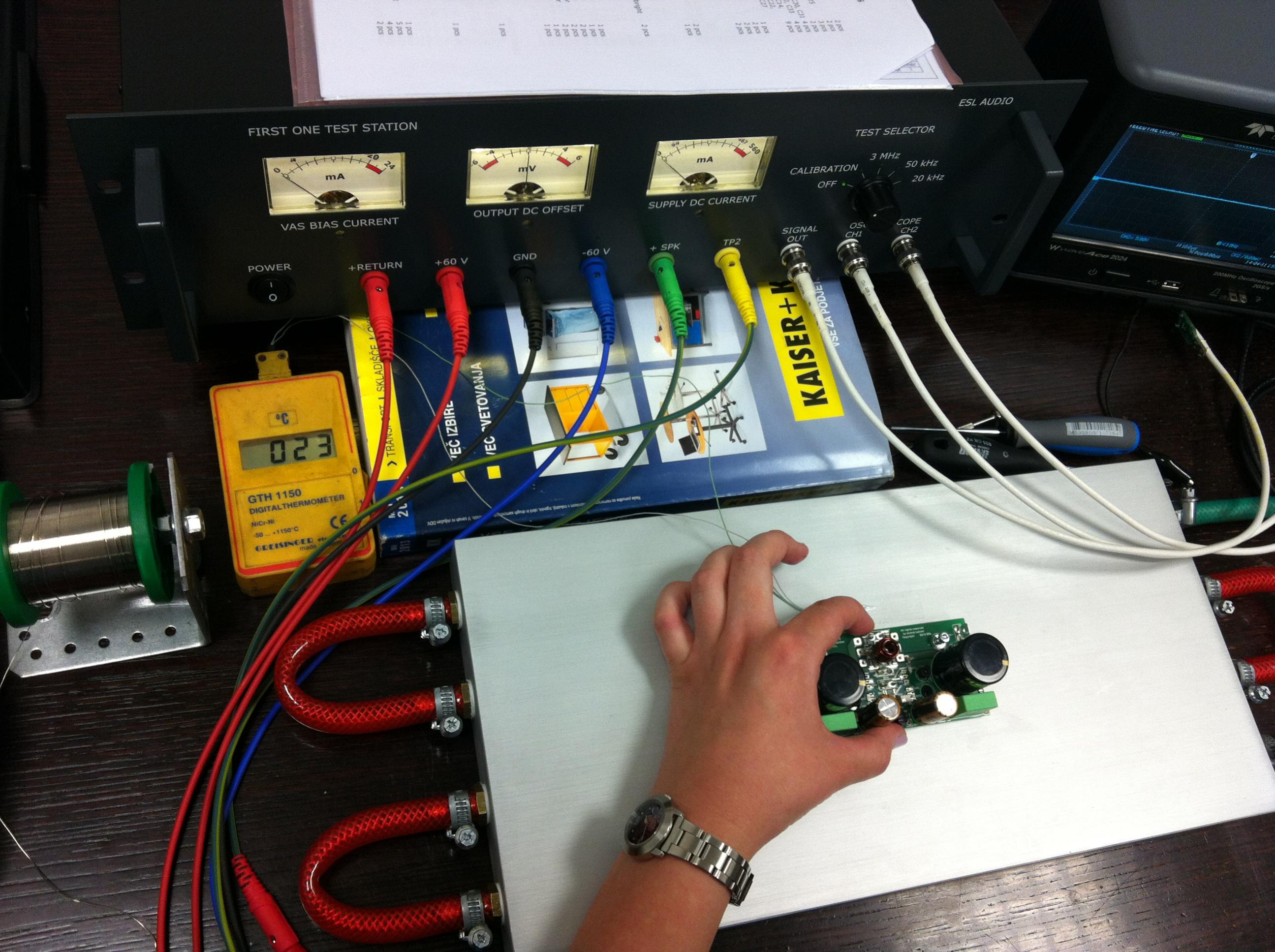

You personally calibrated the fabrication machinery for the PCB and SMT production?
LOL
THE POWER OF INSIDER DIY!
Personaly made measuring station for fast calibration and test procedure. 🙂
WOW

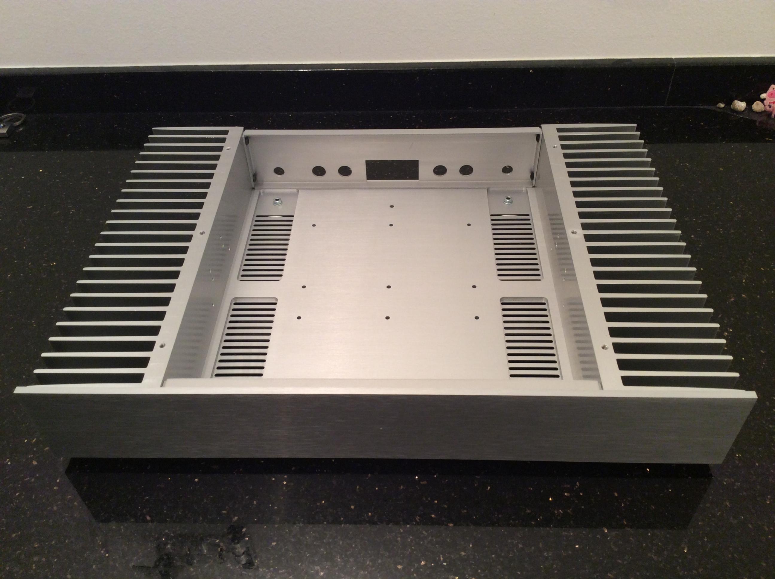

That's a nice chassis! I was thinking your chassis would be some rolled case fabricator order online!
hahaha
WOW
It's not cheap but it's also not expensive considering it's tier one all the way!
First cases will be received by GB members soon. Their comments will be most relevant, stay tuned.
Regards, L.C. :cheers:
