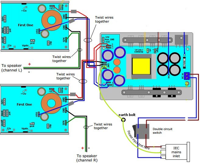

Edgar, look very carefuly and compare it to stereo connection sch from First One user manual and you will see they are 100% the same.
As we experimented with GND wiring for best results, my advice is to remove all three green wires and connect only main GND pin from SMPS to earth bolt. 😉
OK! New drawing. If I remove all 3 green wires from my first drawing, I also remove chassis earthing (chassis not connected to mains gnd). Is this your advice?
Hypex seems to recommend to disconnect mains earth, and employ double insulated construction techniques. Coldamp does not recommend this..
In this present drawing chassis earthing is OK since earth bolt is connected to chassis and to mains earth. Also SMPS GND is connected to this bolt.
Still dual mono, one SMPS per channel, is better sounding solution.
