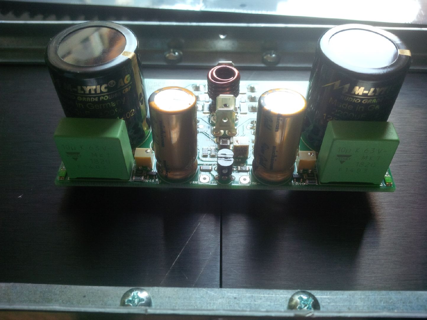

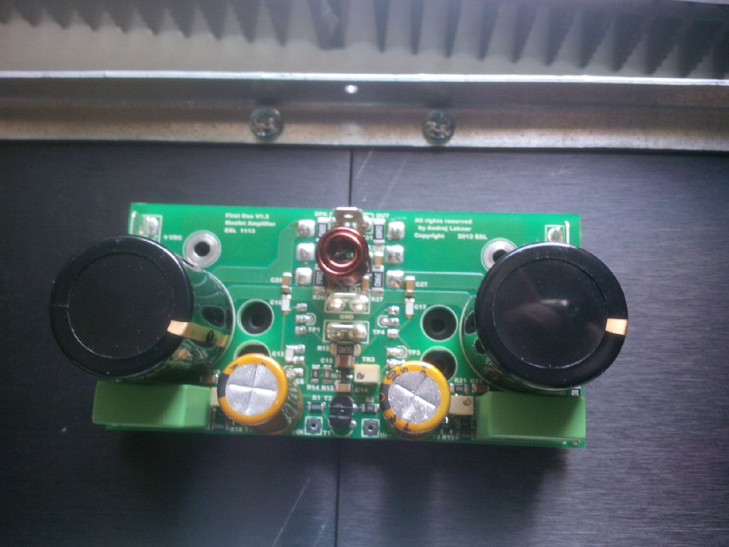

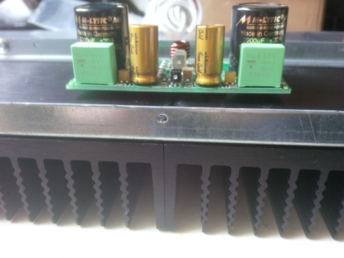

Hi LC,
I suppose the heatsink being split into 2 equal pieces for each channel won´t create any thermal issues, as I assume FO must be somehow similar to VSSA (i.e no thermal compensation necessary). The two parts are joined so they share the same temperature for sure in the central area.
Can you please confirm this is correct? Have you any other objection against this kind of mounting? The case I picked up has this construction detail that I noticed only today 😱
Thanks!

The most important is mechanical rigidity, so no movement between two heatsinks is possible. No thermal issue estimated for your solution. 😉
Otherwise, mount module exactly in the centre, aligned in a way that the output transistors will be located at the bottom of the common heatsink, so all the heat generated would be located as low as possible. Use thin TO-264 mica & grease. :up:
