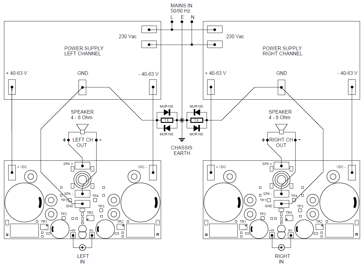

First One Stereo Connection
Hi GB members
Improved schematic for stereo connection in a single chassis. GND potential of each channel is lifted from chassis earth potential, meaning connection is done via 1 k resistor and anti-parallel diodes. In this way Earth potential interference currents are isolated from GND potential. At the same time GND potential of each channel also isolated in between.
This stereo connection gives best sonic results.
Hi GB members
