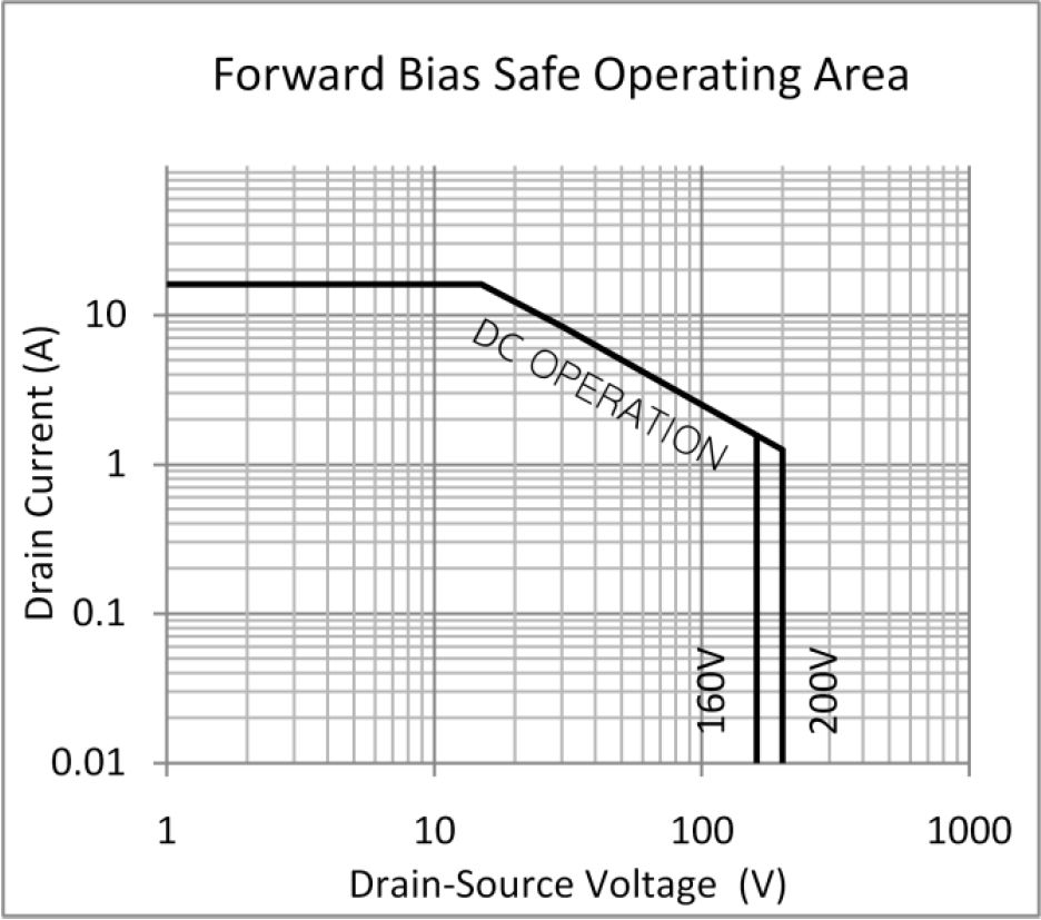

- in bridge mode min 4 Ohm impedance is recommended, meaning 4 Ohm in average if looking impedance curve, so it can also be less than 3 Ohm somewhere in the bass region, but that's OK if the average is still around 4 Ohm. The limit here is the output current which is 16 Amax and if looking to SOAR chart of the outputs, you can see these are very robust semis, at 100 Vdc they still easily sink/source 2,5 A :eek:
- since the modules are calibrated at +/- 63 V, at +/-42 V idle current would be a little bit lower, but still recalibration back to 280 mA (complete module's idle current) can easily be readjusted by trimmer TR3
- definitely LL1540 Lundahl line input transformer
In bridge mode at +/- 42 V PSU voltage you would easily get 500 W/4 Ohm and still be well in a SOAR. :cool:
